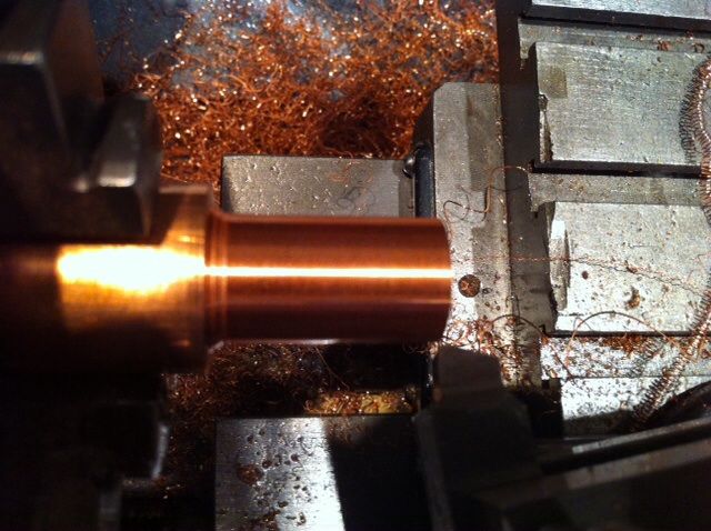

      image.jpgHello all.
      Been turning some copper sleeves today, no problems until I came to turn the last one tonight,
      When I came back to the machine to start the last one, touched the tool on the grinder to restore the edge, same as I have done many times before but the finish is awful, material just tearing away,
      Machine is a myford 7
      thank you for any advice you could offer.

          hi brian,
          tool looks fine for copper but think the side cutting angle should be much less ie negative instead of positive, and less end cutting angle. hope this makes sense.
          ive done a fair bit of machining copper recently.
          cheers,
          julian
          #154136
            Brian,
            I think I'm basically saying the same thing as Julian:
            It looks like you are using only the extreme point of the tool. … If you have literally only "restored the edge" then the basic shape should be right [it worked before]; so I would first try moving the tool a couple of degrees anti-clockwise [as viewed in your photo] … the cutting action needs to be "slicing".
            The other possibility is that the tool is now a few thou' low, and is digging-in a little.

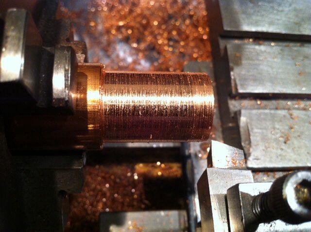

                          After regrindQuick thank you to everyone.
                          Ground the tool as instructed in the link supplied by Michael, did the trick a treat.
                          must have been a lot more heavy handed than I thought.
                          thanks again..

                            Nicely done, Brian
                            That looks good.
