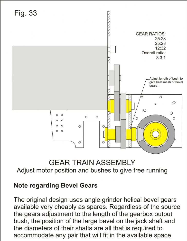

                #361425
                  This is the arrangement I used on my loco, used standard angle grinder gears. Plan to swap a poly vee or toothed belt for the spur gears

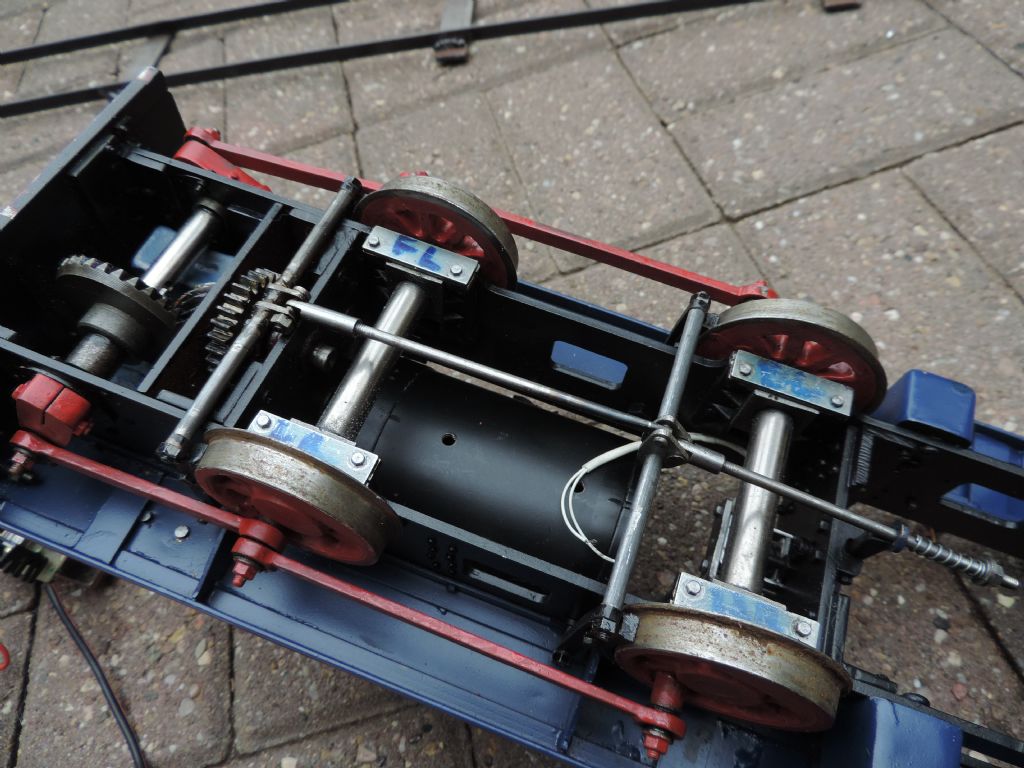

                            Sorry for the delay in replying work, life & the universe got in the way! If you have a look in my album I've upload some photos of how I mounted the motor & gearbox, hopefully they are helpful. Happy to answer any question.
                            Cheers Kerrin
                            #363046
                            Kaleb Peart
                              @kalebpeart30258
                              Hi Kerrin,
                              I noticed in the photo of the underside of your toby locomotive you've got the grinder head mounted straight onto the underside of the chassis. Do you have any problems with tension between the grinder head and that axle?
                              Regards, Kaleb

                                  Kerrin Galvin
                                    @kerringalvin72662
                                    Hi Kaleb,
                                    No problems at all with the setup. I'd have to flip him on his side to check but there may be a half link in the chain to get the spacing correct. I seem to remember spending a bit of time sorting out the distance between the sprockets. A friend worked for a supplier, which is were I got the chain & sprockets, so had the info required to sort out the distance. The springs are reasonably firm so probably not a lot of movement.
                                    Re your other question on frames etc. Tobys frames are mild steel, as are the axel boxes & they ride face to the frames, horns are 12mm key steel from memory & only because its nice & square! Drilled a hole in the frames & put a squirt of oil in ….when I remember!
                                    Just reading Perko7's post & version 2 of the coupling between the motor & angle grinder head is a 3/8 universal joint, I kept the socket end, drove out the pin on the spigot end, modified a 11 mm socket…use the 6 point one….I started out using a 12 point one & it was starting to show signs of wear…& pinned it back in place. Only reason I used 11 mm was I've got a bunch of hex that size. I milled the motor shaft to fit the 3/8 socket end & located a short length on the hex to the grinder head. Lots of km's & no issue!!
                                    Cheers Kerrin
