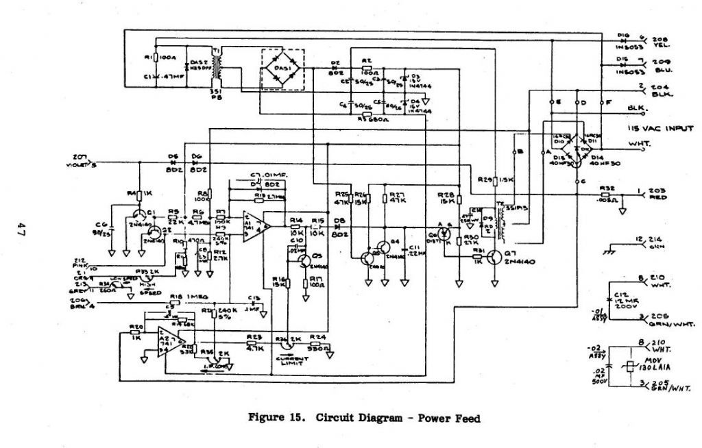

                    Here is a link to a post on another forum that is related to an Erskine power feed. It contains a schematic which should help tracing the problem. You may have to join the forum to view all of the information. If that is the case let me know and I will post the schematic here.

                          Here is the schematic.

                            Do you know what breed of power feed controller that circuit schematic is actually for.
                            Looks to be the official Bridgeport one for the 8F series power feed with the board co-located with the controls in a box fixed to the motor mount. Also found labelled as the 12 wire version via internet searches. Unfortunately I don't have good enough pictures to be sure.
                            It's not a Erskine and I think not the later similar but slightly different version made by Quinton Crane as it has 741 op-amps on the board. The pukka Erskine units are all discrete components. The Quantum has, I think, one 14 or 16 pin IC package on the board which could be a dual op amp but somehow that circuit doesn't quite look right.
                            That said its half a decade since I had the cover off the Quinton Crane unit I had re-furbished as a spare for my Erskine one so memory may be wrong.

                                Pretty much all the Erskine and Quinton Crane power feed controllers use the same output connections via the same multi-tag strip. As mentioned above they are all pretty much the same circuit too.
                                There is an early obscure and rare Erskine variant with a smaller board and different circuit about which I have no information which may use a different output connection set-up.
                                Yours is a standard Erskine variant. I do have set-up information, some test data and a typical circuit, most of the changes between builds are active component type numbers not major functional variations.
                                Confirmed that the diagram from Les is for the American 6F & 8F power-feeds having the board colocated with the motor. My copy of the Hardinge produced Bridgeport Manual M-450, revised August 2005 has full details on that one.
