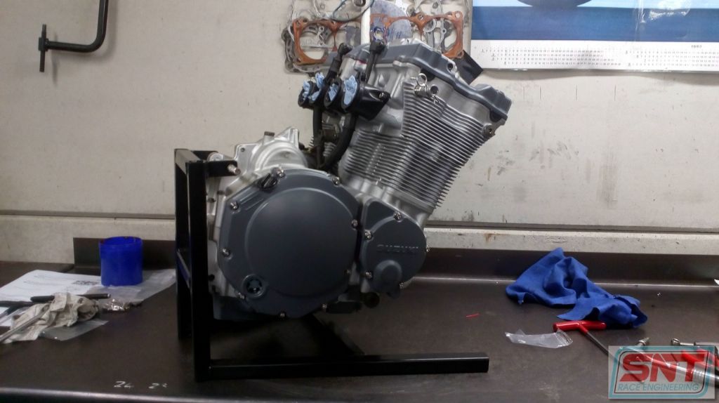

                        At work we have a coating division, We often use powder coat as a primer especially if the final coat is a candy or other exotic finish, in addition powder coats are often applied in two or three stages, primer and finish and them possibly a lacquer coat, I have on many occasions powder coated steel structures (Motorcycle Restoration) that have had corrosion damage, after stripping and blasting we pre heat the frame then apply polyester powder primer, this can then be sanded back to get a smooth surface effectively filling in the corrosion damage, it is then re heated and over coated until I am happy with it, this can easily be flatted off and then painted over with paint, I suppose you could describe polyester as plastic, but if your inclined to be pedantic you could describe most paints (polyurethanes, etc etc) and in fact most clothing as plastic.
                        As an aside some so called powder coats are no longer in powder form they are liquid and applied with a spray gun and then baked at up to 400 deg C on our race engines we use Xylan coating this stuff is amazing applied wet as a super thin coat, the only we we have found to remove it effectively is with glass bead and its a nightmare taking ages, this is a fluorocarbon base product, Another plastic.. ha-ha
                        Shaun
                        Xylan coating both Silver and Grey
                        I've uploaded some more pics of this engine competing in last Years Classic TT to my Misc album just in case anyone is interested.

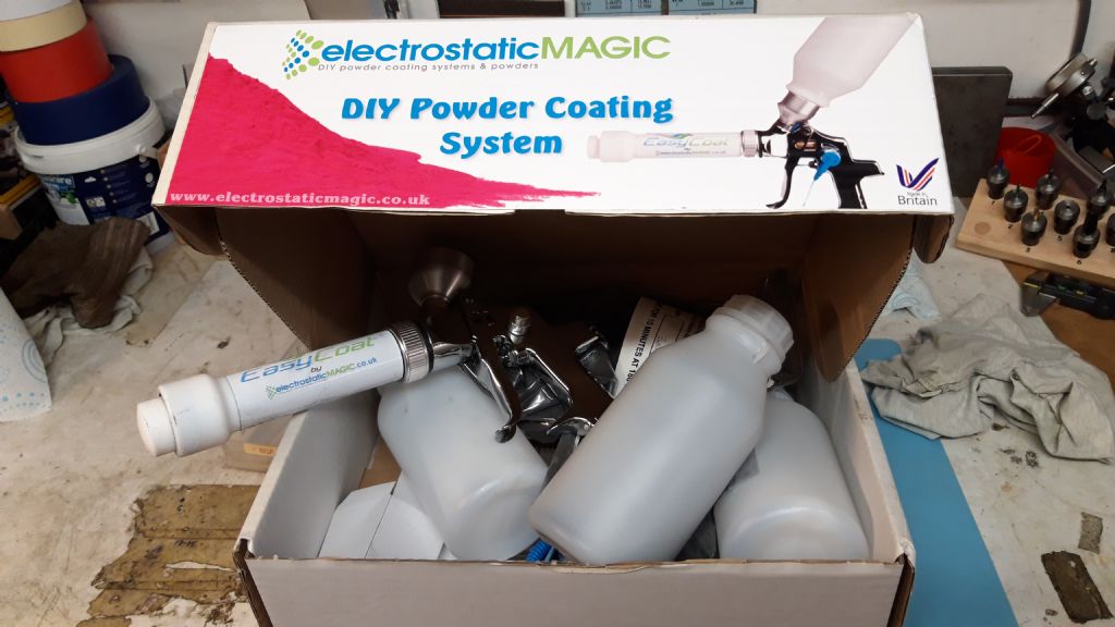

                                  Hi John have a look at electrostatic magic made in the UK. I have got the start up set and it works very well, although I have only used it on motorbike foot pegs and small things, the results are great!
                                  Bought it a few years ago at Stafford classic bike show for around £150 ish

                                      hi Ian, thanks for the picture of your powder coat gun. How does that work? There doesn't appear to be any electrostatic generator.
                                      #456279
                                      Ian Johnson 1
                                        @ianjohnson1
                                        It doesn't need an electrostatic generator. It simply has an earth lead from the gun which clips to the part you are coating. Really easy and simple low cost method which works very well.
