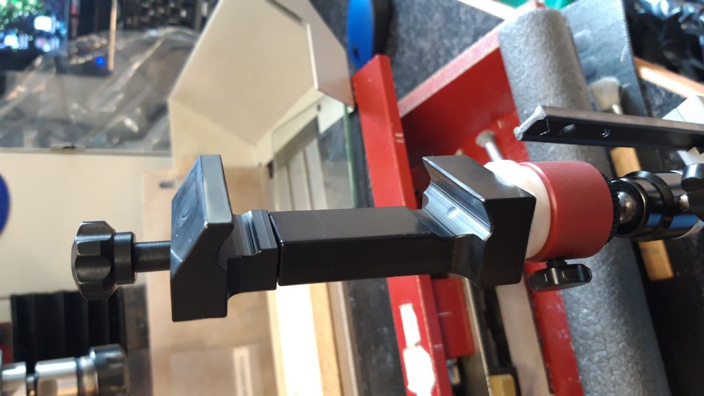

                                      Here's a mobile phone holder with a fluted screw I made a few months ago. It's made from black Acetal, and flame polished. Although some machining marks are visible because of the hand ground ball cutter, I think it looks pretty good, and it feels nice to hold, it's weird how Acetal feels different after flame polishing.
                                      Oh and like Sam says don't breath in the fumes if it starts burning, it's probably Phosgene or something equally horrid!

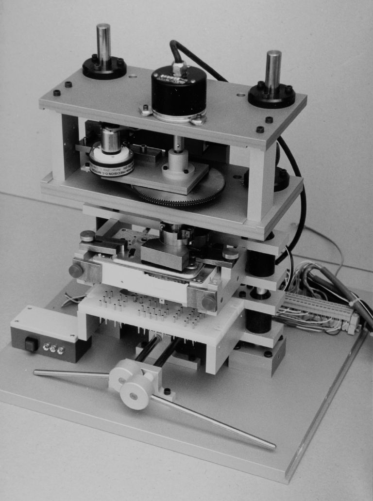

                                          I didn't have this picture loaded in my albums, hence this delayed follow up.
                                          This device for testing rotary switches features various uses of polyacetal. Black for bearings, and I think there's a slab of white with all those 'spikes' poking through. It may however have been high density polyethylene but I can't remember.
                                          Sam
