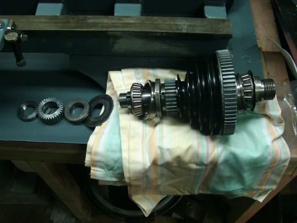

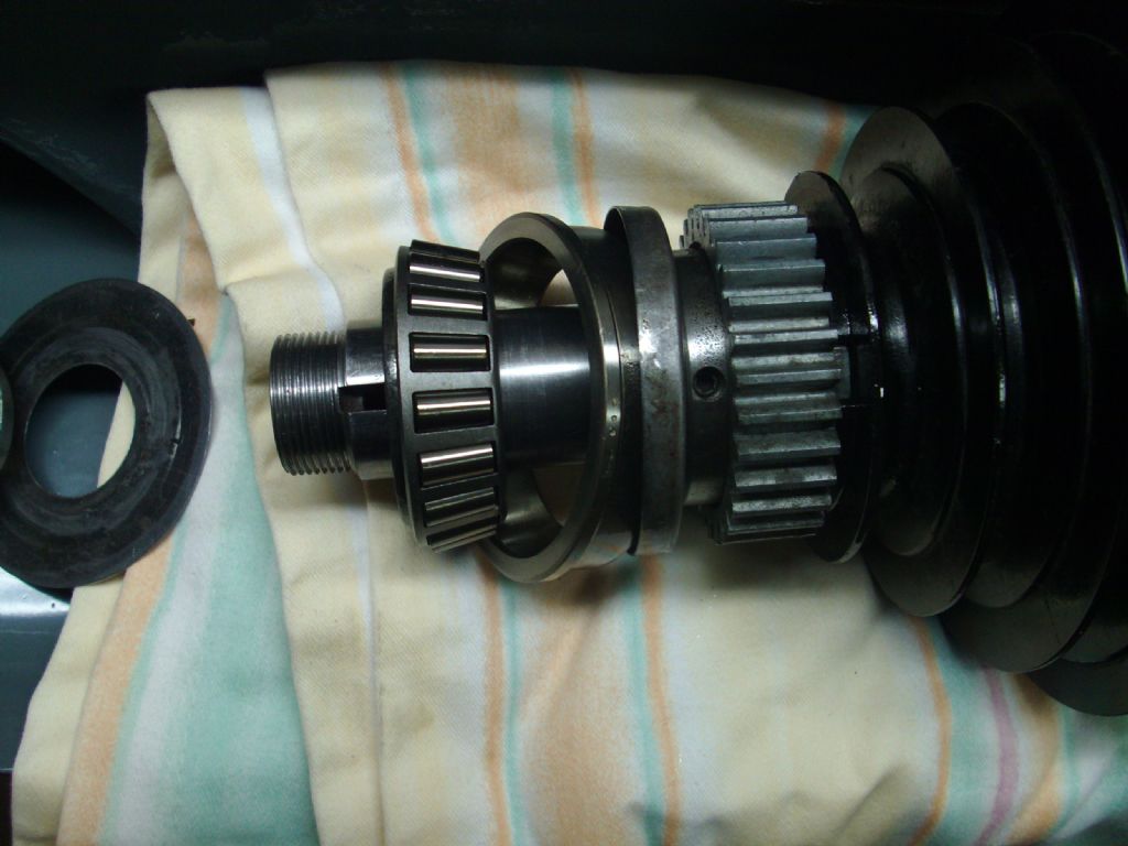

                                    I will try get photo later but the bearing does not go up-to the shoulder, the outer race is held ridged in housing and the inner race pushed into the rollers taking up movement & pre-loading by collar being tightened (not much more that hand tight) and locked using grub screw onto threads.
                                    If I end up using lock tight I will have to keep rotating the spindle every now and then so as to not cause bearing damage (not sure how often one should rotate) not beyond the realms of automatically doing this on time clock.
                                    Need to look at cost to get shaft electroplated and ground to correct tolerance then I can decide which way to go.
                                    Photos added:-
                                    Edited By Ian L2 on 04/01/2015 11:31:47

                                        One more observation. From your photos you seem to have flat disks instead of the part 10A-3 dust cover shown in the parts list and fitted to my Atlas. It may be that this was a design change for your split casting version of the headstock but it's worth checking.
                                        Russell.
