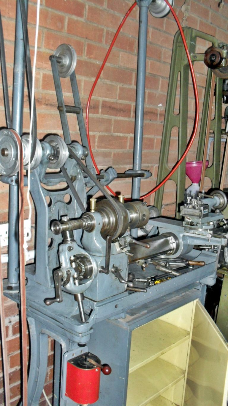

            pittler.jpgI ended up offering £900, only after getting it home and sorting through the boxes did I find that nothing important was actually missing, I've just received the 1941 ME hardback book, it has five sections on the Pittler by the same author. I also want the 1940 issues so looking out for them

              Classy machine, Vic
              … Well saved !!

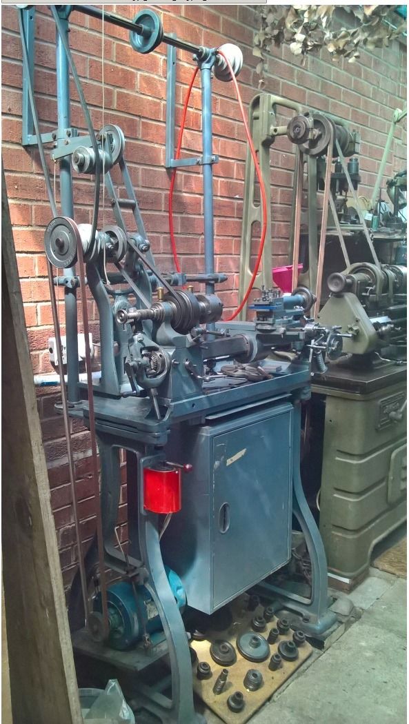

                          r/hand side of latheHere are some more photo's. I have assembled the countershaft to include the belt tensioner, it works via a fulcrum and suspended weight. The uprights fit directly onto special round brackets on the back of the lathe casting as an original optional extra provided with the lathe
                          The crossbar at the top has a keyway and the pulley is free to slide along in line with the topslide whilst the shaft is turning when using certain accessories.
                          In the ME issues of 1941 there are a series of 5 articles on the Pittler, all by George Gentry. The 1940 issues have the first parts of the series which i've not got yet.

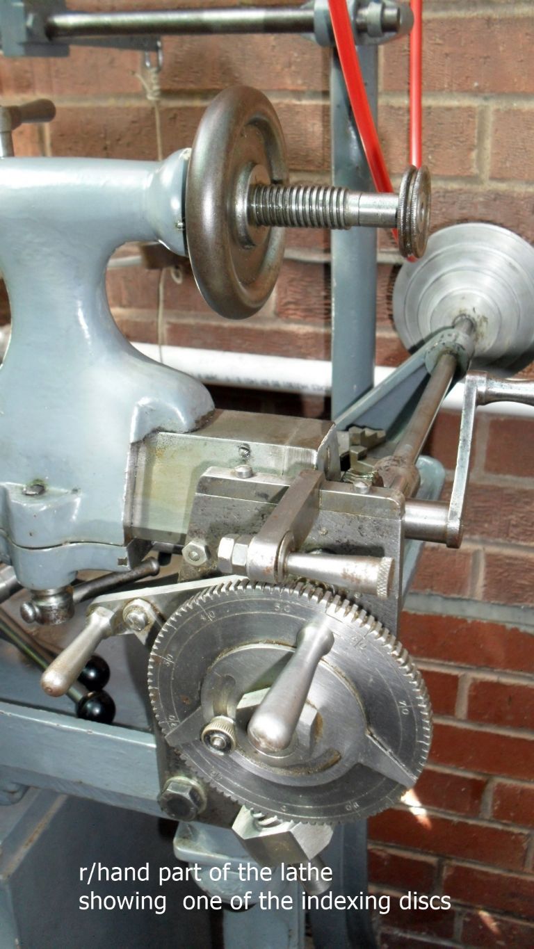

                          The other photo shows the/hand part of the lathe, a countershaft on a lower bracket connects with the indexing device. Another indexing device fits at the headstock end and has four discs with it. These are called 'knife edge' types, there are 100 cuts around the rim, later types had 4 sets of holes & a plunger.
                          Mr Gentry describes in great detail of how the indexing works although I'm still somewhat confused. He describes this shaft is for auto power feed and another means to drive the lead screw for minute indexing. This lathe appears to have the extra long traverse of the cross slide he refers to in one of the pages
