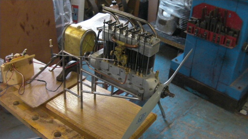

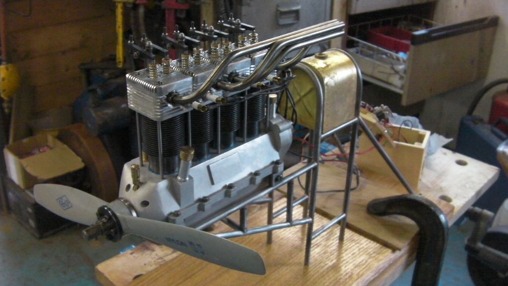

                    Martin Cottrell
                      @martincottrell21329
                      Hi Dougie, that's a lovely looking engine. What model is it and are plans available?
                      Regards Martin.
                      #315009
                      Dougie Swan
                        @dougieswan43463
                        Thanks Martin
                        It's mostly my own design based on the cirrus engine, it is made from bar stock
                        I dont have any drawings other than a couple of general arrangements that I made up just to get a rough idea of how it would look, the cylinder head is pretty much a copy of another model of the cirrus
                        Dougie
