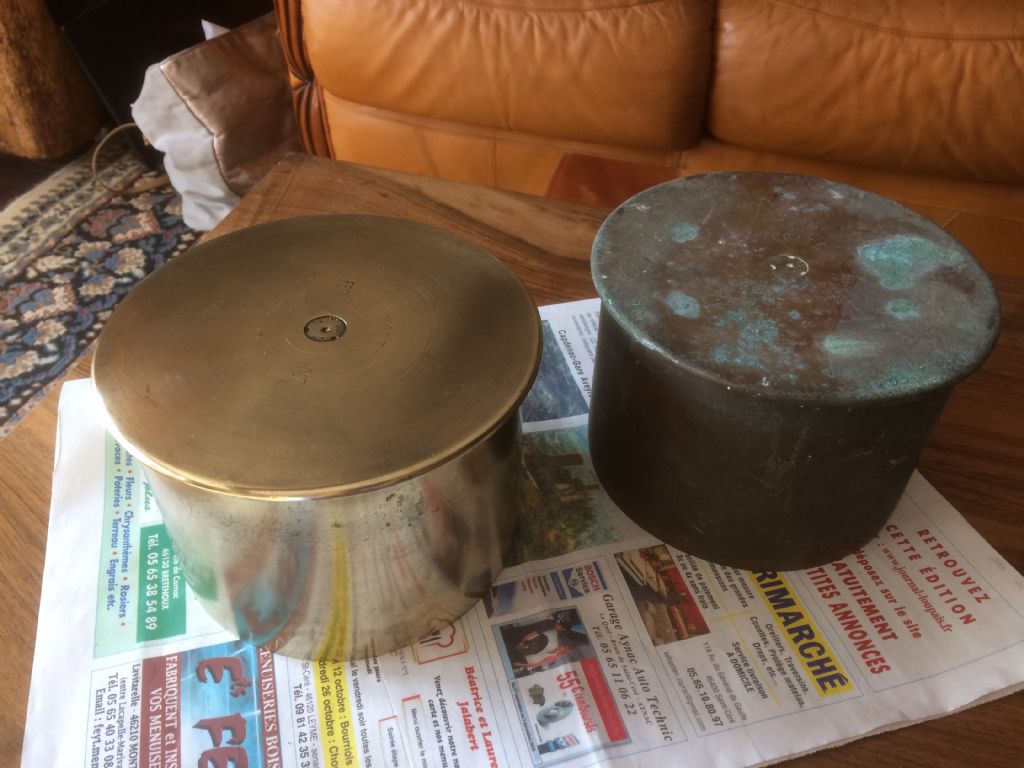

      I have a pair of very dirty WW1 German (fired) 150mm mortar cartridges. If I use sulphuric acid pickle which has been used for pickling copper boilers, it will leave a pink deposit behind. Should I use another type of pickle which would not leave the copper deposit.
      I am expecting to buff them up using buffing soap etc after pickle.

          Fresh acid would be my choice… Sulphuric or citric..whatever comes your way..
          #374107
          nigel jones 5
            @nigeljones5
            Even new sulphuric acid does this, it removes the zinc leaving the copper in place and is a real pain to get back to brass. I never put brass in any pickle. Some say use citric acid but it has ecactly the same effect, just takes longer. Wipe them down with a solvent then clean them up with a fillament abraisive wheel, then a scotchbrite wheel then polishing mop and paste – i use this method several times a week so I know it works.

                                        OK, so its some time since you all gave me your recommendations. I went with 1/2 cup of vinegar, teaspoon of salt and flour to stiffen into a paste. I have to admit, my wife was both sceptical and wondered as to where all this was leading. Anyway, a couple of coats of the paste, leaving each on for about 1/2 an hour and taking off with a fine ScotchBrite. A final polish with some Duraglit (other brands are available) and a final buffing up. The picture tells the story. (150mm german WW1 Howitzer 'cartridge).
                                        Thanks for your help ladies and Gents

                                          Has the process damaged the headstamps? I know Duraglit can, and I'd expect Scotchbrite could too – though it might be possible to minimise both.
                                          #375554
                                          Speedy Builder5
                                            @speedybuilder5
                                            No, they look good, even see the turning marks on the end of the cartridge.
