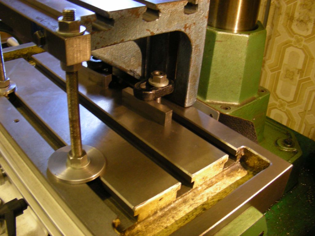

                                    My experience of overhauling my shaper may be of interest to the select band of users; I see from MEW 246 pp 14 and 15 that Mike Haughton is also one.
                                    I was not surprised to find my machine needed attention in a number of areas – not quite Perfecto!

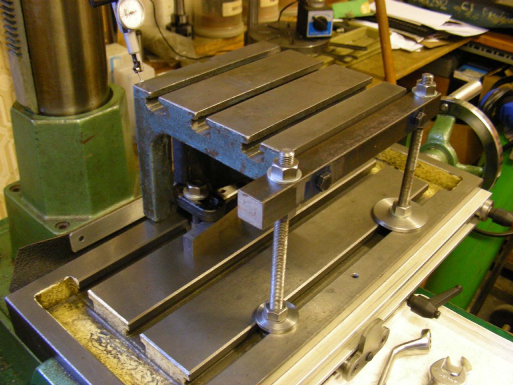

                                    I noticed straightaway that the tee slots in the table needed re-machining but could not immediately see how to mount the table on my small mill. The photos show how I eventually solved this problem:
                                    This necessitated first milling the front and bottom edges of the table parallel and tapping two holes in the front edge, alterations which I thought were acceptable.

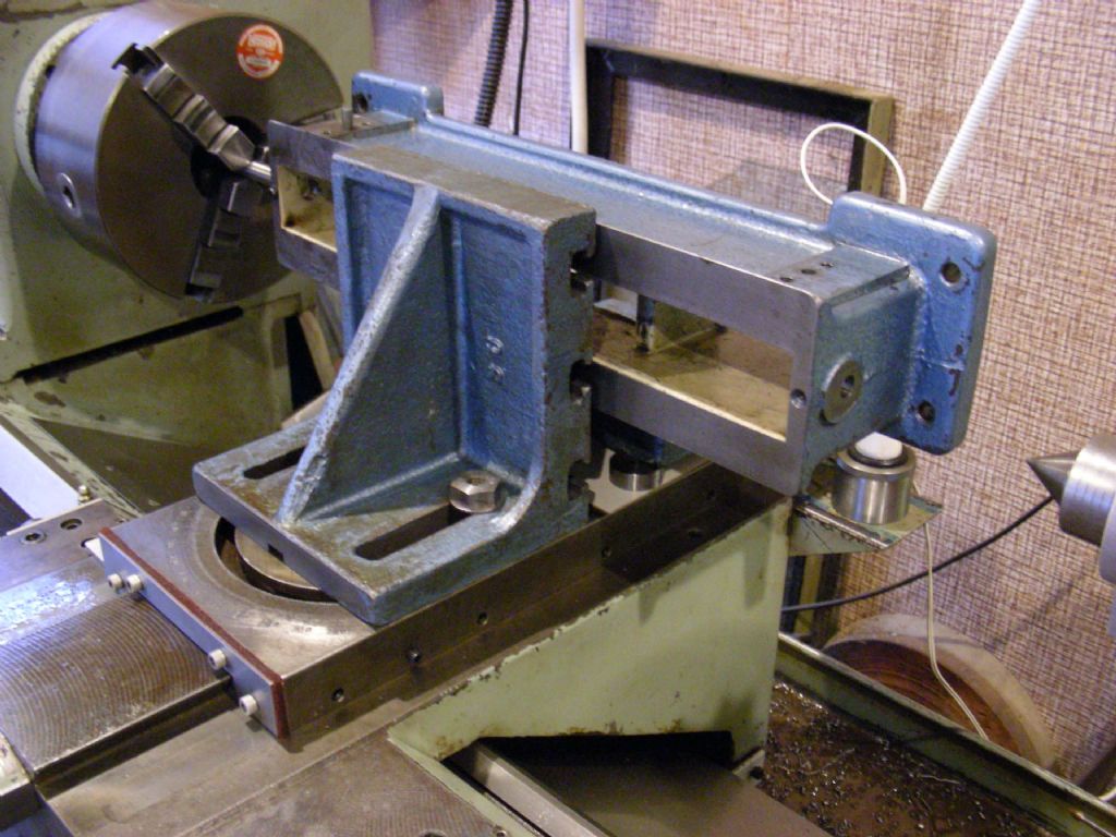

                                    The other major problem was that the saddle became progressively stiffer as it was moved by the handwheel from right to left; dismantling and measuring revealed that the leadscrew bearings were badly out of alignment. This was cured by installing an eccentric bush at the left end as shown:
                                    Here is how the bed was set up on the cross slide of the lathe for opening out the hole for the bush and machining the necessary facing:
                                    The machine's own table came in handy for this job.

                                            I am curious as to why you did not use the shaper to recut the T-slots?

                                              I'm a complete novice in this area, having done no more than take a few trial cuts before starting to overhaul the machine. However, the tee slots on the Perfecto are at right angles to the ram travel which seemed to make your suggestion difficult (although it may yet be possible for the machine to true up its own table).
                                              My understanding is that "proper" shapers like the Alba are in a different category but I will certainly bear in mind your point about walking. Like most amateurs I have a restricted work space and I had hoped to make the shaper semi-portable. The Perfecto is essentially a bench machine although I know some users have contrived stands.
