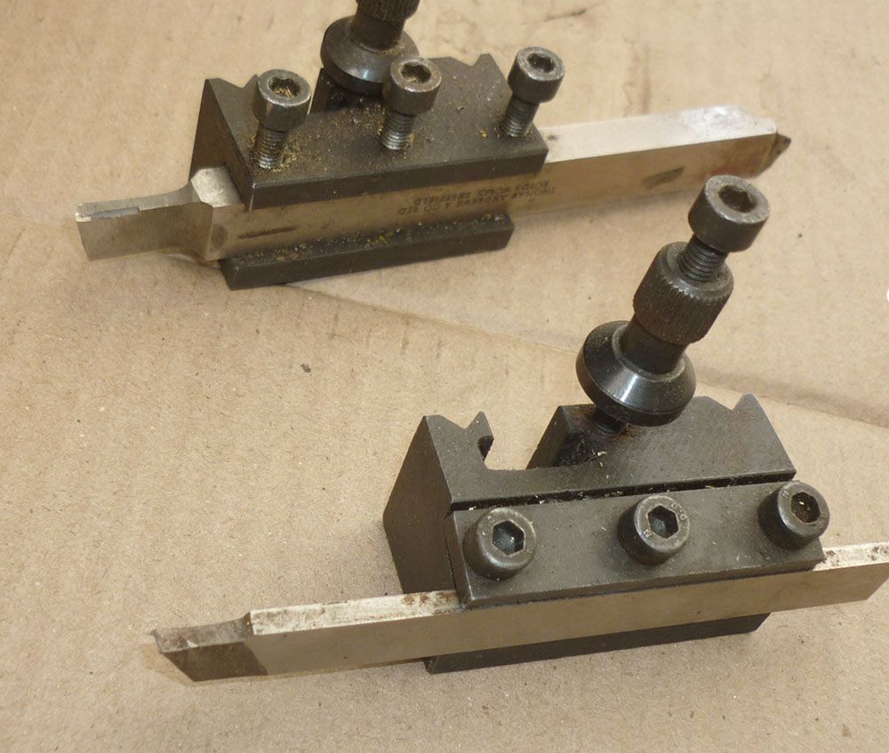

                                            mark smith 20
                                              @marksmith20
                                              p1280398.jpgI just use the emco tool holder that came with my lathe and it appears to work fine with just HSS bits ,i did grind a left hand one from a HSS bar and that works fine. p1280396.jpg
                                              Edited By mark smith 20 on 17/04/2016 11:15:38
