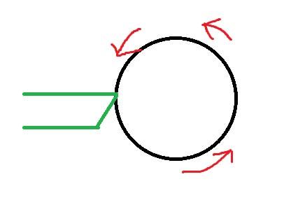

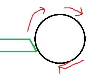

      Hello Everyone
      I’ve been trying to get the hang of parting using my Warco WM180 lathe. I have been following a procedure much like the below picture and when the diameter of the part is small everything works very well. The cut is smooth, the lathe is quiet, and the tool advances nicely. However, once I increase the diameter of the part (to say 1.5 inches) things become very different. The noise (chatter?) and vibration increases dramatically, and to the level that I think If I persisted it sounds like something very bad would happen.
      Today I’ve been reading a post on a different forum that suggested inverting the parting tool and reversing the lathe. However, as you can see from my second diagram I can’t get this to work using my existing tooling. This is because I can’t change the height of the tool post, and so the parting tool cutting edge won’t be central and won’t make contact with the part before the blunt edge of the parting tool meets the closest edge of the part.
      My question is have I misunderstood things or do I just need to get a different parting tool ? (and if so does anybody know where I can source it?)

          Most people that use the inverted method have a separate tool post behind the spindle so the lathe runs in the same direction.
          Search "rear toolpost" its been done to death on just about every forum.

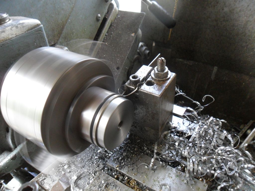

                    The most common problem with parting off is being wimpy on the feedrate. You need to keep the tool cutting or it will chatter. On my centre lathe I use a 3mm insert system in a 4 way toolpost. It seems to help locking the top slide and the saddle. Flood coolant is advantageous, except for brass and cast iron. I normally run at about half turning speed, so for 2" EN1A the spindle speed would be 260rpm. I use an absolute minimum feedrate of 4 thou per rev and, more controversially, I use power cross feed. I've never bothered investigating rear toolposts, as I don't have a problem with the front one. Here's a picture of parting off 3" OD cast iron; I can't remember if I was running at 180 or 260rpm:
                    Parting Front Wheel Hub
                    On the repetition lathe, which has the tooling behind the work so normal operation is with the spindle running clockwise, I use HSS parting tools. Depending on the material, spindle speed is 500 or 1000rpm. There is no power cross feed so I just pull on the lever hard to get a good rate of feed. Seems to work fine. The key is to keep the cut going.
                    Regards,
                    Andrew

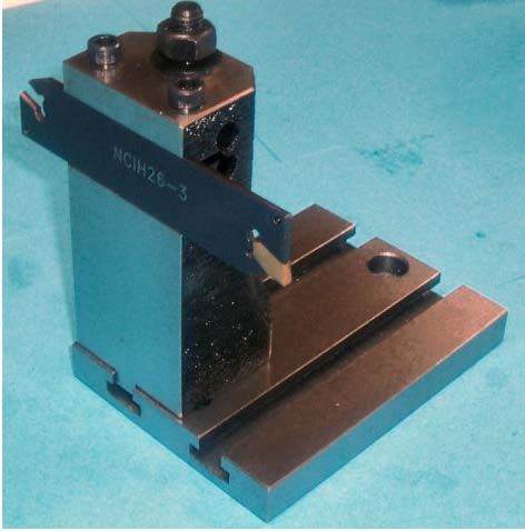

                          Breva
                            @breva
                            David,
                            The above type of rear parting tool holder works well. The one in the pic. is from RDG (no connection),around £60, but there are many types out there. The blade takes GTN3 inserts. These curl the chip in from both sides so making it narrower than the groove being cut and helps prevent jams. Parting becomes a routine operation with this kind of setup. (And you'll notice a big saving on washing powderwink)
                            Use plenty cutting oil. Keep both sides of the cut wet. Provided you have plenty oil in the cut, I have found no difficulty in stopping the cut by backing off very slightly, if there is a need to brush away swarf that might build up and get drawn back into the cut. Spindle speeds up to about 250 rpms work ok, with a steady continuous feed into the cut. I prefer around 100rpm. As you come nearer the centre ease off the feed pressure BUT do keep it cutting, not rubbing.
                            Also, be positive when beginning the cut. It can sometimes take a good pressure to get the cutter to "bite".
                            Take any slop there might be out of gib strips and if you can, lock the apron down on the bed while parting off.
                            Make very sure the cutting tip is sharp and has no tiny chips out of it.

                                Ian L2
                                  @ianl2
                                  Posted by David Cambridge on 02/01/2015 18:20:31:
                                  Hello Everyone
                                  David.
                                  Would the second illustration above not try to undo the chuck with disastrous results?
                                  #174519
                                    Not on the OP's WM180 as its a flange mount chucksmiley
                                    #174520
