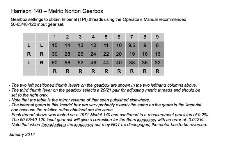

These imperial tables for a 140 were all on the Harrison Yahoo forum site, I am sure I put some there, but it is all shut down now by the recent Yahoo policy. There is a new Harrison site and I will have to see if the files of reference data have been transferred across.
I will post my simple .jpg of information here in the hope that it is readable. If not message me with your email and I will copy it to you.
