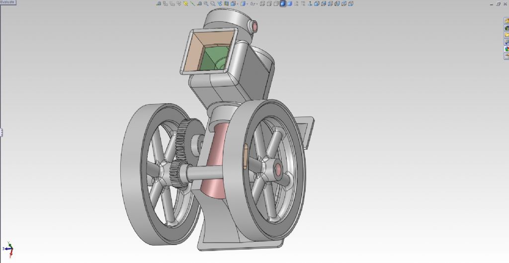

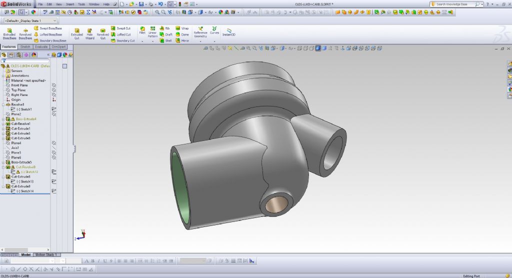

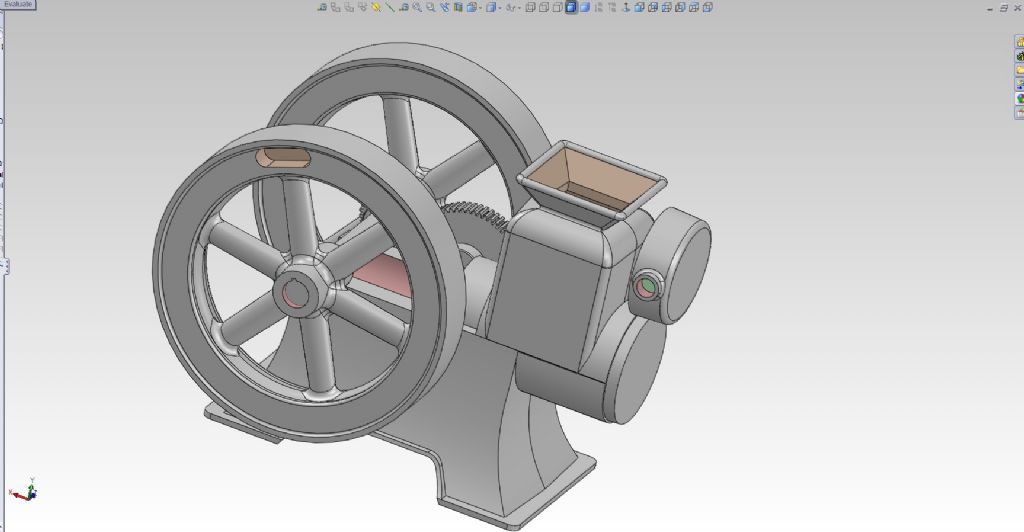

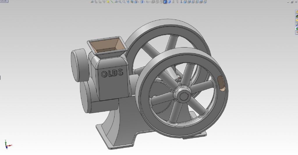

      I ran across some photos of a scale model of an Olds Type "R" hit and miss engine, perhaps 1.5 or 1.75 hp, and I really like the looks of this engine.
      It is produced in 1/2 scale (subject to castings availability).
      At one time it was available as a 1/2 scale casting kit labled "Briesch Olds".
      In researching this engine, apparently the patterns changed hands a few times in auction, and it appears that the 1/2 scale Olds patterns have been either lost or set aside under a lot of dust in someone's garage or barn.
      I inquired around as to whether there were any 1/2 scale Briesch Olds casting kits or drawings available, and apparently those who have the drawings don't want to share them for copyright reasons, which I fully understand and appreciate.
      So what is a person to do who would like to make a 1/2 scale Olds Type "R"?
      Well, all it takes is a few good photos, and one can recreate many of the old engines. This particular engine is not too terribly complicated, luckily, and so I am on a Monty-Python-type holy quest to recreate the Olds Type "R" in 3D modeling, print patterns, and then make iron castings at a scale slightly larger than 1/2 scale (so that the flywheel diameter is an even 10&quot.
      Perhaps a good exercise in 3D modeling.
      All of the 3D models for this engine have been created with the appropriate draft angle, which makes them a bit more tedious and difficult to handle, but well worth it in the end whey one is trying to pull the patterns from the sand.
      So far I am pleased with the progress I have made, working on and off over about 1 week's time.
      Here are a few screen captures of the 3D models.

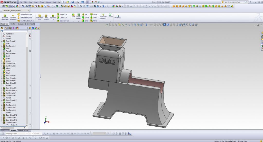

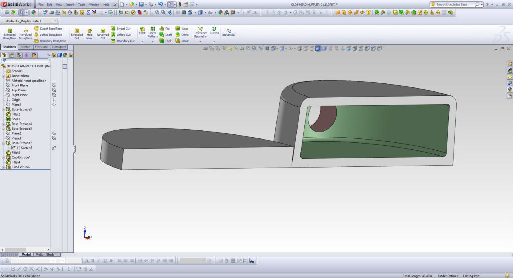

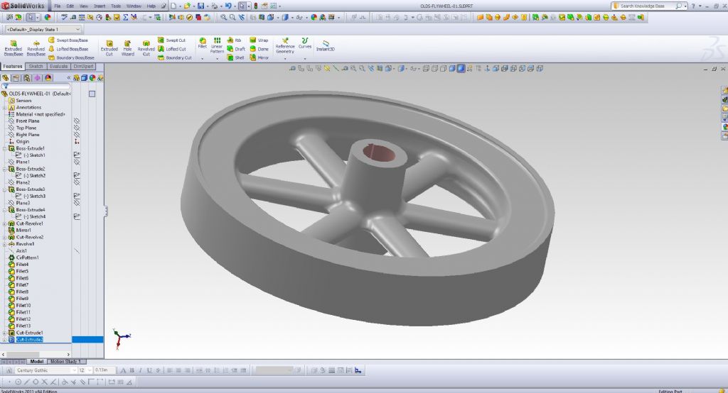

          Screencaps.

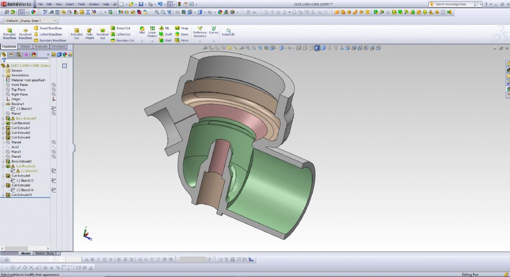

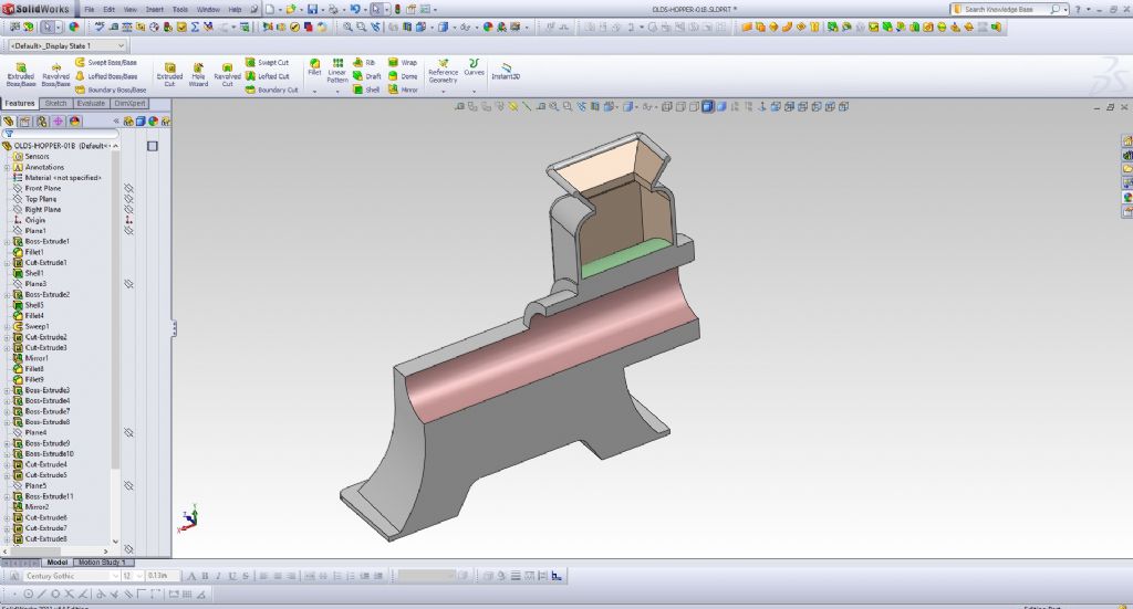

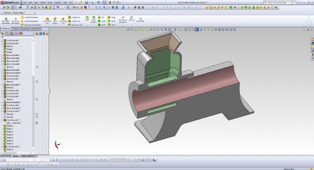

            I did get the water jacket added.

              Brilliant bit of reverse engineering. Watching with interest.
              It's a shame some people get hung up on copyright issues on ancient drawings that are out of print and most likely nobody cares about. Single copies for non-commercial personal research use are most often perfectly legit but there is no convincing some people of that. Subsequently, a lot of old stuff is being lost without trace, as you say gathering dust under someone's bench, to be thrown on the tip by his family when he drops off the twig.
              So keep up the good work reverse engineering and preserving a piece of engineering history!

                    Well a sensible scale has never stopped the Loco boysdevil
                    Plus many a scale for stationary engines was chosen so you could get the flywheel into the gap of a Myford and that is why there are so many of the old designs with flywheels all around about 9" diameter

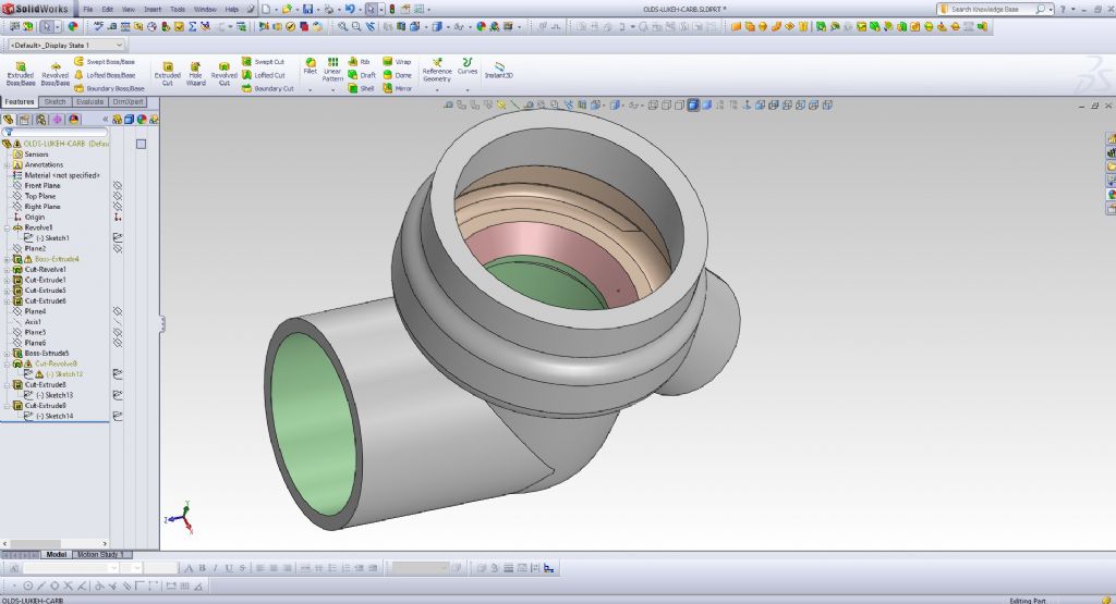

                      I have not built any internal combustion engines, but I would think making the Cylinder as a Sleeve or a Flanged Sleeve would make the casting of the Main Body much easier. If the Flange were on the Head side it could be sandwiched between the Head and Body with the Head Bolts. Leakage at the opposite end could be dealt with some sort of Sealant.
                      This removes the interrupted cut as you try to machine the Cylinder Feature as shown. You will need to add clearance for the Crank Shaft at bottom dead center.

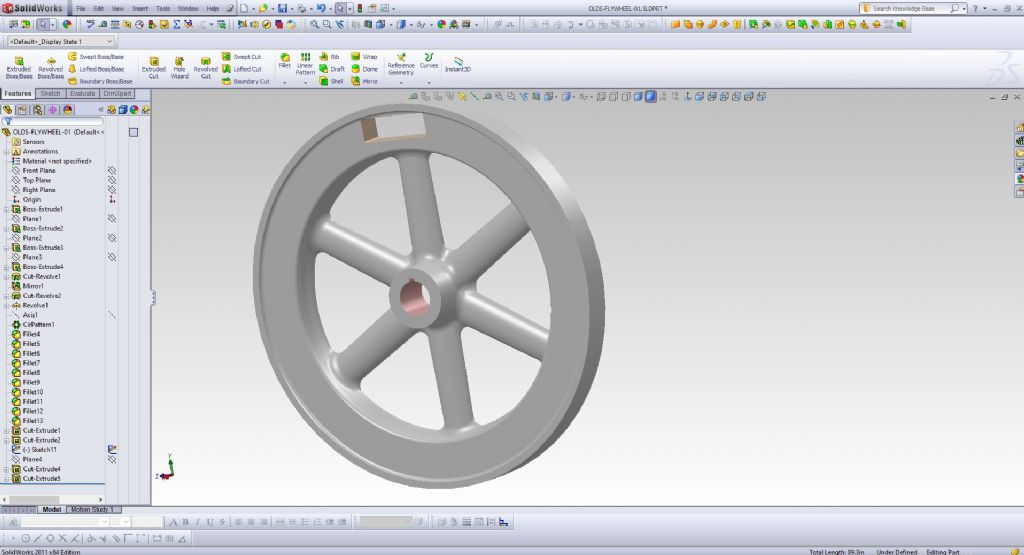

                        The difference between the 1/2 scale 9" flywheels and 10" flywheels is pretty slight, and so I really don't have a problem with casting it with 9" flywheels.
                        At a glance, I doubt many would be able to distinguish between 9" and 10" flywheels.
                        One reason I go for the slightly larger size engines/odd scales is that they are much more forgiving to machine, and also my eyesight is not good these days, and it is easier to see and machine larger parts.
                        I would not really want to create two sets of 2D drawings, so I guess will go with 1/2 scale for the Olds.
                        Generally speaking though, I don't adhere to a typical scale factor, but often let the piston diameter drive the overall engine dimensions. I have standardized on a 2" bore minimum for most engine designs I am working on.
                        #595206
                        PatJ
                          @patj87806
                          I think JasonB posted a photo a while back of machining an engine bore using a boring bar in the lathe, with the engine crankcase bolted to the carriage.
                          That is how I would machine the bore.
                          The Detroit Diesels used sleeves very successfuly in their engines, and it makes rebuilding a snap, but my philosophy is to cast it as it was originally cast, for historic accuracy.
                          Many casting kits depart from historically accuracy, in order to simplify the design, but I can't bring myself to do this.
                          I guess that puts me in the obsessive-compulsive category, but I have to cast it like the original, so no sleeve.

                            I purchased some old Olds brochures on ebay, and they gives a good idea of the model "R".
                            Olds apparently sold the rights to this engine to at least two other companies, or perhaps it got passed along, which are Seager, and Reliance.
                            This model was made by Reliance Engineering Company of Lansing Michigan, but it still has the "Olds" logo on the water hopper.
                            Edited By PatJ on 20/04/2022 16:25:37
                            #595208
                            PatJ
                              @patj87806
                              Here is the Seager Olds Type "R".
                              Some slight differences from the Reliance Olds.
                              I am going more by the Reliance configuration, but not entirely.
                              To some extent, I am morphing the Seager with the Reliance design, which may be sort of a faux pas.
                              Oddly enough, the Reliance is listed at 1.75 hp, and the Seager is listed as 1.5 hp.
                              Edited By PatJ on 20/04/2022 16:30:17

                                I think just about all the hit and miss type engines I have built have all had the separate CI sleeve as Bruce suggests as in many case sit it not practical at our sizes to cast in the water spaces with complex cores. either due to the cores becoming very delicate or not being able to pour the iron into the small spaces around the cores without it cooling too quickly or not flowing.
                                Cost also comes into it for the casting kit engines as the added costs of complex cores would put them out of reach to many, OK if you have all the time in the world making one offs at home and can afford a few failures until you get a good pour but not if making a set of castings to a budget.

                                  For a model engine this size, I don't really see a need to have the water jacket extend under the cylinder.
                                  The problem with scaling down engines is that sometimes parts and pieces become too thin or small.
                                  And one more reason to make models as large as possible, so as to preserve as much detail as possible.
                                  I will have to look at how small the water jacket space becomes on a scale model, but if the space is too small, I would just eliminate it.
                                  The engine won't overheat if the water jacket is only on the top of the cylinder.
                                  I won't sleeve the cylinder, although no doubt that is an excellent option in many cases.
                                  No sleeve is just my preference.
                                  There is much that can be accomplished with resin-bound sand, but as Jason mentions, there are limits as to how far gray iron will flow in small spaces.
                                  You can generally get a complete fill on intricate work by adding phosphorus, but I never add phosphorus to my metal, but prefer to use untainted scrap iron from electric motor end bells.
                                  Edited By PatJ on 20/04/2022 18:43:37
                                  #595216
                                    That's an option with a hopper cooled engine even if some of the thermal movement of the cooler water going to the bottom and rising as it is heated will be lost.
                                    If the engine is a horizontal tank cooled then you do need the water space all around so the water will actually flow from the cold bottom of the tank up and around the cylinder and then out a pipe at the top and into the top of the tank to form the thermosyphon that makes the water flow.
                                    Same if it were a vertical you want the water all round so would need to core or sleeve. Think ball hopper Monitor, there is very little water contact if you just had the hopper at the top and no water down the sides of the cylinder
                                    #595303
                                    PatJ
                                      @patj87806
                                      I think I would use knife gates on both sides of the hopper, and then have gates on either end of the cylinder too.
                                      The bore would have to be casts pretty thick in order for it to have a chance to fill; perhaps 3/8" thick walls or a little more. Omitting the bore core would cause too much shrinkage.
                                      I am not sure if a 1/4" thick water jacket core would hold up to iron temperatures, but it is possible.
                                      Some folks imbed a steel wire in thin cores to help them remain intact during the pour.
                                      Another approach would be to cast the cylinder thicker than normal, and drill long holes in from the head end down the sides of the cylinder, and let them join the water hopper via slots in the head.
                                      Thin cores are definitely a tricky thing to cast.
                                      The Speedy Twin passage cores used a lot of chaplets to hold them in place, and if you look at the top of a Speedy Twin, you can often see the tops of the chaplets imbedded in the cast iron.
