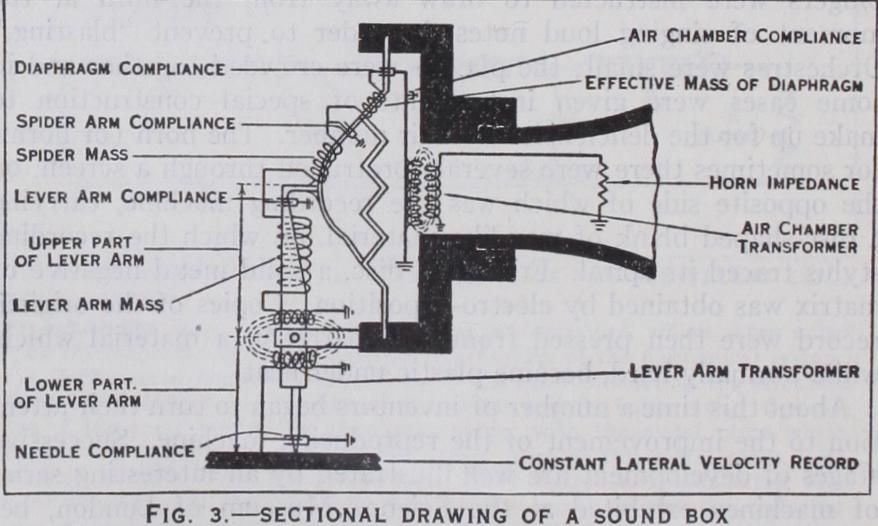

      I have an old gramophone i am trying to restore. I have al the parts, but the "pickup head" is missing. I wonder if any could help me with some information and perhaps a drawing. ( It is a weary old gramophone with a big horn).

              Thanks for the link. very interesting historic document, but no drawing of the pickup mechanism. Look forward to Your photocopy
              Sivtek
              #273699
                Posted by Johs- Line 1 on 25/12/2016 15:40:37:
                … but no drawing of the pickup mechanism. Look forward to Your photocopy
                No promises that it will be more informative than this one [from the linked document]:
                … the electrics shown here are an 'electrical equivalent' of the mechanical device; so you can erase them from a copy, to get an idea of the mechanics.

                          The diaphragm is made of aluminium or Mica and there is rubber at each side of diaphagm to hold on in the sound box.
                          No difficult to buy spare parts –> **LINK**

                                            78rpm records are made of a hard material which will wear any needle in contact with their surface. If the needle is as hard (or harder) than the record, the record will wear as well. If the needle is softer than the record, the majority (or all) of the wear will be to the needle. Needles can, and must be, replaced, but records can't be. So to preserve one's precious recordings it is important that record wear is kept to a minimum, or even better to reduce it to zero. smiley

                                              Thanks to everyone, I think I have all the information to make the sound Box, only one question or two. What angel should the needle have to the table and can I use some thick plastic as the membrane?

                                                Johs- Line 1, when you wrote about angle of needle on soundbox, then i googled and found the information about adjusting of the tone arm tracking and angle of needle. Here is the link –> http://www.graham-ophones.co.uk/keeping-on-track/4590882209

                                                  You could use a thick plastic, but you will not get any sound!
                                                  Mica sheet is the best and original, you need a certain stiffness but very low mass.

                                                    Or use aluminium as here –> **LINK**
                                                    You can produce the diaphragm of aluminium sheet formed on spinning tools at lathe. I am not sure how thick it will be. It must be audible from grammophone.
                                                    Mica sheet —> **LINK**
