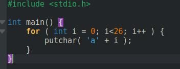

                                              Nothing like an example to show why Neil and Danny enjoy pain.
                                              This 'C' program outputs: abcdefghijklmnopqrstuvwxyz

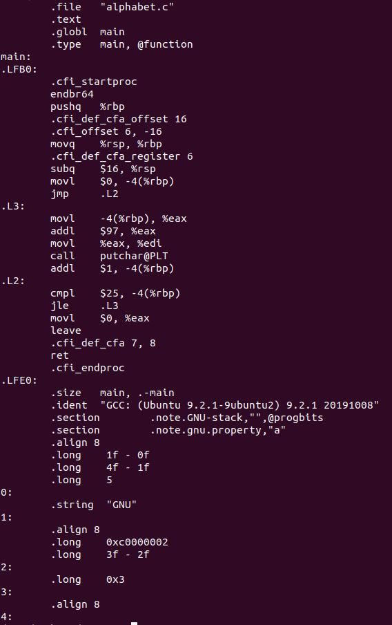

                                              Neil and Danny prefer to write:
                                              To be fair, the Assembler instructions are for a modern Intel processor and these are unfriendly compared with the good old 8080, Zilog's souped up Z80, or the 6502. One reason is modern CPUs are much more complicated than early microprocessors, another is chip designers develop instructions to suit compilers rather than humans because 99% of programs are developed with interpreters, compilers and generators, not by people writing low-level code.
                                              G-code is similar: although it can be read and written by humans, it's really meant to be generated by a CAD/CAM tool and read by a CNC machine.
                                              Used to be quite easy for humans to write better code than a compiler, nowadays the opposite is more likely. 70 years of development have made compiler optimisations very clever indeed. As it needs an exceptionally good programmer to beat an ordinary compiler and she takes forever to do it, writing assembly is reserved for special occasions, one of which is doing it for fun. Otherwise, don't bother!
