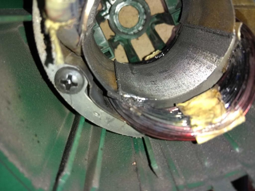

          I've taken the saw to bits and extracted the motory.
          One of the bushes is chipped on one edge.
          The armature was dirty and there was carbon between the copper.
          I scraped this with a small knife and then brushed with isopropyl alcohol.
          I measured the resistance between the copper rings. Adjacent rings had a resistance of about 1 ohm. each successive ring added about 0.1 ohm – so copper on opposite sides of the armature had a resistance between them of about 2.2 ohms. I didn't test all of the pairs but all I tested seemed to show the same.
          The resistance between live and one of the bushes was about 4.3 ohms and similarly between neutral and the other bush.
          I don't know if this is normal or not.
          I have pictures, but I didn't see anything untoward – if they would be useful then I can upload them.

            Check between the comm bars and the armature spindle for leakage, preferably with a megger, armatures usually fail to earth when they overheat and the varnish melts. also check continuity through the field coils, and to the metal laminations of the field coils.

                I don't really know what I'm doing here, but I checked various resistances and capacitances and it all seemed OK. So I thought I would put it back together and give it another go – who knows, it might work.
                When re-assembling I noticed this
                It's not the best photo in the world, but the windings are clearly burned and the shell has also been burned.
                So it's bye byes for this little chap.
                I will pop into Aldi and see if they can do spares. The interweb appears not to.

                  it's unusual for the field coils to fail. You may find a reader who has a set of coils as it is usually the armature which fails when they overload the motor/ saw. These devices such as angle grinders,and table saws need the speed to keep them cool. John

                    Field coils can be rewound……not too much trouble…

                        It could be that when that coil was wound the magnet wire got chafed or the insulation coating cracked. Also could be the protective insulator paper or plastic sheet between wire and coil laminations was not placed correctly or was split. After a bunch of hot / cold / vibration cycles the conductor became exposed and the distance between wire and laminations got short enough to allow an arc to start. It can happen. Some years ago people were having exactly the same fault on Weed Eater brand line voltage grass trimmers. Must have had the fault in many thousands of them during a production run – there were hundreds brought in for service and hundreds more visible at the curb on garbage day for months.
