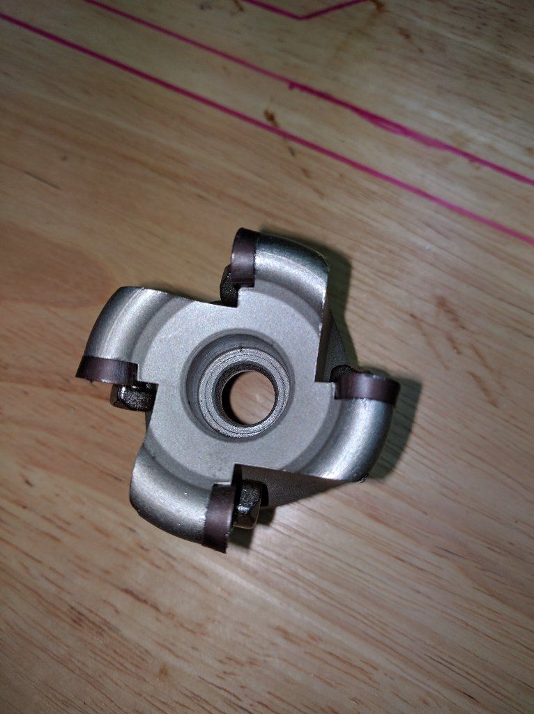

        Does anyone use one of these ?
        It appears to be a kind of face mill (on a 27mm shell arbor) – it came with my Superlux, I noted that the "toolbits" in it are mild steel and swiftly put it on high shelf. Curiosity got the better of me this evening, and I took it for a ride on a bit of scrap aluminium, and got quite a nice finish,
        I am now wondering about putting some hss in and giving it a proper try. Thoughts ?

          You say the tool bits are mild steel.  Carbon steel tool bits were the thing before HSS and are still capable of giving good finish depending on speed and depth of cut

            HSS inserts should work OK and easy to re-sharpen. A bit like a double bladed fly cutter.
            Carbide tipped cutters are also available on fbay.
            Paul

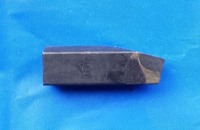

              Roy, no really – dead soft with a file. Mild was optimistic, cheese may be more accurate
              Paul, is actually 4 cutters, although not obvious from photo. When you say carbide tipped cutters, you mean like a lathe tool or something specific to this?

                Are you sure that it does not have brased on carbide tips ? On the right hand tool bit I think I can see a slight difference in colour at tha bottom pf the tool.

                  If you look really closely on an enlarged image you can see that on both cutters.

                    You are absolutely right – I have no idea how you saw it, I can only just see the line now with the the thing held up to the light, the whole lot has been ground together and looks like one piece.
                    The carbide is chipped and blunt, but will give it a real test now I know it might work …

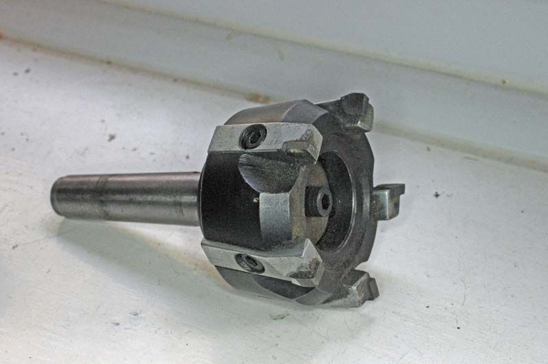

                                I've got one, it came with the Economy mill I used to have. Useful enough to keep when I sold the mill and then make a 2MT arbor for it. Works adequately on a first cut for an iron casting but better insert cutters are available for reasonable money these days.

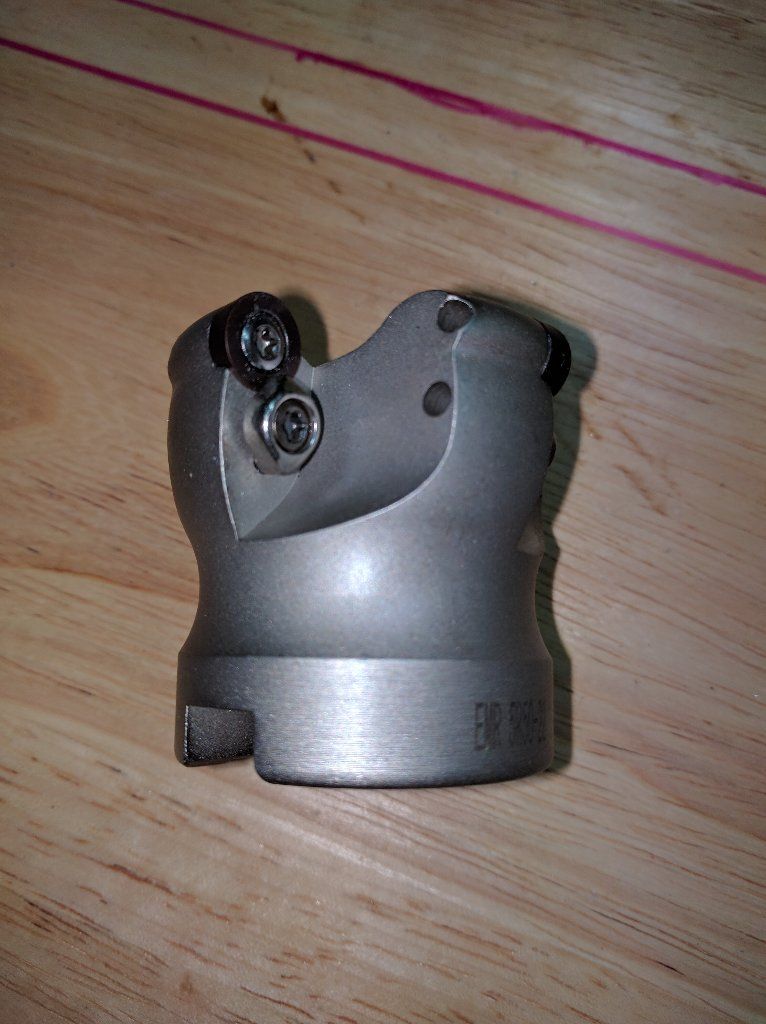

                                                A slight diversion – I recently got this indexable face mill from ebay:
                                                I only bought it because it came with an R8 arbor I wanted, for less money in total than most of the suppliers were selling the arbor alone (I would have bought from arc but they were out of stock). In the end I have ended up with a full refund because the R8 arbor was M12 instead of 7/16 as advertised.
                                                Anyhow, the cutter is awful, chatters horribly and barely cuts (aluminium). Is there something in the nature of the style with the circular inserts which is problematic? I can't immediately see what else could be wrong with it.

                                                  The full radius inserts should give a good surface finish. You can get high rake inserts for Aluminium / plastics.
                                                  I use them even in steel. My round insert cutter is 75mm Ø and cuts very softly , Can't tell for sure from the pics, but the inserts loaded just now look like normal Positive ones. Try the high rake ones and you should notice a big difference.
                                                  Also a lot depends on the machine rigidity and your depth of cut. Don't be tempted to take large depth of cut if your mill is a lightly built machine, the two don't belong together.
