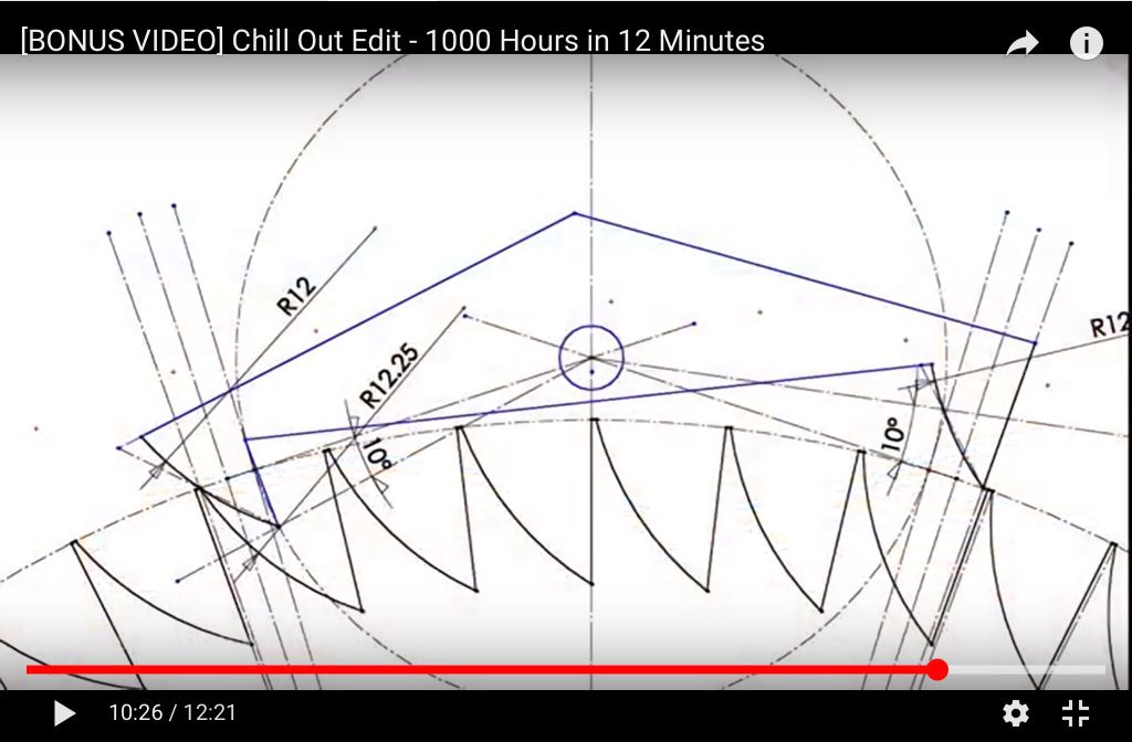

      I have been trying for two weeks or so now to get this clock to run. All the pivots are polished and free in their respective holes, the train falls from side to side with the 'audible click' the arresting faces of the escape pallet have been brought to a mirror finish as have the corresponding faces of the escape wheel. The spring barrel is free to rotate on its' spindle, the pallet arbor is free and the clock set in beat using an ' amplitic' audio device. When set going there doesn't appear to be any force in the escape wheel that would result in a recoil action sufficient to maintain the momentum of the pendulum. The only thing that I can find at odds with the designed plan is that the spring purchased from Rite-Time for this model does not conform to the spec. quoted by J.W. ie it is aprox. 60thou. down on width. With the escapement disconnected and just one turn on the spring the clock will 'free wheel' for the equivalent of 36hrs. or so, with the escapement engaged ( with several turns on the barrel ) it will not run passed the naturally decayed swing of the pendulum. ANY IDEAS PLEASE ?

            It's not the recoil that drives the pendulum. In fact it's the pendulum that drives the recoil! Some designs of escapement have no recoil at all. Which of J.W.'s designs is your clock?
            If the spring is the wrong width have you also checked it's thickness? That is more likely to give lack of driving power if wrong.
            What have you used for lubrication? Are the pallet faces lubricated? A common problem is too much oil on the pallet faces.

              Russell is correct, but looking at the relevant Clickspring video this is essentially an anchor escapement with a small amount of recoil. Do you mean recoil in the technical sense, or impulse? Recoil is the action whereby the pendulum overswing forces the escapement wheel to turn backwards, which actually absorbs energy from the pendulum which is given back with interest slightly later.
              When you apply "several turns" on the barrel, what percentage of winding is that? What if you fully wind?
              One thing to try is to see if the clock will run when you apply a greater torque to the train than the spring can, either manually or by a weight.

                    #366583
                      Posted by Boldminer on 09/08/2018 05:50:07:
                      … The only thing that I can find at odds with the designed plan is that the spring purchased from Rite-Time for this model does not conform to the spec. quoted by J.W. ie it is aprox. 60thou. down on width.
                      If the spring thickness is to spec. and given that you have tried the extra checks that John suggested … I very much doubt if the reduced width is of significance.
                      It seems more likely that there is some undetected error in the set-up of the escapement.
                      If you have suitable equipment to hand … some detail photos of that area would be helpful.
                      #366612
                        [ Update ]
                        For convenient reference, here is a frame-grab from that excellent Clickspring video:

                          I suspect that the impulse face of the pallet, or at least one of them, is a curve whose centre is the pivot instead of offset as in the diagram above. This means it cannot receive any impulse and also means you will not see any recoil. The recoil happens because after contact between pallet and tooth the continued swing of the pendulum pushes the tooth back.
                          In the diagram above that happens if you imagine the left hand pallet moving from its present position to a point where the contact is that little arrow is on the end of the 'R12 line'. To do this the tooth will have to have moved to the left, anticlockwise, which is the recoil. Then as the pendulum swings back the tooth is moving clockwise ending up further round from where it first made contact. It is this part of the wheel movement that imparts energy to the pendulum. The additional rotation that happens as it drops from one pallet to the other is wasted energy which is why you try to keep it as small as possible.
                          The pallet face does not have to be curved, it can be flat, so you could try an 'all or nothing' approach of filing it slightly to an appropriate angle to see if it helps. You would likely have to remake the pallets anyway.

                            Lack of recoil will not stop the clock from running, many escapements are designed without recoil at all and some with a minimum amount. In the case of the anchor escapement such as yours it would however cause poor time keeping. Given that your clock is only running for the period of the pendulums natural decay I would suggest, as has already been touched on, that the problem is lack of impulse. If the movement is free running and there's adequate side play on the arbors you may have to re-check the pallet geometry. If, as already commented on, the pallet face is radial to the pallet arbor then no impulse will be given. Filing metal from the pallet may facilitate some degree of impulse but it will be very small, that's why clocks with worn out anchor pallets are only capable of small and unreliable pendulum amplitude. It will also create excessive drop. Although it's necessary for reducing friction and wear in a working movement, if a new movement will not work without oil on the pallets there is an underlying problem. Arbitrarily attacking the pallets with a file is likely to finish you up in the madhouse so I think you should carefully study the pallets you've made and consider making a replacement set.
                            #366651
                            John Haine
                              @johnhaine32865
                              Yes, though recoil is a side effect of how the anchor escapement works it is a sign that it is doing the right thing. If the pallet faces are circular arcs and there is not recoil it shows that the axis of the arc is in the wrong place. I fear the solution most likely to succeed is to make a new anchor.
