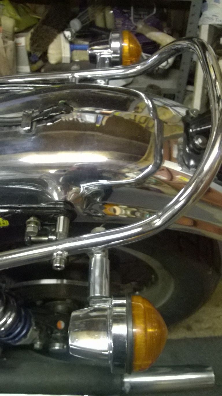

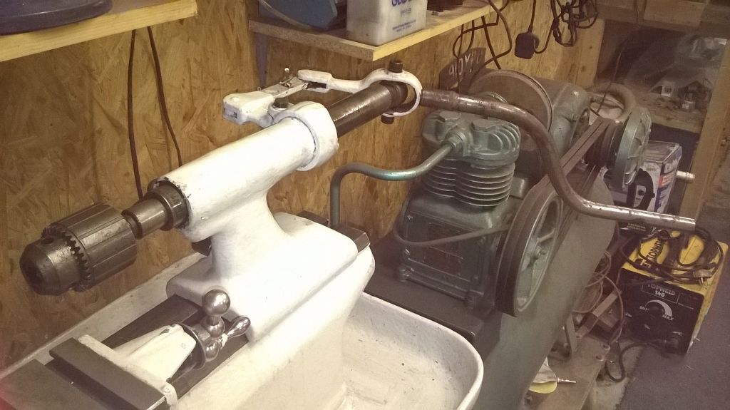

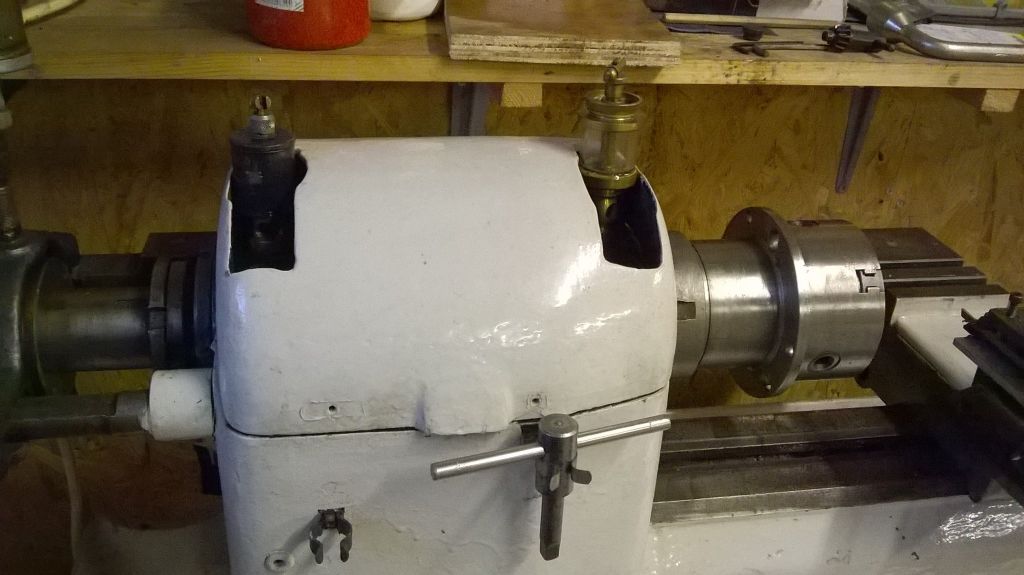

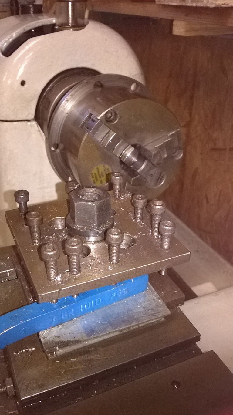

              Phew! I must go and lie down now as my head hurts. Just a few comments before I do. Image 1 – Behind the lathe the 'magic box' can be seen. A previous owner has built this and it contains the rheostat to alter the speed from Dead Slow to Fast. Also a switch to reverse the rotation of the electric motor. Image 2 – shows the titchy M4 Allen screws which I feel could go up at least one size. Image 3 shows the strange handle to slide the drill chuck in and out and I may change at some time for a conventional drill post. Image 4 shows two of the oilers crudely poking through the belt cover. These leak. Image 5 shows the rear end of my 1977 Honda GL1000. When I added the grab handle I had to make up two small spacers in stainless steel, shown between grab handle and frame. Also two stepped alloy spacers for the non-standard Lucas rear indicators.

                Looks a useful lathe, Paul
                The tailstock lever extension is a bit gross, but the basic mechanism seems good. … Put an appropriate lever on it and it should be fine.
                The toolpost looks home-brewed to me, and I would have no qualms about modifying or replacing it.
                Have fun
                Edit: See photo near the end of this page … That's what the lever should look like.

                  The topslide looks like a reversed Myford long cross slide – none the worse for that smiley. Looks to be a good, solid lathe.

                    I wonder who bent the lever on the tail stock ? I think I would get it off and straighten it. Like many of this style the tail stock has a nice long stroke.
                      John,
                      As I mentioned yesterday:
                      I wouldn't bother straightening the 'custom' lever, just replace it with a reasonable replica of original.

                        John, I think the lever is bent like that as it puts the end closer to the machinist. It frankly doesn't bother me as it is, just that I'd prefer a conventional tailstock with a screw fed chuck. It is a simple task to unscrew and store away when not needed. The other day, I needed to drill an 8mm dia. hole into the end of some stainless steel bar, my first attempt at turning this metal. OK, at first with a new pilot drill, but then onto something a bit bigger (5mm?) as I was going to work my way up to the final size. Now OK, the 5mm might have been just a tad blunt but not overly so, but I had to really pull on that lever to get the drill going. By the time I reached the 8mm drill, it was cutting like aluminium.

                          winkWondering why some one might do something like that – maybe to get 2 levels of leverage for different drill sizes that fit well in the hand. Maybe they didn't need the one on the end or couldn't be bothered to fit a knob.
                          Noticing your post after I made this one – not sure I would do anything about the handle either – rather use the lathe and sort out any problems.

                            Ref the "bent" tailstock handle. In the picture, the tailstock is parked at the end of the bed. Unless you are using a 15" long drill, it would be never used here. Taking a more realistic view, drilling a piece in the collet, the front of the tailstock would be 4" or so from the chuck. If the handle was straight you would have to step to the left or backwards or it would hit you in operation!! It could also foul the tool holder.

                                  Michael, Those images are just what I wanted to see. I would like to get a conventional tailstock one day but there's no hurry, as I can have plenty of enjoyment in the meantime. The bent handle? It doesn't offend my eye and does what it does OK, but again, it's nice to see what the original looked like. I detach it for much of the time.
