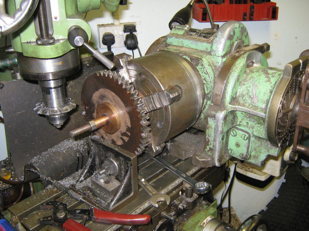

                        I have been using the Warco version last 10 years and found it to be an accurate and versatile machine. The ability to swivel the head horizontally and vertically has at times been a useful feature. I did out of personal preference change the swivel head securing nuts and bolts as these were of poor quality and soft material, maybe not a problem now. Other than that I have not had any problems at all and have no complaint.
                        I find it's capacity more than adequate as for example seen here cutting 5-1/2" dis gears using a dividing head meant for a mill twice the size.
                        I fitted a coolant pump and longitudinal feed (x axis) as a first priority then later a variable speed drive. I don't feel the need for any further improvements and find it a pleasure to use.
                        Very pleased I went with R8 spindle taper.
