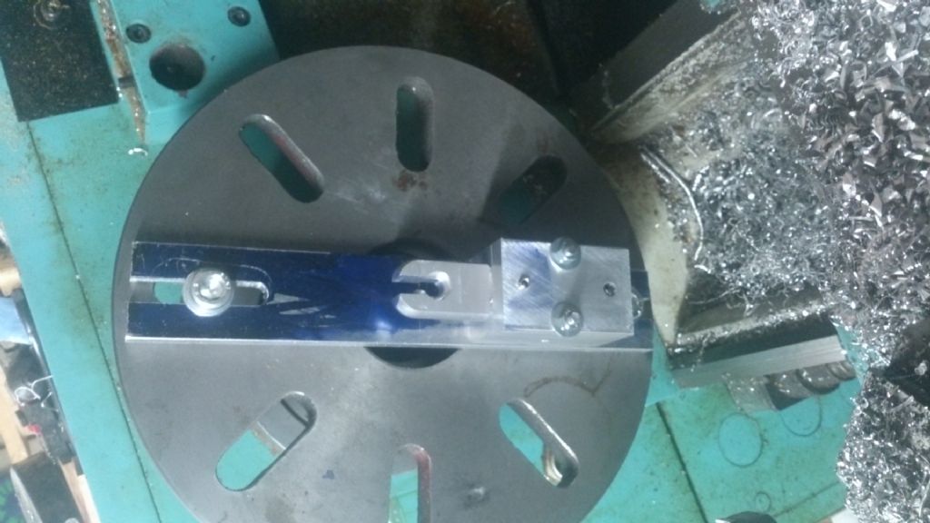

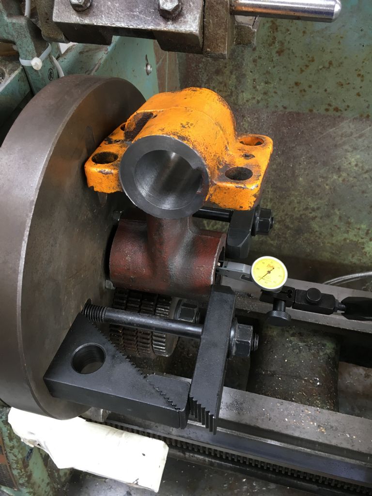

      In another thread (Here's another nice mess…) I asked for advice about workholding. Concensus seemed to be that I should use a faceplate, which is new territory for me. So, (with apologies for the inelegant implementation of the suggestions I received) I knocked this up:
      the aim being to bore out recess at the crotch of the fork from 12 to 20.5 mm diameter. It is actually centered, honest, cameras can lie!
      When I spin it up at 200rpm the lathe is rock solid, but at 330 there's a bit of shaking. A quick calculation (the block holding the workpiece has a mass of about 200 grams with a CoG about 55mm from the lathe axis) tells me that at 330rpm the centripetal force due to the imbalance is about 12N, or around 1kgf, if my calculation is right (questionable nowadays!). Surely there's no way that could affect the (600kg) machine unless there's a resonance?
      So my question is – should I crank up the speed to get over the resonance (if that's what it is) or do I really need to balance the job to avoid injury to limb and lathe?
      Robin

          You need the gadget described by Andy Johnstone in MEW 263. The article is entitled "Mounting item on a faceplate".
          I made a similar gadget based on this article last week and it is very helpful for getting a good balance on the faceplate with the moiunted work.
          Mike

            Posted by Michael Cox 1 on 22/02/2018 22:59:38:
            Mike
            Or you could make Harold Halls version (I wonder if Andy based his design on Harolds???).
            I also find it very useful.
            Steve.
            Edited By fishy-steve on 23/02/2018 00:10:37

              I'd recommend balancing the job with a similar sized block on the other side of your bar. You could use some plates with holes for the coarse balance and use some washers to fine tune the balance. A faceplate balancing jig as others have mentioned is certainly nice to have but by weighing the loads each side and with careful adjustment you should be fine. Go slow with speed while testing though, and watch your fingers around the edges of the rotating balance blocks.
              Also on your next workpiece – do all drilling and boring before cutting the fork slot. Drilling and boring will be much smoother if you do, and the diameters will be easier to keep on size.

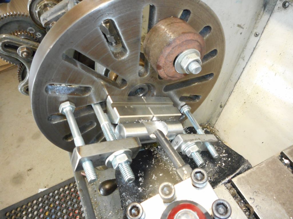

                  Posted by Robin Graham on 22/02/2018 22:48:46:…
                  …So my question is – should I crank up the speed to get over the resonance (if that's what it is) or do I really need to balance the job to avoid injury to limb and lathe?
                  Robin
                  Dunno about the calculations, math is not my thing, but experience tells me the faster you spin the out of balance faceplate, the more the lathe will attempt to dance across the workshop floor.
                  Traditional fix is to take one of the lathe's change gears and bolt it to the faceplate. In this instance probably on the bolt you have holding the far end of the aluminium flat bar. I'd start with a 25T gear or so and see how that goes. You can get a pretty good idea on a Myford by slackening the belt and moving it away from the spindle and spinning the faceplate. If it always stops at the same spot, that's your heavy spot. Size of the counterweight and how far out from the centre you bolt it affects the balance.
                  If you want to avoid getting swarf all over your change gear, a piece of round bar with a hole drilled through the middle works well, or a selection thereof in different weights. I painted mine red so I can see where it is in flight and avoid banging the toolpost, or my fingers, into it while focusing on the job in the middle of the flight path.
                  With good balance you should be able to machine that job at 600rpm etc. if required.
                  #342848
                  Hopper
                    @hopper
                    PS, counter weight in action on a tricky faceplate set up, before I learned the hard way to paint the weight a visible colour.

                                          Looking at that picture it looks as if the cutter does not extend to the end of the tool. Or is that just the picture distorting the facts? if not, then how did you cut the full depth of the semicircle without cutting the V block?
                                          Edited By Sam Longley 1 on 27/02/2018 07:59:28
                                          #343365
                                          Hopper
                                            @hopper
                                            Posted by Sam Longley 1 on 27/02/2018 07:48:11:
                                            Posted by Hopper on 23/02/2018 06:31:40:
                                            Was quite a while ago but from memory the cutter is about level with the end of the boring bar and the V in the V block is the small one, plus the semicircle is less than half the diameter of the bar deep so it did not have to go all the way down.
                                            My son and I did a similar job at the same time when we were making the fabricated body for the Versatile Dividing Head where the semi-circle went lengthways along a piece of 1.5" diameter bar bolted to the faceplate with a bolt up a hole in the bar. On that one, we put a piece of paper between the end of the bar and the faceplate and the plan was to cut right up to the paper, theoretically three thou from the faceplate. But I lost my bottle at the last minute and bored it to within about 10 thou of the end of the bar and cleaned it up with a half round file afterwards. A sacrificial piece of thin plywood or masonite etc would have been more appropriate, or even a piece of aluminium flat plate.
                                            Edited By Hopper on 27/02/2018 08:03:02

                                                  Just for a bit of context, I have no milling machine and where I live, getting blocks of steel big enough to bore a hole to fit that bar into is impossible without prohibitively expensive shipping in, and a week or more wait, so it was definitely a "make do" scenario.
                                                  How I set the boring bar to cut the right radius in the job was to hold a disc on a bolt in the tailstock. The disc was the diameter of the scallop I wanted to cut out of the job. The job was marked up at the depth where the scallop was to go to, and was clamped to the f(l)aceprate so that point aligned with the edge of the disc held in the tailstock. Fortunately the diameter of the scallop was large enough that the job rotated around it with a space in the middle so did not foul. (Check this before pressing the start button!) The boring bar started off with light cuts and just kept going until the cut came out to the marked up line that had been aligned with the tailstock disc previously.
                                                  All a bit Heath Robinson but it got us out of a tight spot, having no mill or even boring head to use in the lathe. And it was suitably bizarre to provide an afternoon's entertainment.
                                                  I've since found that such flaceplatery works better for many jobs than trying to mount oversized objects on the spindly Myfrod double swivel vetical slide and trying to mill them. Especially with long or large jobs where the Drummond's limited four inches of cross slide travel restricts milling to that length, or actually less with a flycutter, whereas you can machine an 8 inch flat surface on the faceplate. And compared with the vertical slide, the faceplate is rock solid and some stupid large and oddball jobs can be done on it.
                                                  Next faceplate project planned is a couple of 4" x 4" angle plates. Turn up two cylinders with one end square to the OD, bolt them to the faceplate then clamp/bolt the angle plate (cut from thick 6" angle iron) to the two cylinders and face the surface. So many projects, so little shed time…
