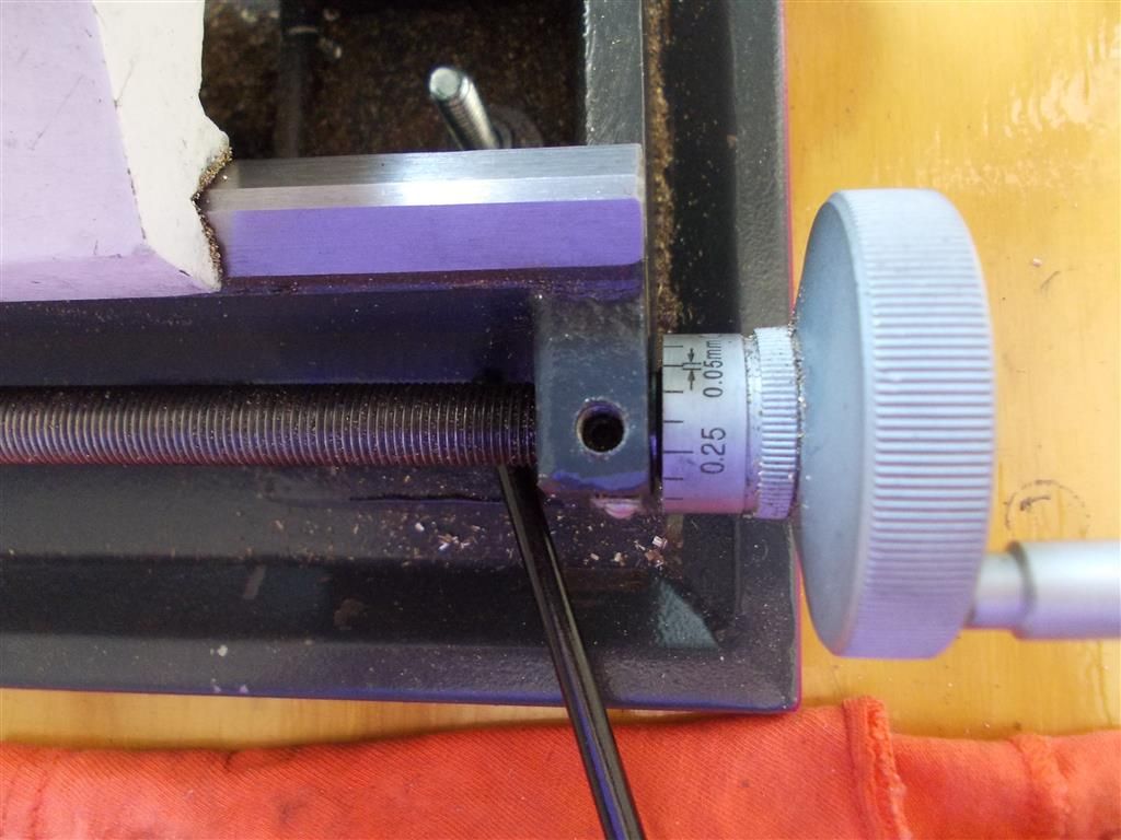

      To me; it looks like the Bush [303] has slipped in the Casting [301] … to the extent of moving past the Grubscrew [302].
      Question: Has the Grubscrew now been 'tightened' into empty space … sufficiently for the end of the Bush to jam against it ?

        This grubscrew onto the bushing arrangement has never worked well. It started giving me problems in the first few days of receiving the lathe. For a start, there was nothing for the grubscrew to grip on and you can see where the screw has been tearing at the bush. Acting on advice from the company, I drilled a dimple in the bushing so the screw could get a better grip but it is still not great. I might give the company a call later today and see what they have to say about it.
        The grubscrew is not tightened into empty space. I left the bush and hand wheel out like that so that everybody could see the parts. When it is all tightened up there is nothing to see….and it doesn't work !

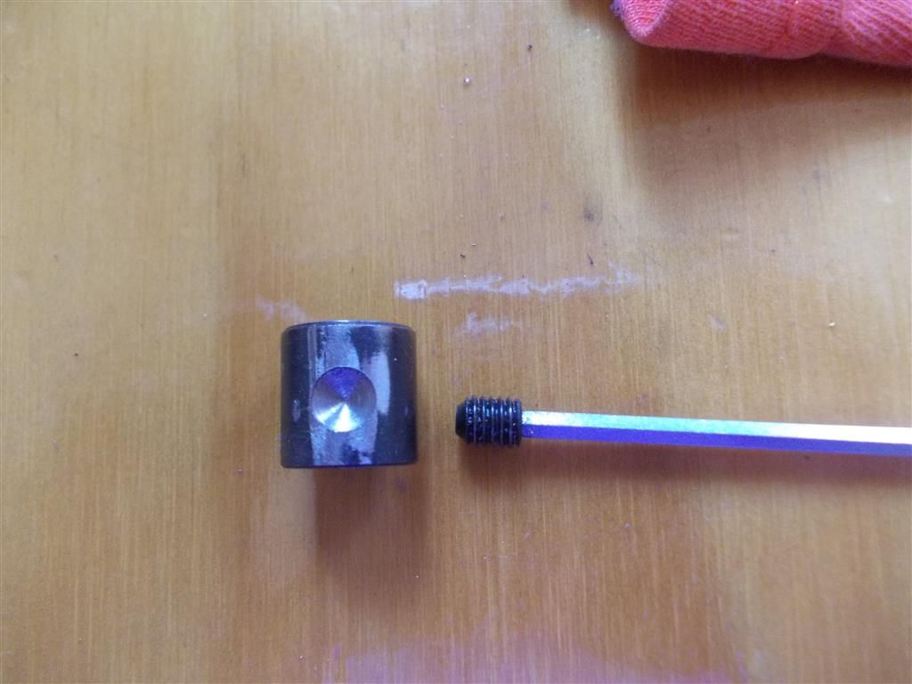

              The tearing at the bush may be a result of those plates under the carriage being a bit on the tight side. Possibly too from swarf getting into the unwipered/un covered slideways and jamming things up a bit tight.
              Also, hard to tell from the pic but the dimple in the bushing looks like it could use being a little deeper and larger diameter to match the grub screw. Can you take the bushing off and drill the dimple out in your new drill press? Also, spin the grub screw in the lathe and file/turn a bit of a point on it to fit the dimple. Use a bit of shim wrapped aroiund the screw to avoid the chuck jaws damaging the thread.

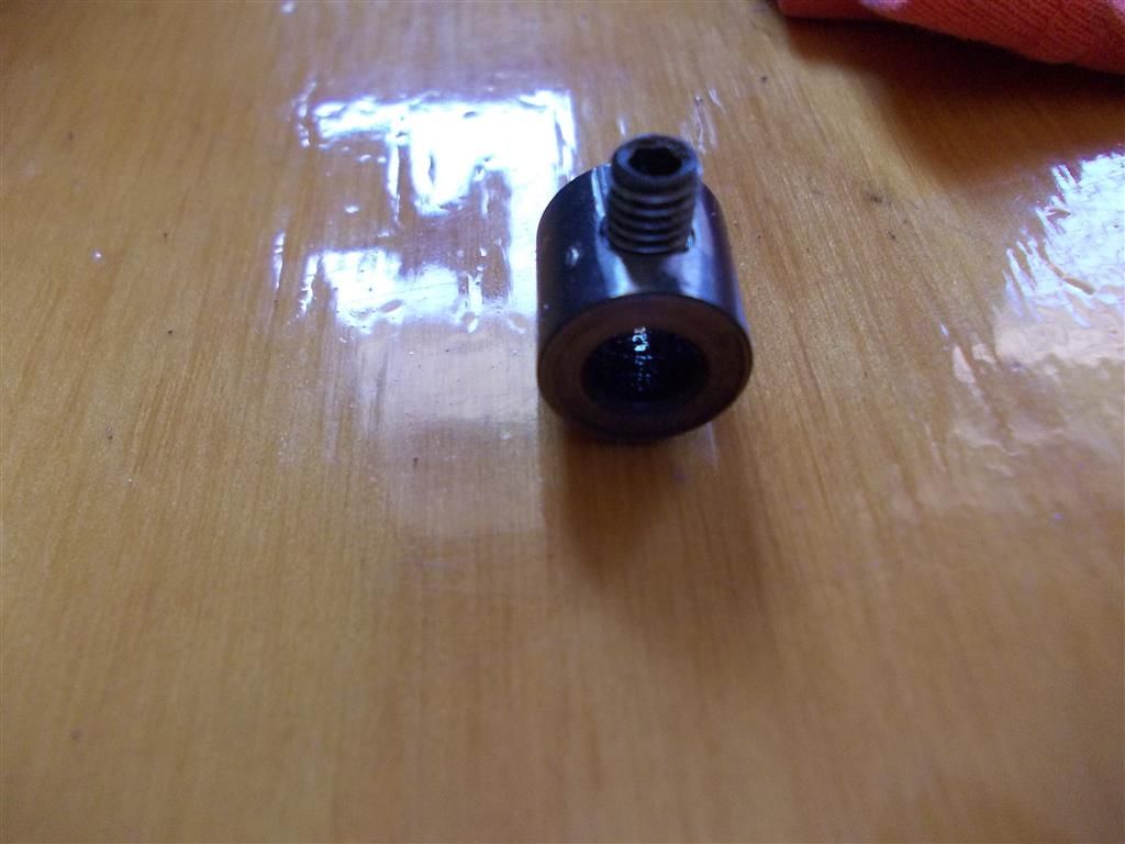

                John : but I have already taken out the whole clutch assembly (321 and everything attached to it) and disconnected the 322 from 311 and the problem remains. I thought it was the clutch too at first but it is not.
                Hopper : okay, I will try drilling out the dimple a bit. I may also have to get underneath and loosen the carriage but if it will screw one way then surely it should screw the other way ?
                Edited By Brian John on 23/10/2015 05:36:01
                #208937
                Brian John
                  @brianjohn93961
                  A bigger dimple has helped a lot. The screw is 4.5mm so I tried a 4.5mm dimple but this did not result in a good fit. I redrilled it with a 5mm drill and this seems better. I have not turned the end of the screw at this stage. I would like to have a few spares on hand before I attempt that ! There is a bit of a gap between the hand wheel and the casting so the dimple must not be exactly in the correct spot. I tried the bushing inserted the other way but the gap was even wider which does not make mush sense !
                  The lead screw is still a bit stiff but it does turn. I will give the lead screw a good clean and oil. Tomorrow I may turn the lathe over and adjust the gib screws and jacking screws under the carriage although the carriage is so sensitive to adjustment I am reluctant to touch it. It gave me a lot of problems last time ; either too loose or too stiff.
                  NOTE : I would like to order a spare bushing and try drilling and tapping it for the grub screw. I think that would be even better….not tapping all the way through, about 3/4 of the way. I have a lathe so I suppose I could make one out of steel but I do not get a good finish on steel.

                      That is true but I am getting a lousy finish on steel with this lathe. Brass and aluminium are no problem even when using the carbide tools. If I finish with Hopper's HSS tool bits then I can get a mirror finish on brass and aluminium. But I have found working with steel to be a real problem. I tried turning some axles (6.35mm down to 6.00mm) and the result was awful. I think I might have to buy 6mm stainless steel from now on and hope it has been produced accurately so I can use it as is….what are the chances ?
                      #208944
                        Buy Silver steel (drill rod) or precision ground mild steel (PGMS) for your shafts that should be onsize.
                        A brass or bronze bush would be OK, the outside of the bush does not have to be a mirror finish so again the finish you are getting on steel will be OK with areamed hole.

                            Make the bush from bronze, or brass, or you can use a bit of cast iron. Don't use steel for a bearing on a steel shaft, most metals do not like running together.
                            Is there a way to easily lubricate the bush(and any other similar bushings)?

                                    If it's stiff you may have got some swarf in the nut. Over tightening the grub screw might distort the bush. If the edges of the clutch parts burr over that would stiffen things up too.
                                    I suppose the best way to locate the bush would be a dowel that just passes through the body of the bush missing it's bore but going as close to that as possible. The same sort of thing is sometimes done with a grub screw in a tapped hole. Easier in some ways as no need for the tolerance dowelled holes need. Drill through stopping short of breaking all of the way through with the bush in place and tap. The existing grub screw could be used to keep it in place as I doubt if it's a very precise fit. A roll pin is another and easire option – designed to be driven into drilled holes so drill all of the way through.

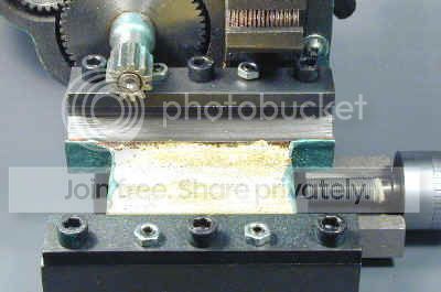

                                        Brian the lead screw needs to be a nice smooth to turn fit. It could also be a matter of leadscrew alignment with the nut it engages with in the carriage. Not sure if your lathe has an adjustment there?
                                        There is a bit trick to adjusting that type of carriage gib set up, if it is like the pic below:
                                        The two screws with the hexagonal locknuts on them will push the strips away from the lathe bed when the locknuts are loosened and the grub screws are screwed in. These are called jacking screws.
                                        The three socket head cap screws (allen head bolts to most of us) pull the strip toward the lathe bed. These are the clamping screws.
                                        The trick (well one of them) is this: Loosen the the two locknuts and back out the two jacking screws. Then loosen the three Allen head bolts and back them out a few turns.
                                        Now, tighten down the centre Allen head clamping bolt until the strip is firmly against the bed. Then screw in the two jacking grub screws until they just touch the metal of the carriage. Then back off the centre clamping bolt a quarter of a turn or so. Then screw the two jacking grub screws in about 1/8 of a turn or so. Then tigten up the centre clamping Allen head bolt again. This should set the plate a tiny distance from the lathe bed way. Check with a feeler gauge that you have about .001" (about .025mm) gap between the strip and the way at each end of the strip. If one end is higher/lower than the other, use tiny adjustments of the jacking screws to get it even. When you have the right gap at each end, nip up the centre clamping Allen bolt a tad more and nip up the two hex locknuts on the jacking screws, while holding the screws to stop them rotating.
                                        When you have done this with both the plates, you should be able to slide the carriage up and down the well-oiled ways quite freely, if all is clean of swarf etc. It will have a little bit of slack due to the one thou gap under the plates.
                                        To close up this gap, use the two end Allen head clamping bolts on each plate to just pull the plate down that half a thou or so at each end until perceptible shake is gone but the carriage still slides freely with barely perceptible drag. Don't overtighten them. If you cant get rid of the gaps at the ends, you may have to repeat the procedure with a little less gap when you set the jacking screws.
                                        It would be best to remove the leadscrew or its nut from the carriage so you can manually slide the carriage up and down the fulll lenght of the ways by pushing it and feel by hand if there are tight or loose spots etc. This also lets you know the plates are set right, and if the carriage gets tight agian after installing the leadscrew and nut then you know the problem is in the leadscrew/nut alignment.

                                                One thing I did discover last time I adjusted the carriage is that a perfect adjustment at the end of the rails will be too tight in the middle so this time I will make the adjustment when the carriage is close to the chuck. I doubt I will ever be turning anything lengthy in this lathe.
                                                Under the carriage has four grub screws (jacking screws) and two socket head caps ; there are no locking nuts.
                                                There is a small ball bearing type lubricating nipple on the gearbox end of the lead screw. The manual says to grease once per month. What sort of grease ? I am thinking that a ball bearing type nipple such as this is designed for oil and the use of the term ''grease'' is a translating error.

                                                  The absence of lock nuts could be part of the problem. Things move under vibration on lathes if not locked down.
                                                  With four grub screws and two SHC screws, presumably two plus one on each plate, all you can do is try to get the one thou gap at each end of the plate then nip the cap screw down a little bit to take up the slack. It seems like you will end up with the plates always bowed this way. It might be worth looking at doing away with the jacking screws and using brass shim to set the plates in position, then you can tighten down on the cap screws and positively locate the plates. Of course, it would help too if the plates were ground/scraped dead flat.

                                                  A properly fitted grub screw should work just fine on that bushing. It's all I use on the drive pulleys on the 3/4 horsepower motor on the old Drummond and they have never let go yet. It might be a good idea eventually to drill a small oil hole right through the housing and bushing so you can drop a spot of oil in there every time you use it.
