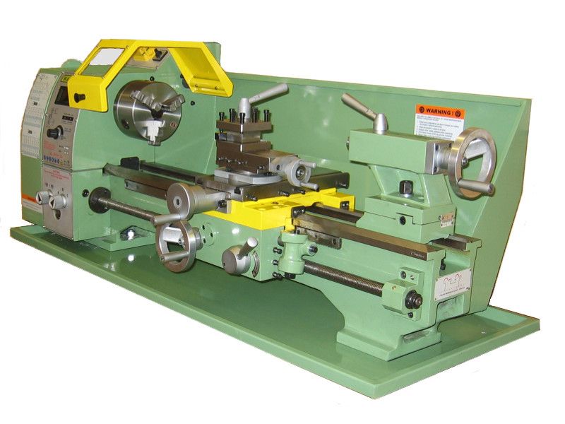

      Weiss 10×30″ Variable Speed Lathe.

        Recently acquired this Weiss variable speed 10×30" Lathe. I chose to utilize the 200 series QCTP sized package. Tool holding package will hold a 3/4" boring bar and other tools quite rigidly. Using the 200 sized QCPT holders requires some minimum modification to the imported lathes in this size range to correctly fit.
        The speed ranges are 50-1000 RPM &100-2000 RPM with the easy belt reposition from one pulley to another.
        The lathe has powered cross and longitudinal feeds and reversible lead screw for rt and left threading abilities. Unit comes with a chip pan and a chip barrier. The chuck guard is interlocked, my first reflex was to disable and use it without but after a little use I like the feature of containing chips while cutting close to the chuck so will leave it in place as it is not that restrictive with adequate illumination that is provided by the clip on LED light from Wal Mart for the princely sum of $12.95. Sure beats the $50 dollars for most mag based lights of similar output. Also added two 18" HF magnet bars for frequently used tooling storage.
        The Lathe is setting on one of Sam's workbenches that assembles in about 15 minutes has a 1-3/4" thick hardwood top, powder coated frame with fully adjustable legs for height and leg leveling screws for the 4 corners, overall very well constructed unit for $209 plus tax out the door!

          Is it US or chinese manufacture?

            Probably Chinese, looks to be pretty well identical to my WM 250 just a different colour.
            Good lathe should work very well for you, happy turning…

              A bit of research before asking would have shown that Weiss are based in Chinasmile p They will paint it whatever colour the supplier wants and put the stickers with their name on too.
              Yes should do the job, my slightly larger 11 x 27 came from the same source.

                Apart from the colour, leadscrew telescopic guard & on/off/ES arrangement it's virtually identical to my WM250V-F. I have found mine to more than capable for stuff that we 'hobbyists' do.

                        Not my thread to go searching. cheeky I did ‘goggle’ it very quickly and was surprised at the price tag, unless there was something special about it, if it was chinesium.
                        First price I saw was $4375 and, since, over $7300. Unusual for a chinese piece of kit?

                          But it has the longitudinal/cross feed lever as per the slightly different WM250V. For fine facing, or milling using a vertical slide, that cross feed is *extremely* useful. I really wouldn't want to be without it.
                          It looks as if the OP's lathe differs mainly in paint scheme, and slightly on speed ranges.
