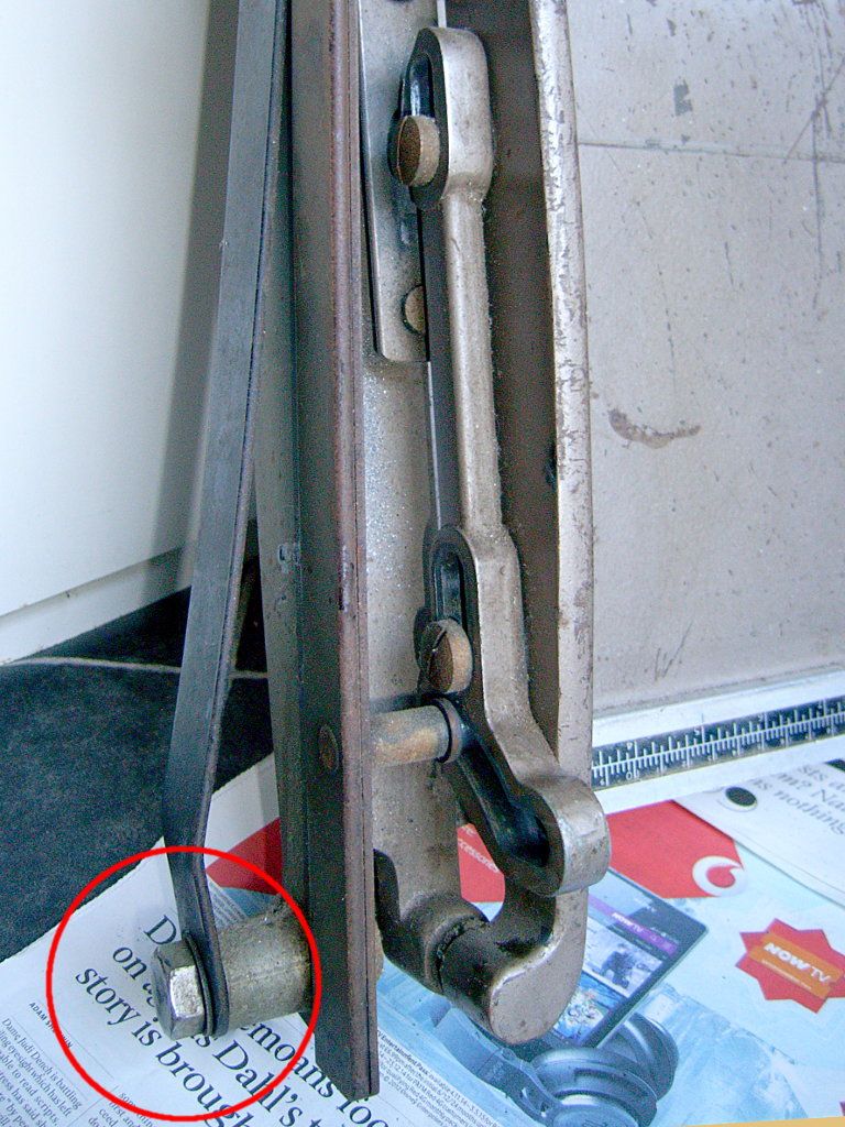

      I realise this is perhaps not the best place to ask, seeing as my project is not a model, but this forum keeps coming up in my searches for answers to various engineering questions, and I haven't been able to find a better UK based forum for this type of question. Apologies beforehand if I'm out of order!
      I recently bought an old Gestetner paper guillotine with the intention of restoring it to working order. It's a beautifully made cast iron piece of the highest quality and seems well worth the effort. After disassembly I noticed that the main bolt which attaches the guillotine blade to the body, and upon which the blade swivels, is pretty badly worn and could do with being replaced. So I started looking around for a UK source for good quality bolts but only ended up confused and disappointed; most of what I can find are very low quality zinc plated bolts, poorly finished and probably not very wear resistant – nothing like the nice old one I need to replace. It seems cheap Chinese junk has taken over also the fastener market The bolt is a 1/2" diameter, with a 1" threaded section, probably UNC, possibly BSW(?). Since it acts as the hinge for the blade it needs to have a smooth shoulder (also 1/2" dia) and be made from some wear resistant alloy. Here are a few photos:
      Does anyone here know where I might find such a beast?

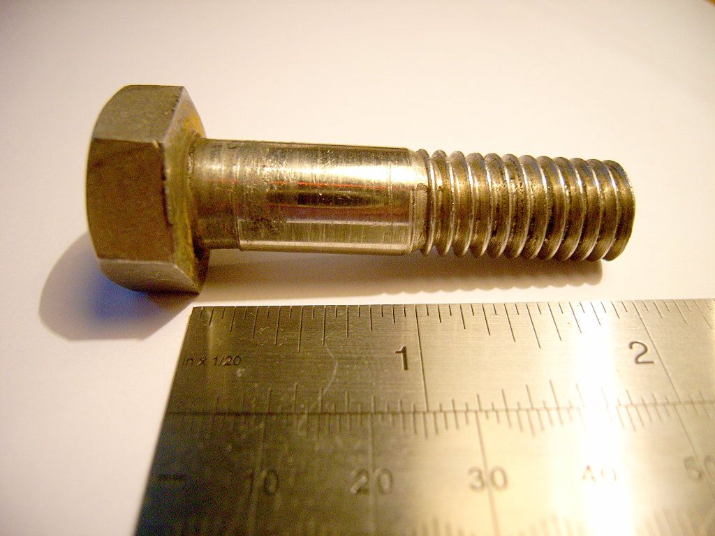

        Looking for a replacement 1/2″ x 2″ bolt w. shoulder

            Raking around in my box of odd nuts and bolts I've found a 1/2" whit bolt and nut. Overall length including head is 2.4", threaded portion is 1.1" and unthreaded shoulder is 0.95" long x 0.495" dia. Spanner size 7/16 whit. It's not new but in good condition and would do the job if you can't get a new one. Let me know if it's any use.

              Hi Bent Spanner, my guess is that the bolt will be either BSW or BSF and it looks to be a standard bolt rather than a set screw. Set screws have the thread up to the head and bolts have a plain section. Gestetner were in business in the UK during the last century so pretty sure to be a UK thread ?
              It would be best to use a thread TPI gauge to ascertain the pitch and measure the A/F of the hexagon, if it is. a standard bolt any good engineering supply house should be able to supply what you need.

                @Frank: Many thanks, found Essex Fasteners at Orbital HS – apparently they've merged. There is no on-line product list (or shopping) but there is a PDF which at least shows the ranges they carry. You were indeed right to say "they carry a lot of weird stuff" – they seem to have almost every type of fastener under the sun! I shall contact them on Monday and see what they say.
                @Roger: That's a very kind offer, thank you! It sounds like the bolt you found is very nearly a perfect match to what I'm looking for, it's only the shoulder that sounds like it could be a problem (see also below); on the one I have the shoulder is a tiny fraction over 1/2". I confess I don't understand the Imperial vernier on my calipers (I was born metric!) but an exact measurement is 12.8mm (or 0.504 inches) – it's likely that 0.495" would leave enough of a gap that the blade will wobble, doubly so since I'm measuring a worn bolt! I'll certainly keep your offer in mind though!
                @John: Ah yes, I should have made my uncertainty about the threading clearer; I at first counted 13 threads / inch and assumed it was a UNC thread, but checking again it's actually only 12, which matches BSW. This also makes sense as, hidden between two screwed together parts, I found a "Made in England" stamp I should get a set of gauges really; this isn't the first time I've been confused over a thread! Thanks for your suggestions, and for pointing me in the right direction, thread wise.

                              Cromwell tools have 1/2" bsw bolts listed in both their on/line and paper catalogues. The on/line pricing shows price/100 but the "add to basket" button asks how many bolts you want and will accept an order for one – don't be too shocked at the price though.

                                Hi bentspanner, I have just had a rootle in my 1/2" BSW tin and found some bolts to your specification apart from the plain section diameter. All I have miked up come out at 2.5 to 3 thou down on the nominal 1/2" diameter. I would bet this is industry standard. I have some cap screws too, these are even less on the plain part. Could you make a shim steel sleeve to take up the slack, if any? It would be OK for hand operation surely.You are welcome to one, pm me with your details. Chris Gunn

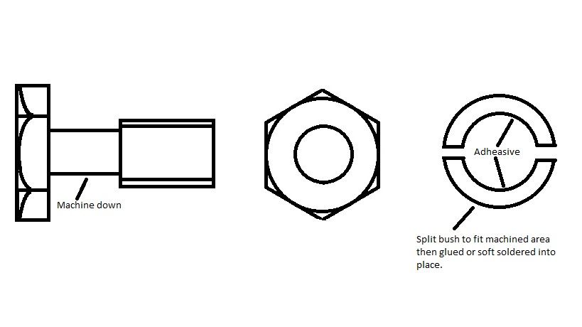

                                    As an extreme solution you could build up the old bolt with weld and then r machine down to the size you want. Another solution is to turn down the damaged area and then make a split bush to go onto the straight bit this could be soft soldered and then turned true. Whilst machining the bolt, re face the inside of the bolt head until cleaned up and fit a washer.
                                    Someone local might be able to do that for you if you don't have the kit.
                                    Done a quick drawing for you if it's any help. Not dimensioned though.bolt repair.jpg

                                        The original bolt looks like brass or similar softish metal. It may be designed so that wear in this soft component prevents wear in the parts which pivot on the bolt. That would prevent a much more awkward (and potentially expensive) repair or replacement of those other parts. If it was me, I would replace the bolt with one of a similar material.
                                        Marcus
                                        #170123
                                          Posted by Marcus Bowman on 19/11/2014 23:15:13:
                                          Marcus,
                                          I suspect that's just because the colour temperature of the lighting is "warm"
                                          … compare the first image, which shows the bolt in-situ.

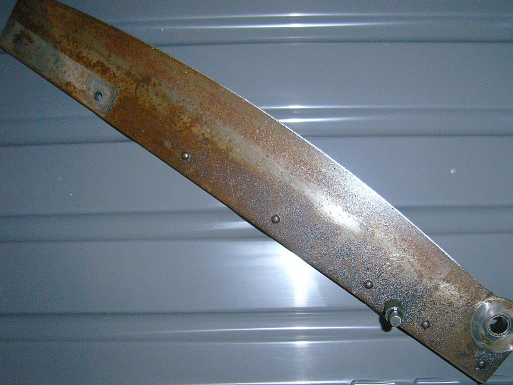

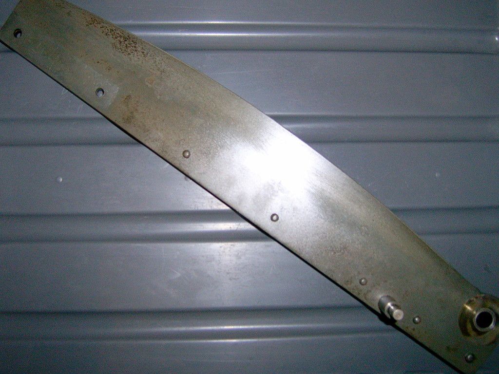

                                            Golly, thanks a bunch for all the interesting comments & suggestions – I knew this would be a good forum! I'll try to respond to each of the points made, but first I have to share these "before and after" photos of the guillotine blade:
                                            Before:
                                            After:
                                            Pretty amazing, don't you think? That's after degreasing and soaking in oxalic acid for two hours (~400g oxalic acid ~5L warm water). It actually looks even better in real life; the bits of oxide left are not "rust" but black oxide, which oxalic acid won't remove (I seem to have a lot of colour balance problems with my photos!). I may try to buff these out, but I'm not too fussed. The other side of the blade looks even better, almost like new, and it still has a good edge despite being 50-odd years old. That said, if I wanted to sharpen the blade, does anyone have any suggestions how to go about it? Might be best to take it to a company that specialises in sharpening tools?

                                              If you buff it up. do so before you have it sharpened as this could slightly dull the cutting edge by rounding it. There seems to be a problem with the drawing I uploaded, regarding repairing the bolt, earlier so I'm trying again now.bolt repair.jpg

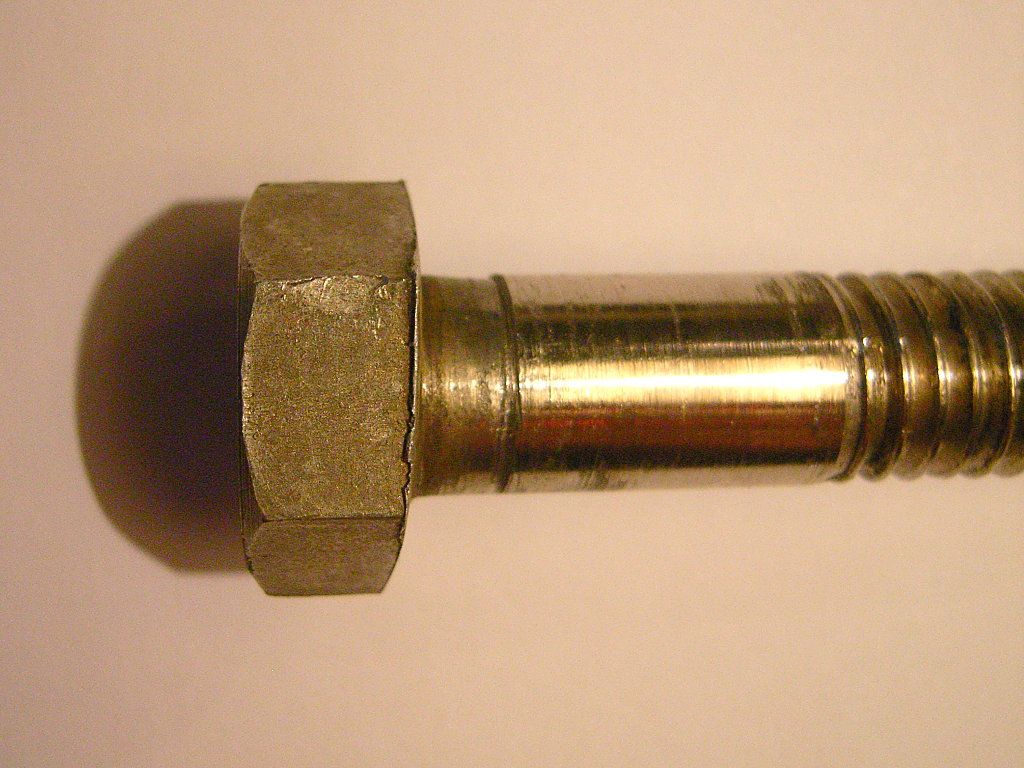

                                                @Marcus: Michael is correct, it's just the colour balance that is off (I took the photo under my desklamp, which has a tungsten bulb). The bolt is most definitely steel.
                                                @Neil & @mechman48: You are both right, the beefy leaf spring (350mm long, 35mm wide, 3mm thick) is there to hold the blade firmly against the shearing edge on the platform. Again, the angle of the blade is the critical paramater; if it doesn't pass the edge at exactly 90&#deg; the paper will be sqeezed and folded instead of neatly cut (and angle it the other way and it will hit the platform!). So the bolt has three jobs: 1) to give the blade a point to swivel around 2) to keep the blade laterally in position 3) to maintain the correct blade angle. Radial position is not critical; a small amount of radial movement won't affect the cutting action.
                                                Now the main problem with the worn bolt is that the head has been thinned on one side from friction against the leaf spring – this means it is unable to force the end of the spring flat, which severly reduces the amount of pressure the spring exerts on the other end. The base of the spring needs to be forced flat against the bearing sleeve on the blade to do its job properly. If I was to reuse the bolt I would have to find some way to make the underside of the head flat, but I only have a small bench grinder and an angle grinder – I doubt I would be able to get a satisfactory result with either!
                                                @Bodgit: Thanks for the suggestion, but I don't have oxy/acetylene gear, just a small propane torch, so I don't think I can braze steel. Even if I could, I don't have a lathe either, so wouldn't be able to turn the bolt afterwards.

                                                    Bent spanner, If you want my bolt, I can probably find a piece of shim to take up the 6 thou or so on the diameter.
