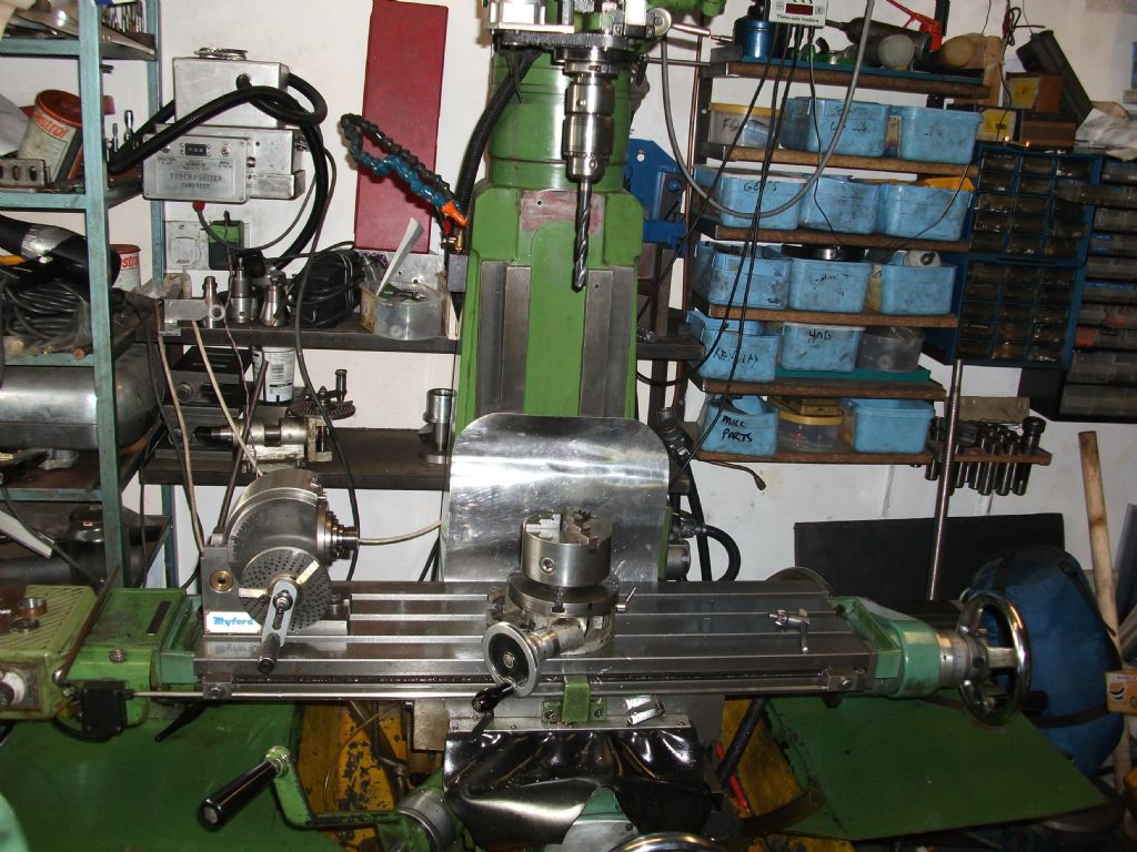

            I have had one of these for 20 + years ,been a very good machine.Modified
            mine to part cnc use ,raising block seen here in the photo allows
            24 inches maximum spindle nose to table and a two part knee
            leadscrew will bring the table up to the spindle nose.The raising block
            has an unbroken tee slot and allows the the head to be swung around
            as in this instance to mount an auxiliary spindle to cut a rack.
            More info at lathes.co.uk look up EME millers.

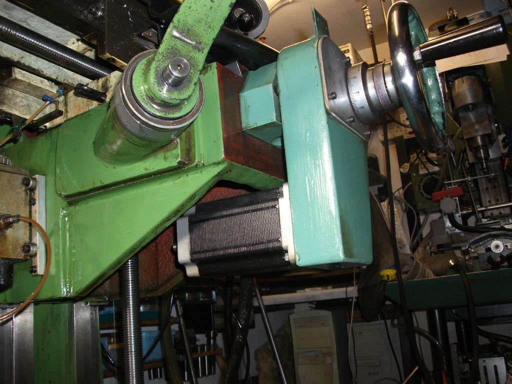

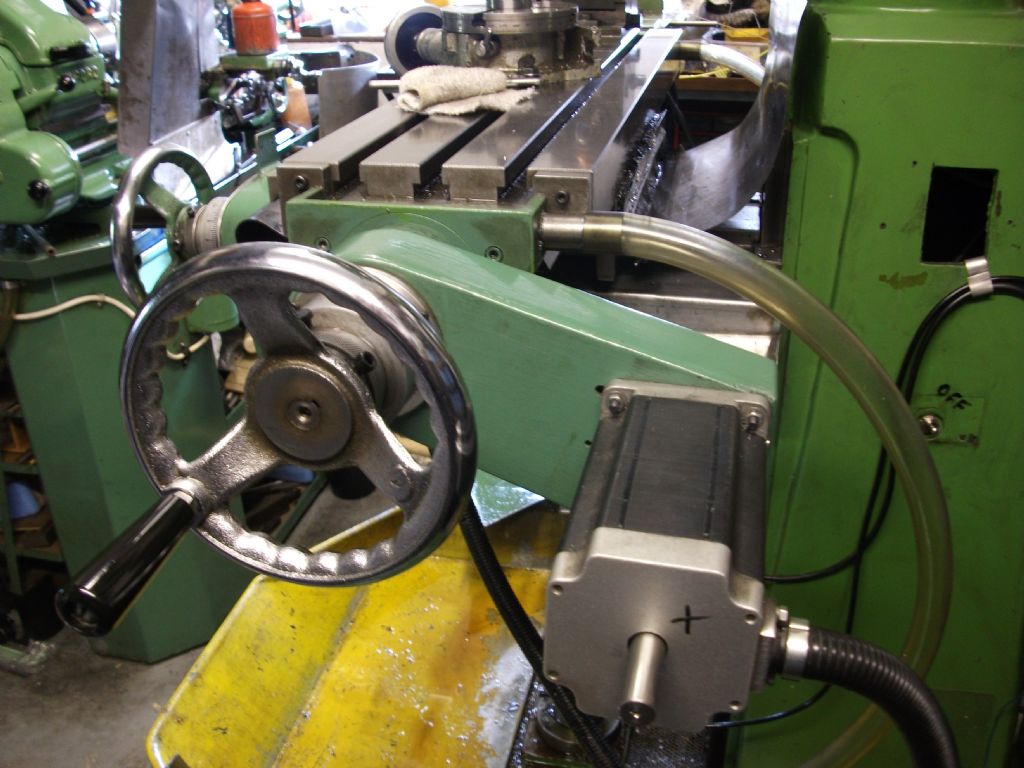

                            Just some more photo's of the A2F,with the table right down there is
                            plenty of daylight under the drill bit ,the raising block is about 4 1/2 inches.
                            When i converted the machine to part cnc i made some new lead screws
                            and adjustable backlash nuts and gained a little more table travel to
                            21 3/4 inch and just over 8 1/4 on the y axis. The original machine nuts
                            are quite poorly made and fixed .The stepper motors came from Arc Euro
                            trade triple stack 34's 14 mm shaft 5 volt 6.5 Nm ,they don't sell these
                            now.The two photo's show the y axis motor tucked under the knee casting,
                            extending the hand wheel out it fouls the rise and fall handle on the left,the
                            hand wheel was moved to the right and drives the lead screw through a
                            pair of gears as i had made some lead screws i could use a right hand screw
                            for this .The stepper motor drives the lead screw via a toothed belt.
                            It is an imperial machine and the lead screws are 1/8 pitch the tooth
                            belt pulleys reduce this to .100 inch pitch.Photo of the x axis motor
                            both drive through 3/8 L size belts.The brackets are fabricated from
                            1/8 steel sheet .

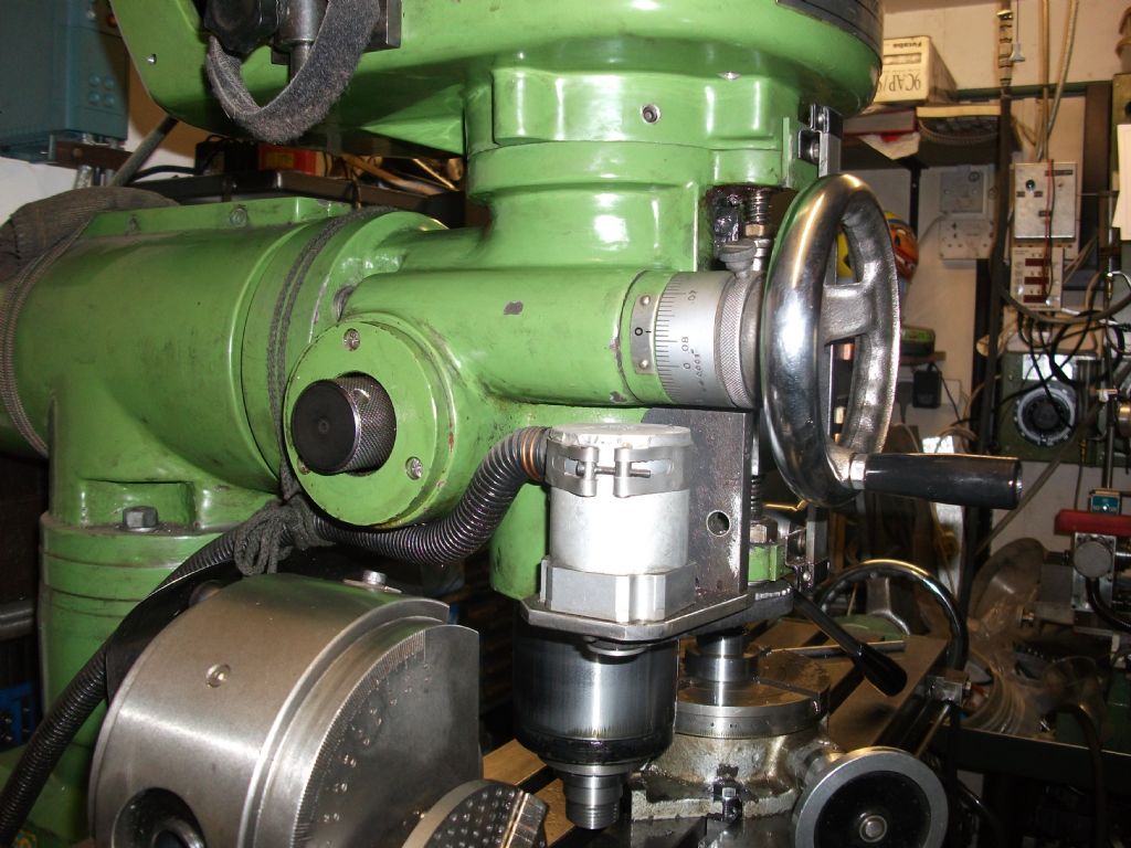

                                The Z axis stepper motor drives the quill on the machine ,only a small
                                stepper motor was used have no details on this as it was a scrap box
                                part.The motor was mounted to keep within the profile of the head so
                                the head can still be if needed tilted 90 deg without fouling.
                                The lead screw seen here fits in place of the drill depth stop screw
                                and nut assembly which was useless item anyway,the nut has some anti
                                backlash adjustments.
                                The original block for the drill stop is replaced by a T shaped part that
                                has a horizontal dovetail and fixes to the quill using the same 2 holes,
                                a split clamp slides apart on the dovetail,when required for cnc operation
                                the clamp is positioned around the nut and secured with 2 m4 screws.

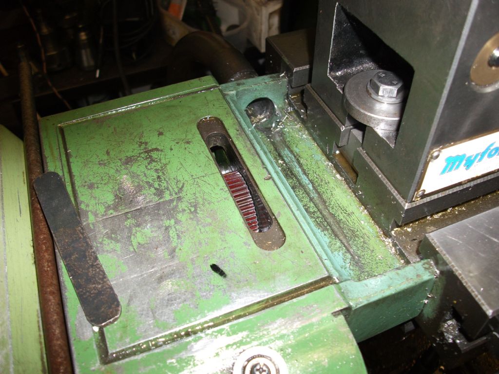

                                Two more photo's first one showing the underside of the table powerdrive,
                                i made a bracket to fit this to the end of the table and included a geared
                                take off ,a clutch can disengage the drive from the lead screw so the power
                                take off can be used with or without the lead screw engaged.View above
                                the gear output from the drive,one of those things done a long time ago
                                that was never taken to completion ,the cnc operations make this redundant
                                now.
