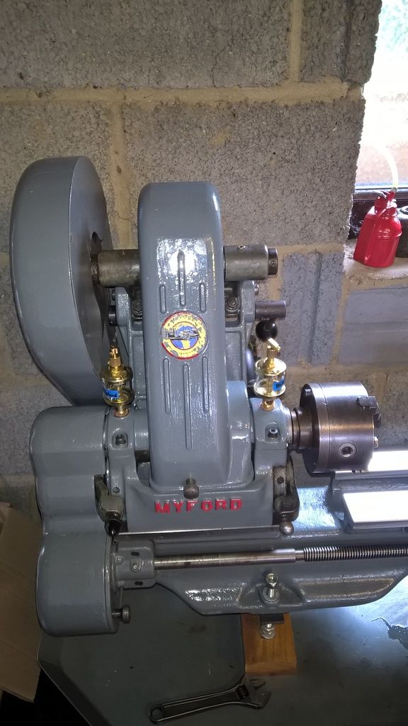

                            So here is what has been done:
                            Strip stand, sand, remove nails from wood, sand some more, varnish with Yacht Varnish
                            Paint Metal frame of stand
                            Built mount for ML7 to fit onto the stand
                            Fit Lathe bed, leveling and made sure it was on flat ground
                            Re assembled head stock, everying went together well. Found the shims on the bearing to be not myford origionals. Got some from Myford – bearings are in very good condition, hopefully nothing to concern here.
                            Gear box when on nicely, I did find I need to replace two gears, one just worn out, the other had a missing tooth.
                            Replaced the oilders for bearing housing – mine were cracked and no good
                            Now to the saddle, this required a new felt from myford and sadly one of the slides needed a new screw as it was bent. It must have been thumped at some point.
                            Afew cosmetic bits were pickup up from ebay on the cheap.
                            Right, now the big problem landed. I fitted new shims from Myford under the saddle strips and found LOADS of play between the saddle and the lathe bed. Great. Tweek the saddle up and down the bed and, as is often typics on a 1950s machine, I found it slack with play nearer the chuck end and very tight thing at the other end. No matter how much tweeking could get a happy medium. The simple fact was my bed was worn. Then I looked at the saddle underside and sadle strips, they too were rather worn. Taking measurements confirmed this.
                            Only one option, Re grind the bed, sadle and sadle strips.
                            So lathe was almost finished apart from a few bits. The next step was to find some one who could re grid it.
                            I first called Myford and they quoted a small fortune, which to be frank was an astronomical amount. Far exceeding twice what I paid for the entire machine – just for the re grind. So that was out as an option.
                            Then I left a post on this forum asking for help. This worked and I found Slideway Service et al, who can Re grid my machine.
                            The one issue is the waiting list. There was a minimum 8 weeks wait before even sending it. The price is VERY reasonable on quote.
                            I have now, yet again, totally stripped the machine, got a pallet, and now I have to send it away to the re grinding hospital. With any luck this will be in the next two weeks.
                            So that is where I am with this ML7, I'm hoping no more unknown 'major' jobs will appear, but you never know.
                            It has been fun, frustrating, I've learn't LOADS, absolutly LOADS. Hopefully more to come.

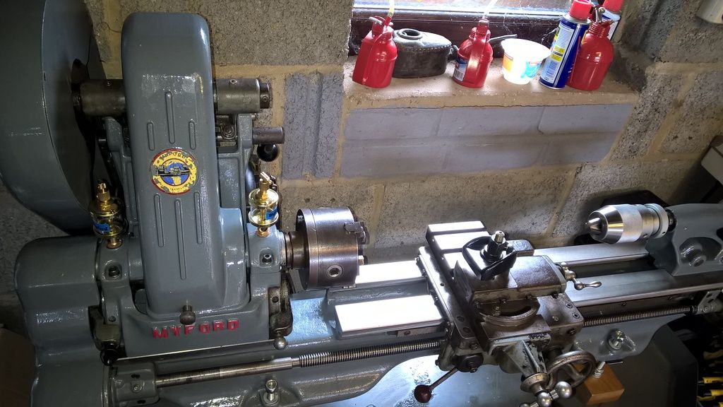

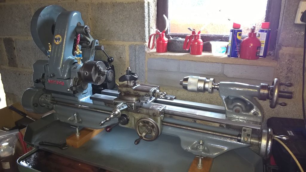

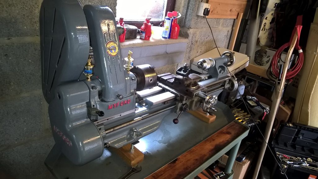

                                      #248302
                                      AJC
                                        @ajc
                                        New felt on the Saddle
                                        Fitting the saddle
                                        Saddle finished
                                        Lead screw gears
                                        Motor ready to go on
                                        Last few bits now
                                        Covers added
                                        This is just about it
                                        Stuff I replaced:
                                        • Oilers
                                        • Felt
                                        • Belt covers (cheap ebay)
                                        • One gear (tooth missing)
                                        • Shims (on main bearing)
                                        • Belts
                                        • A few bolts here and there
                                        • Lead screw bracket assembly the thread was gone (ebay)
                                        Still to do:
                                        Belt covers need a spacer and new bolt. I'll probably make the spacer.
                                        Fully oil the machine and then line up everything with some test cuts.
                                        Conclusions:
                                        So that's it. Just about finished, it is looking good. After I added it all up, it has cost less than a new Chinese machine and I've learn't lots about the machine. It has taken time. The serial number says it was made in 1950, so hopefully it will still have a long life.
                                        If you are thinking about buying an ebay machine, take your time and see how much they are currently going for, don't bid on the first machine. Don't buy on a weekend evening ending auction – the price will be stupid money as everyone is at home bidding against you – wait for a mid week ending auction.
                                        Don't be worried about it being worn out too much, you can get the bed, saddle, slides etc re ground without too many issues – but there is a MASSIVE waiting list as these companies are very busy (shop around again someone might do you a great deal). And don't worry about dirt – elbow grease is good for you!
                                        You can get parts, Myford have quite a lot in stock, ebay does deliver as well if you are happy to wait for a part to come along. Phone around everyone – there are lots of people with bits.
                                        It will take 10 times longer than you think – I got this machine in July 2014. I have a family, work full time, have moved house and have a million other hobbies to take my time.
                                        If you just want to get building something then buy one of the fantastic new machines which are available, mainly from China. Many of the suppliers advertise on this site. I have spoken to some for advice along the way and they are always incredibly helpful, often even when I haven't bought anything, a total credit to this hobby.
                                        If you can go and see a machine before you buy – do. Move the slides back and forth, check if it is tight at each end and loose/slack in the middle, this could be wear. Check all slides as well.
                                        This was sent to me about measuring the wear, though it might be useful:
                                        To check the bed, measure the width across the front shear (if your lathe is a narrow guide) along its length and see what sort of deviation you have.
                                        Also measure the thickness of the front shear along the length of the bed (nominal 0.500" and again make a note of any deviation and then do the same with the rear shear.
                                        Preferably you don't want any deviation at all over the width of the shears but 0.001" at the most
                                        The thickness of the shears aren't as critical but you don't want any more than 0.002" max.
                                        I hope this was interesting, all I need to do now is make something…..
