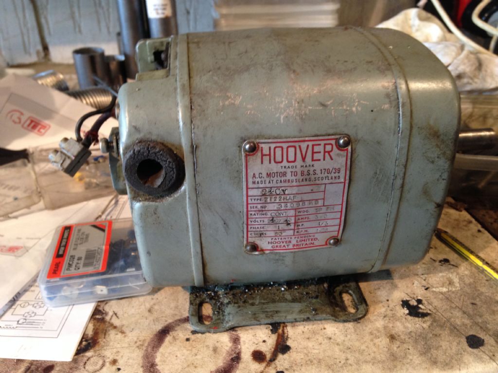

      As my Father spoke to Myford I can't comment on exactly what was said but apparently they offered no help, other than providing a wiring diagram the same as the one on the motor.
      Thanks to the information provided on here I know understand how it should be wired, but really that should have come from Myford themselves.
      It appears that the blue wire needs to be extended out of the motor and to be wired to the wiper terminal on the reversing switch, with the red and brown wires connected to the remaining terminals.
      I will have another look at the switch to see if it is an original Myford item, and to see whether it can be wired to achieve this.
      Thanks for all your help so far.

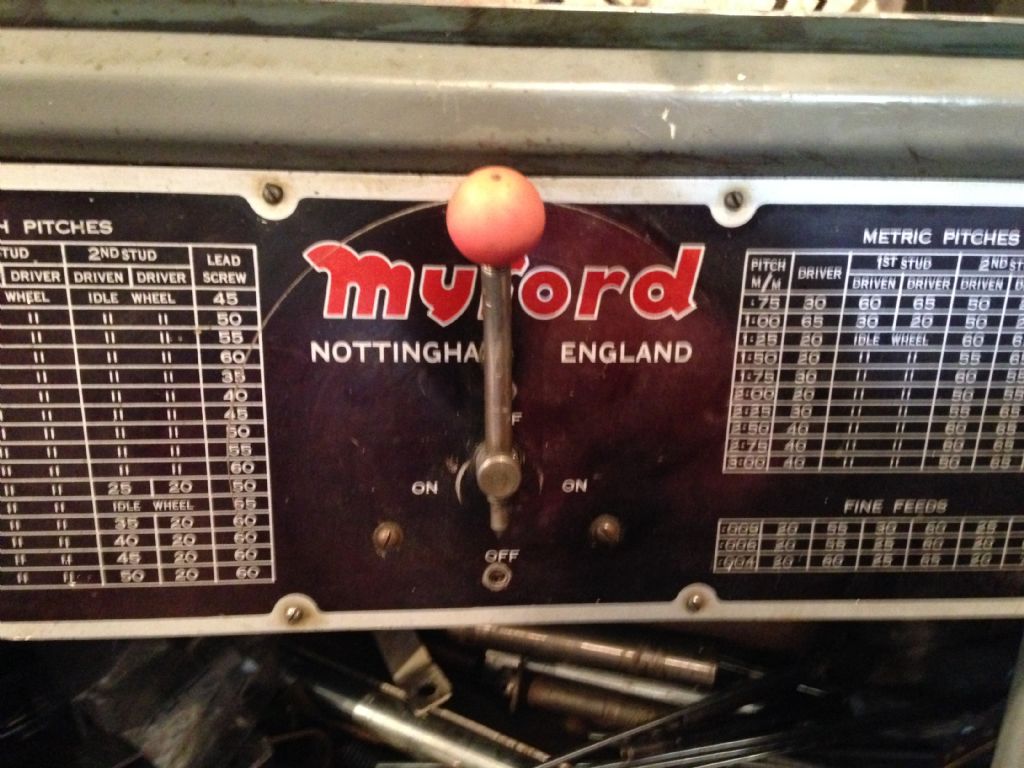

                    Now my Father is back we have had a chance to have a look at the new motor and the existing switching arrangement.
                    We got the new motor running CCW by connecting the live and neutral to the line connections as suggested, and then switched the red and black wires over to get it running CW.
                    The old motor was wired with a permanent live and a neutral and also had a switched live feed going to either the red or black wires on the terminal block to achieve forward or reverse.
                    There is a junction box at the back of the lathe, which needs further investigation, and there are 6 connections to the reversing switch, which is shown in a photo below. We need to remove the switch and test the contact arrangements.
                    The new motor seems to differ, in that it tries to run with the internal black and red wires disconnected, so even if the reversing switch can be used I think an additional on/off switch will also be required.
                    I'll post again when I have more information.
                    Reversing switch.
                    Motor connections.
                    Motor identification plate.
