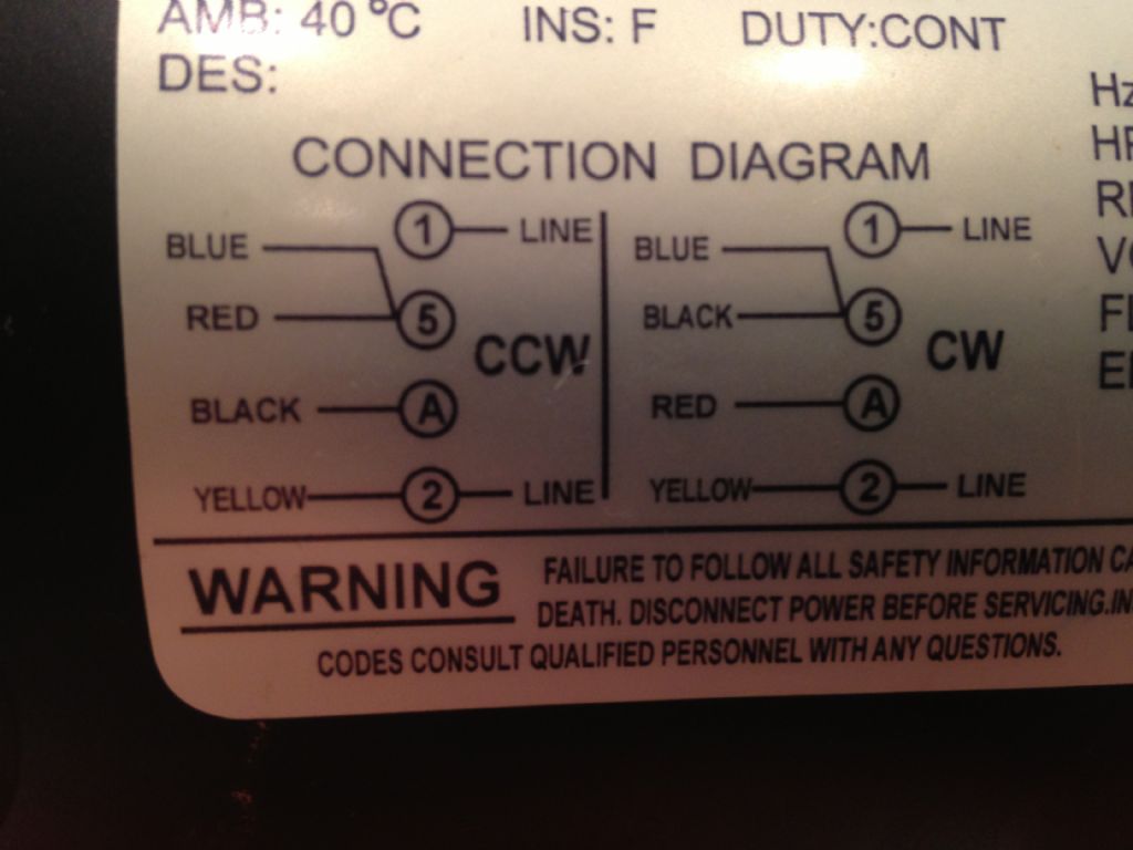

        My Father has a Myford ML7 lathe and he has bought a replacement Single
        Phase 3/4 HP motor from Myford but is having difficulty with wiring it
        in.
        The motor has numbered connection points, and it came with a wiring
        diagram but nothing seems to relate to original connections, and the
        wiring diagram is useless.
        I am reasonably good with electrics, and he has had a friend who is an
        electrician look at it but neither of us can work it out. Myford are
        being very unhelpful, which is very poor as it cost nearly £200-00.
        Could you help with which wires should be connected to which terminals?
        The lathe has its original reversing switch.
        Many thanks,
        Glen.

                                    Glen Morgan 1
                                      @glenmorgan1
                                      Right then chaps.
                                      At the bottom of this post is a photo of the wiring diagram on the motor which is a TECTOP TEC, made in China about 11 years ago according to the date on the label, so hardly new!
                                      The wires connected to the old motor were as follows: –
                                      Red – permanent live.
                                      Yellow – live from direction switch 1.
                                      Green – live from direction switch 2.
                                      Blue – neutral.
                                      Obviously the colour codes for the wires don't correspond but if terminals 5 and A are responsible for reversing the direction, how can the wires actually be physically switched over as shown.
                                      Also what is the blue wire supposed to be given that is also connected to terminal 5?
                                      Yellow must be a permanent live or neutral.
                                      Hope one of you can make sense of it.
                                      Glen.

                                        Posted by Glen Morgan 1 on 04/05/2014 00:09:14:
                                        Connect the incoming supply of live and neutral to 1 & 2 – e.g. live to 1 & neutral to 2 (or vise versa)
                                        The rotation is then determined by which colours are bonded together on terminal 5
                                        Don't forget the earth to the frame. They often omit earth connections on diagrams for clarity and presume you will automatically connect it.
                                        Get it running in one direction or the other first to check you have not 'butchered' the motor (unlikely but possible) by previous wrong connection.
                                        Once you have done this let us know and we can then sort out the reversing issue by use of a multi pole rotary switch by altering the connection permitations that configure 5 & A
                                        Have you got a multi meter or a continuity tester.???? – You will probably need one to 'bell out' the open and closed sides of the switch.
                                        Nick

                                            Phil Whitley
                                              @philwhitley94135
                                              Ok, single phase motor, to reverse you need to reverse the polarity of the start winding. The start winding is the red and black wires. You need to disconnect the red and black from the terminals and extend the two wires to the existing reversing switch, bring another two wires back from the reversing switch and connect them to terminals 5 and A, then wire the reversing switch so that it reverses the connections. I can't tell you how to do that untill I have a wiring diagram of the switch as I am not familiar with the Dewhurst type switches. If you can post it up I can work it out.
                                              Hindsight is a wonderful thing! it probably would have been cheaper to rewind the old motor, epecially seeing as you have been ripped for the new one! I recently bought a recon motor for my compressor from a local rewinder for £60, single phase 3hp. Never mind, you have bought it now, go with it.
                                              Phil

                                                There are a few possibilities. I think the reason Nick asks if you have a multimeter is to be able to identify how the motor is wired internally. (I would have asked the same question.) It may be possible to change the way the motor is wired internally to make it work. Another option would require one or two extra conductors in the cable between the motor and the dewhurst switch and also some links changing on the switch. Resorting to using an extra reversing switch would be the last resort. The reason Nick is tying to find out roughly where you live is because it is so much easier for someone with some electrical knowledge so sort out the problem when they can see it first hand. There was a similar problem earlier this year that took a long time to sort out which could have been sorted in a few minutes by someone with direct access to the machine. See this thread. Does your new motor have any capacitors attached to it ?. (There may be either none , one or two.)
                                                Les.
