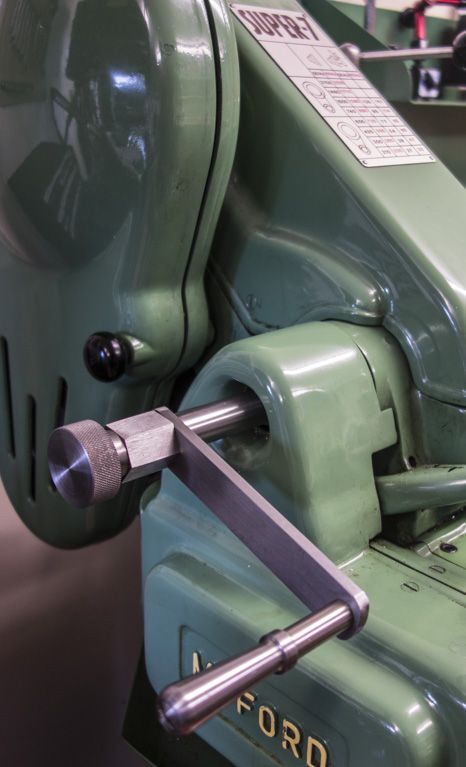

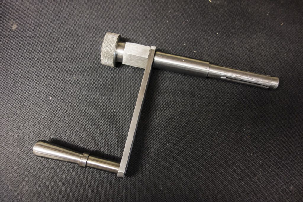

                      Whilst poking around, I came across references to mandrel handles, whereby one can turn the lathe by hand and gain increased control, especially when cutting to a butt, as I'm sure that everybody here but myself knew! I have ordered a Hemingway kit version, and wonder whether anybody has experience of that?

                      #344226
                      NJH
                        @njh
                        Hi Myford Mann
                        Not too hard to make yourself…
                        Norman
                        #344227
                        Brian Wood
                          @brianwood45127
                          Hello Myford Mann
                          Hemingway make decent kits, I'm sure it will do just what you want
                          A word of warning though. MOST EMPHATICALLY take precautions to either remove it after use or disable the motor power until you have done so
                          I very foolishly got sidetracked once and flashed up the lathe with my home made version in place and got away with it by using my panic rail across the front of the lathe that is my emergency stop; that was definitely not an occasion to reach over the lathe to the DOL starter. I know of another case which thrashed the change wheel cover to fragments before it could be stopped.
                          I now fit a cover to the ON button when using mine.
                          I'm glad to hear you triumphed with your metric thread in the end, I take it the nut fitted as well!
                          Regards
                          Brian
