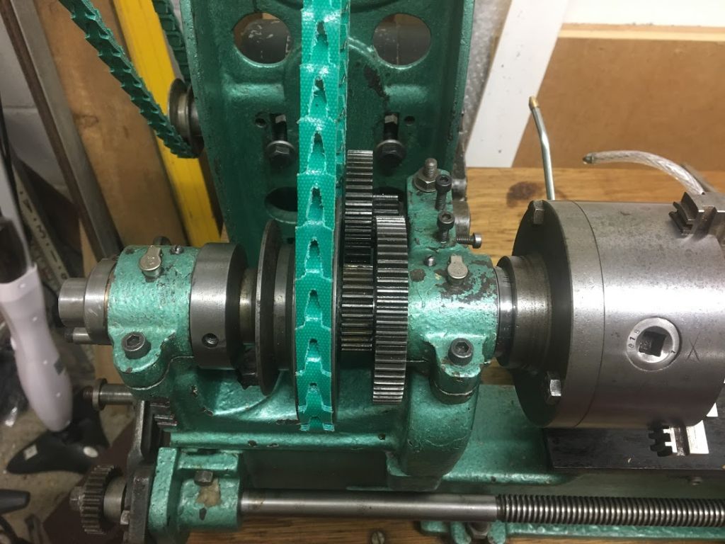

      Hi again all,
      Last night I reassembled my headstock, complete with new thrust bearing (sadly of much worse quality than the SKF one which did not fit – but it was the best I could find) and some new power-twist belts for ease of adjustment.
      When I first turned on the lathe there was a bit of a knocking sound coming from the headstock, once per revolution. I double-checked the bearing tightness, which was snug but not over-tight, and decided to run the motor for a little bit to see if it resulted in any heat. After 20 minutes the sound lessened a bit and the bearings were only very slightly warm to the touch.
      I then took some light cuts on aluminium, brass and then steel. Trying to part the aluminium/steel was unpleasant, although less chattery than previously. I was able to part the brass very cleanly.
      There is a bit of slop in the handwheels and the backgear assembly that I am going to take out using fiber washers. I think this will help dampen the vibrations and make using the lathe a little more pleasant. I also need to thoroughly examine the headstock to determine where the noise is coming from – it seems as though it's coming from the chuck-side bearing but there is a chance it's the new belt.
      I've attached a video and I wonder if someone is able to give their opinion on the noise?

                    Hi Brian, thanks again for your response.
                    I've just had a look at the lathe. Running it with slack belts results in a lot of noise from the motor and I think that may be the cause of the sound. I've attached a video to illustrate. It will be interesting to see how quietly it runs with the new motor/VFD.
                    I've not indicated on the vertical register as, honestly, I didn't think to. It seems obvious now though. I'll do that soon and report back on how true it is. How would one reinstall the spindle to ensure it is straight? the fit was so snug that I can't imagine how it would have been pulled off true.
                    I also took the time to tighten up the nut securing the backgear assembly. This has a bit of play in it and would rattle under vibration. There is a bolt in the casting that would prevent accidental engagement but, to be on the safe side, and to keep things quiet, I snugged the nut to lock it in place. Thanks Jon, for that.
                    I also re-tightened the pulley assembly and the bull wheel via their grub screws. As you said, they had already come a bit loose. I'll have to watch that I adjust them regularly.
                    Another benefit of having locked the back gear via the nut is that it will force me to think before I engage it. Hopefully this will prevent any unfortunate accidents such as forgetting to remove the grub screw from the pulley assembly!
                    Here is a photo of the clean, adjusted headstock for your enjoyment.
                    As an aside, I am enjoying the new belts. They were a bit fiddly to install but it's nice to know I can remove them without having to touch the spindle.
                    I may end up removing the spindle to perform the test that you mention Brian (although it will require finding/borrowing/buying some vee-blocks), but until then I'm happy to leave the spindle in situ. I'm still hopeful that a rear tool post and some more dampening of vibrations will make using the lathe even more pleasant.
                    I've ordered a pair of 20T wheels from Myford, as these were missing from my set, and I'll try to set up the fine-feed that you mentioned earlier in this thread too. To clarify, does 20 : 60/20 : 65/20 : 60 mean the 20T on the spindle, 60T with a 20T compound on the 1st stud, 65T with a 20T compound on the 2nd stud, then 60T on the leadscrew? I apologise if it's a basic question but I've not had to use gearing/drive chain notation before.
                    Kind regards all, and have a nice weekend.
