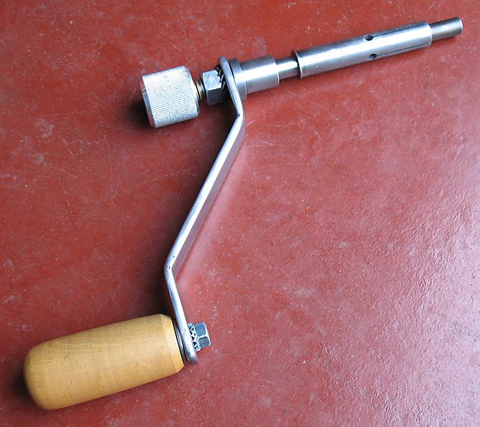

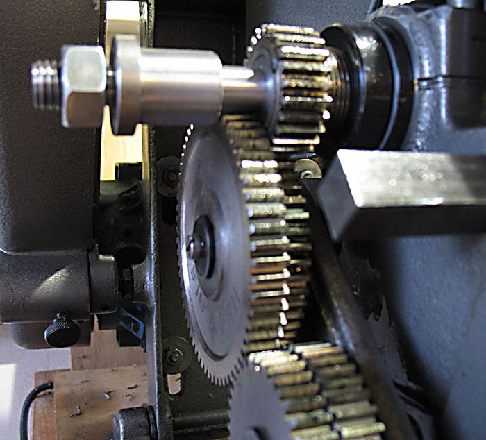

      Having no spindle crank, I finally decided to get around to making one. The design I'm using is to be found online at 'Instructables Workshop', created by qthurtle. The photos and design plans of same are to be found at this link: ML10 Lathe Spindle Handle

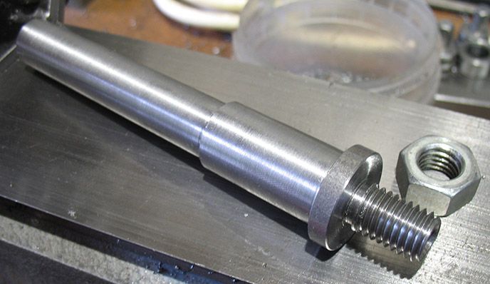

      Well, the project was coming along swimmingly, although the threading of the end for the 12mm nut was a bit of a fuss. I mean, I didn't have the lathe spindle handle that would have made my life easier here, so I ended up grabbing and turning the chuck back and forth by hand (like a rat on a treadmill) for every pass (ouch!). angry
      Here is the finished shaft of the spindle crank, just ready for slitting…
      …and I was just about to do that when I had a sudden inspiration to try slipping the finished shaft into the rear end of the main spindle for a test fit. And that's when it hit me...
      … It wouldn't work!!

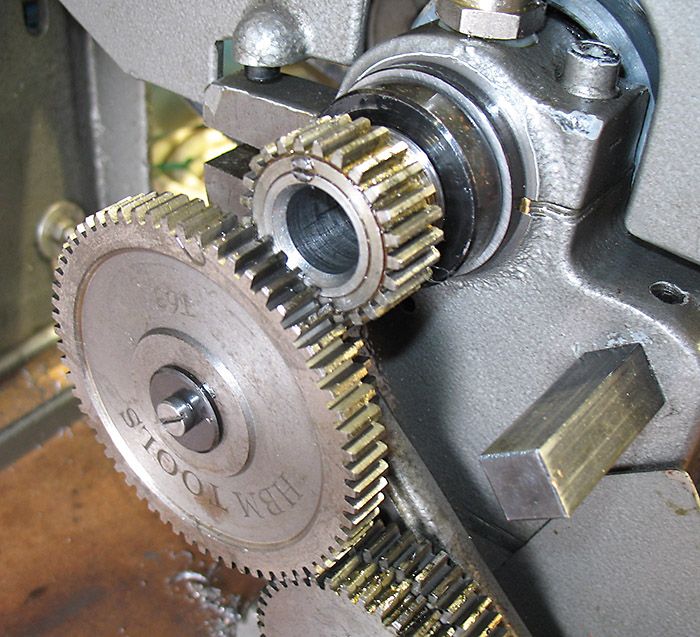

      The reason should be obvious from the photo below.
      The ML10 does not enjoy a built-in tumble reverse arrangement like the larger lathes made by Myford. As such, the gears on the banjo engage the spindle gear directly and – as should be obvious – in those configurations where the outboard driver gear on the first group is larger than the driven gear of that same group, the teeth of that driver gear can intrude into the space of the spindle through hole. This is almost never the case with the gear arrangements for cutting imperial threads, but for metric… OH BOY!
      What you see in the photo above is the first stage gear arrangement for cutting the 1.75 mm stepping for a 12mm thread. The 25-tooth gear on the main spindle drives a 50-tooth gear which is paired with a 63-tooth gear to drive the next group. That 63-tooth gear intrudes almost 2mm into the spindle shaft opening… exactly where the shaft of that spindle crank would be.
      Fully 21 out of the possible 27 metric threading gear arrangements for the ML10 use exactly that same 50/63 gear group on the first stage. Like, OUCH!!!
      What this means is that the spindle crank as designed won't work for cutting metric threads. Why nobody has ever seen or mentioned this before is beyond me.
      However, I have already hit on a solution.

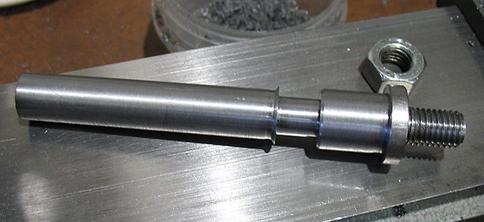

      In this photo you can see the alteration to the basic spindle shaft design. I turned a very small 45° shoulder to serve to locate and stop the shaft of the crank in the rear of the main lathe spindle. Behind that the shaft is turned down to a diameter of 12mm to allow it to clear the teeth of that 63-tooth driver gear.

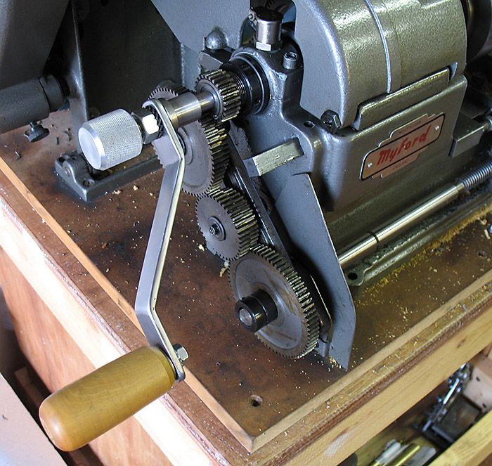

      And here a snapshot of the altered crank design in position. It clears that 63-tooth gear quite nicely.
      The only other problem is that when using metric threading arrangements with this crank design one must (A) first insert the spindle crank and lock it in place and only then (B) engage the gear train on the banjo and lock it into position. Because of this it will be impossible to have the protective gear cover in place. I don't see this as a major safety issue since the lathe will never be plugged in and under motor power when using the spindle crank.
      I'll report further on this when the project is finished. If anyone is interested I can post a measured drawing of the altered spindle.

          Does it matter if the 63T gear is meshed further down the train? If NO, move it and fit the Mandrel Handle as originally intended.

            Thanks for the suggestion. The Myford ML10 handbook doesn't seem to imply that the gears can be switched around on the banjo. However, it… might… be possible for some of the pitches. Guess I would have to play around with it and see.

                  That suggestion to place the larger gears further on down the train sounded so good to me, but…
                  …sadly, this doesn't work on the ML10. The quadrant just isn't long enough to accommodate the gears if the ordering is changed.

                    Elegant solution to a knotty problem there by necking down the spindle.
                    I would not worry about exposed gears etc either. Of far greater danger is the crank handle spinning around if it is left in situ and the lathe motor started up. And the guard makes no difference to that. I have seen some lathes in industry with a solid handwheel or disc used in place of the hand crank which is quite nice to use and can be left in situ while the lathe is run under power. I've been meaning to make one for my Myford for years. One day…

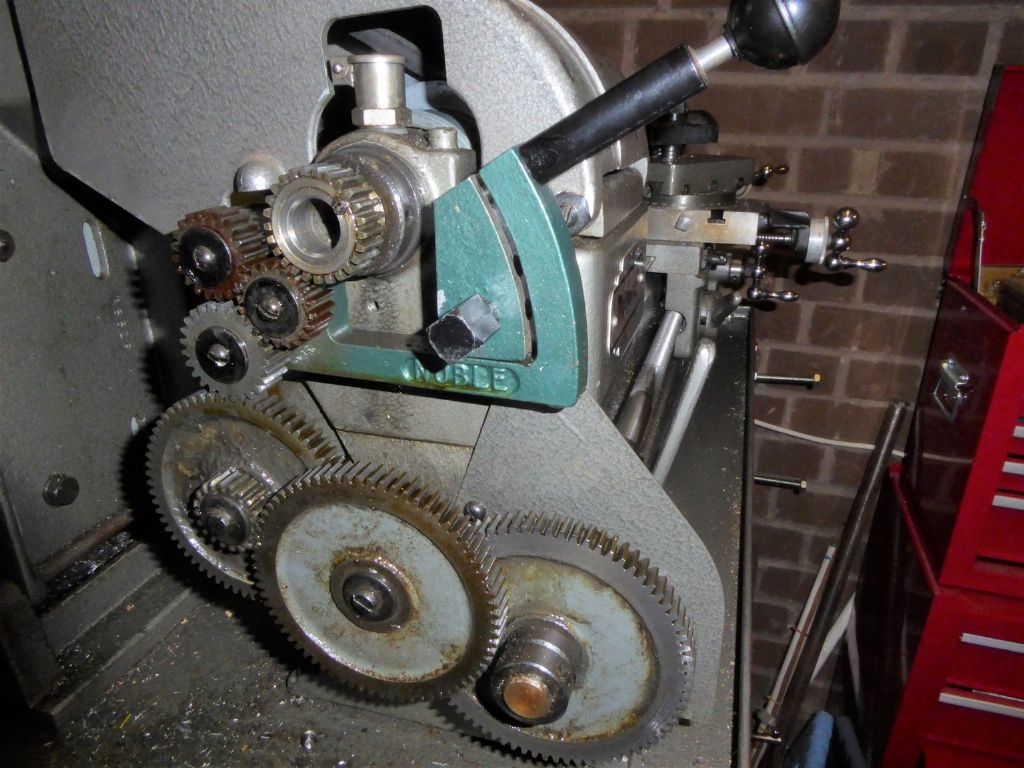

                                Just found this pic of an ML10 fitted with a reversing tumbler that moves the gears right out of the way of the main spindle. No idea if it is a Myford accessory or aftermarket. It looks to be a professional casting rather than home shopmade. Has the name Noble cast into it. But the principle is simple and could be easily replicated out of a piece of aluminium flat plate about 20mm thick or so and maybe using ML7 tumbler gears?

                                    Just finished up the spindle crank. laugh
                                    This is going to make threading work on the lathe a whole lot easier for me.
