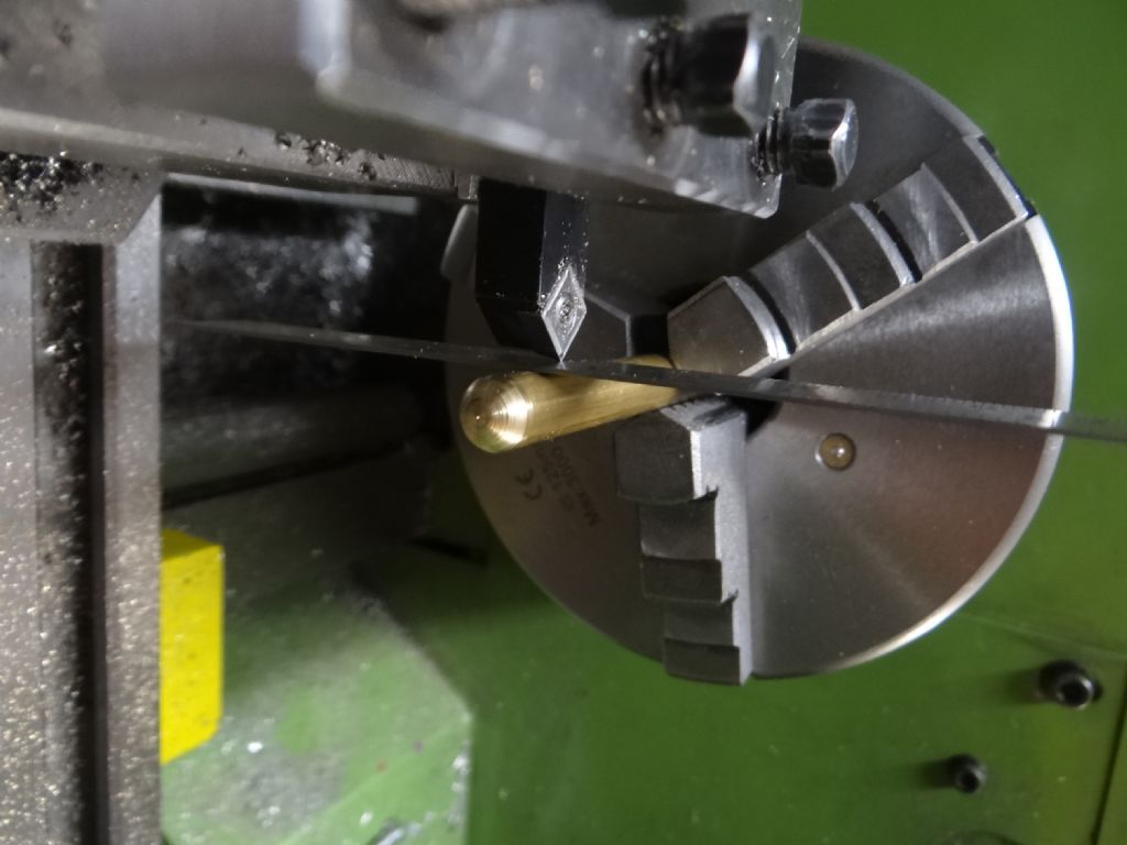

                              #310651
                                Thanks Dave and Brian; I am reassured about reamers!
                                Nige, the easiest way to set tool height is to nip a steel rule at its centre point vertically between the work and the tool point If the tool is too high, the top of the rule will lean over the work. If the tool is too low, the bottom of the rule will lean under the work. The tool is at the right height when the rule is truly vertical.
                                Although exaggerated by camera tilt, this tool is slightly high.
                                #310653
                                Russell Eberhardt
                                  @russelleberhardt48058
                                  Nice one Dave.
                                  If you use something thinner like a razor blade you will get more sensitivity. I use the same method for aligning the tailstock, pinching the blade between the headstock centre and the tailstock centre.
                                  Russell

                                    Posted by Russell Eberhardt on 06/08/2017 11:38:27:
                                    Nice one Dave.
                                    Russell
                                    Good point about sensitivity Russell: I should have mentioned that the steel rule in the photos is thinner than most. (One advantage of it being cheap!)
                                    I hadn't thought of using the same method for tailstock alignment using a pair of centres. Good idea!
                                    Thanks,
