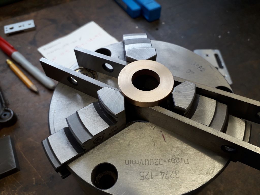

                  C J
                    @cj88518
                    I have a Myford Super 7 lathe and want to make a bush with a flange at one end from some 40mm round bar, and so hold this in a chuck and cut a 28mm hole through the centre with a boring bar.
                    The problem is, I want to pass the boring bar completely through the piece of bar but the centre hole of my 4" chuck is just 25mm
                    So does anyone know of a 4" or 5" chuck for the Super 7 which has a larger centre hole, as I have searched for another chuck but for some reason the manufacturers seem shy of providing the diameter of the centre hole?
                    I realise I could also hold the bar with a clamp on a faceplate (can't think of its name)  but I want to do a number of procedures on this bush.

                      CJ – See Arc Euro catalogue. You're looking at a 5" 3-jaw (30mm bore) – but that's a bit big for a Myford as they're very heavy – and the Chinese ones are £65. Not fond of the Chinese chucks, as their jaws are very heavily chamfered so that you can't grip thin things with them. Buying TOS or Bison would be more expensive. The 5" Burnerd one on my Boxford 280 is 35mm bore, by the way.

                            Hi CJ, You can still do it. If it was me I will get my 40mm round bar's dimension (length) and add an extra distance to the whole length to provide a grip for the chuck. Drill and then bore to the right length, with the extra distance you don't need to go all through your work piece. Just enough bore to get you a bit passed your decide length and then part off near the chuck. Ofcoures you will have a bit of a waste but I think its better than buying a new chuck with a desired diameter to allow a bore through it if there is one for the myford. Other option if the length of your work is all set is to have a Keats plate and angle to adjust the distance from the chuck plate if this allows and finally in-between center boring if your are fully equipped. Others who are more experience here than me might have better approach.

                              Just pack the work off the chuck face as you tighten and then remove the packing. Or if you have soft jaws use those, both methods will leave the work clear of the chuck face.

                                If you have, or can acquire, a set of external jaws for your existing chuck … you might get away with using the largest step for the boring operation [treat this as a ‘second op’ after you have made the basic shape]

                                  I did not suggest external jaws as the difference in the steps diameters is likely to be more then the 6mm wall thickness of the part so you would need to pack it away from the jaw anyway.

                                    I have got a 4j but want to avoid the problem of rechecking this part which I’m sure it will need
                                    I suppose I could do the boring with the 4j and the turning with the 3j but it won’t be as quick as using a 3j with more capacity only

                                          I like others have often used the method suggested by Jason but I have also made a spider for my chuck which I find very useful

                                            When there is limited space for the boring bar to run out into a saddle stop is a worthwhile safety feature.

                                              … although packing it is a very simple matter with the external jaws
