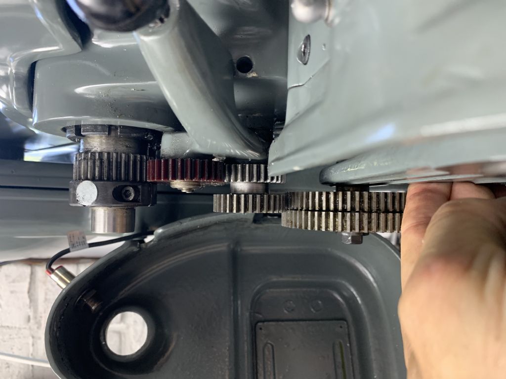

      Gents,
      We are trying to cut an M10 thread on our S7 lathe. We have a metric conversion set and have installed the slotted quadrant as per Myford booklet. The quadrant has been fitted with the required change wheels.
      The problem we are having is with the Tumbler Stud. As per the booklet, it must have 30 teeth. The tumble stack is quite thick as the tumbler gear itself has a flange of sorts. This makes the outer wheel on the tumbler stack stick out too far as it comes into contact with the outer wheel beneath it. It is only supposed to drive the inner of the 2 wheels beneath it. I took some photos to illustrate the problem. It may look ok in the photo but the outer wheel on the tumbler stud is actually touching the outer wheel of the stack below it as it's only supposed to drive the inner wheel of the stack beneath it.
      Any help is greatly appreciated,
      Mark

        ega
          @ega
          Is it just a matter of packing out the new quadrant?

          KWIL
            @kwil
            Yes

            Martin Kyte
              @martinkyte99762
              It looks like you need to fit a spacer between the two change wheels on the quadrent. Myford supply such an item which is used on most wheel set up's on non gearbox series 7 lathes to provide clearence and stop the change wheels rubbing. It looks like a penny washer with a cut out for the key so you can slide it onto the stud. If you have a set of change wheels you should have one.

              Nick Hulme
                @nickhulme30114
                Yes, add spacers, or skim the quadrant to align correctly.

                Mark Gould 1
                  @markgould1
                  Yes, that is the logical step. I took a short cut and put a washer on the whole stack which moved the whole stack outwards but a spaced between the 2 wheels is the way to go. I'll order the parts from Myford.

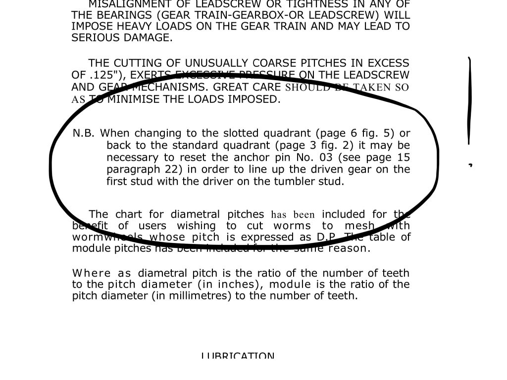

                      Before you leap to any further conclusions.
                      Consider if the Anchor Pin, part no A3015 Dwg Ref 203 is correctly assembled into the base of the gearbox. Its depth is set by a single Socket Setscrew (from below). If correctly set this is what hold the quadrant in the correct position to ensure the gears do in fact properly align, without adding any spacers to the gear train.
                      #419557
                      Mark Gould 1
                        @markgould1
                        Good point, KWIL, many thanks I will certainly do that next time I am at the lathe. I didn’t even know there was a pin down there.
                        #419559
                        Mark Gould 1
                          @markgould1
                          Ah I now know which pin you mean. I wasn’t aware that pin was only held in by a set screw. I just had a look at a pdf I have here on my tablet and see it how that could cause this issue.
                          thanks again, excellent.

                            #420514
                            Mark Gould 1
                              @markgould1
                              KWIL,
                              Just getting back to what you said, it's actually in the manual that I have. Makes it all the more embarrassing that I missed it, duh!
