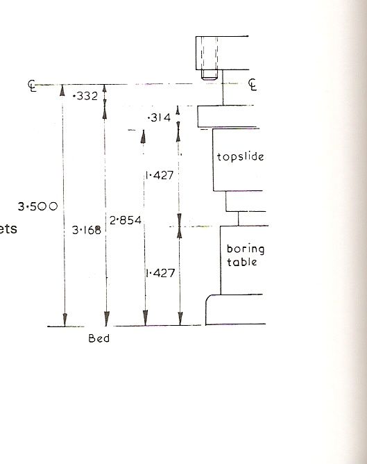

                  #275854
                  Swarf, Mostly!
                    @swarfmostly
                    Hi there, Rainbows,
                    This should help:
                    Source: 'The Model Engineer's Workshop Manual', by George H Thomas, Page 240, Fig. 21.2. Mr. Thomas recommends ML7 owners to measure their own machines and produce their own version of this diagram for future reference.
                    The 'top bit' is the Myford four-way tool-post.
                    Best regards,
                    Swarf, Mostly!
                    #275865
                    John Haine
                      @johnhaine32865
                      Posted by Swarf, Mostly! on 05/01/2017 10:30:15:Mr. Thomas recommends ML7 owners to measure their own machines and produce their own version of this diagram for future reference.
                      Best regards,
                      Swarf, Mostly!
                      You can see why!
