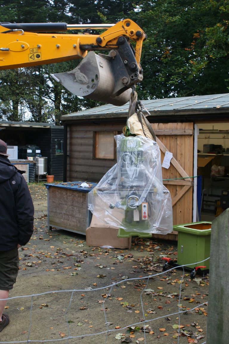

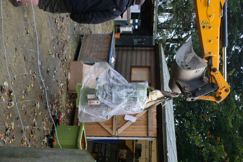

                          Well it's finally in, with the aid of a JCB.
                          I couldn't wait for the rugby guys to return as rain threatend.
                          I am trying to upload some photos without luck at the moment.
                          #102392
                          chris j
                            @chrisj

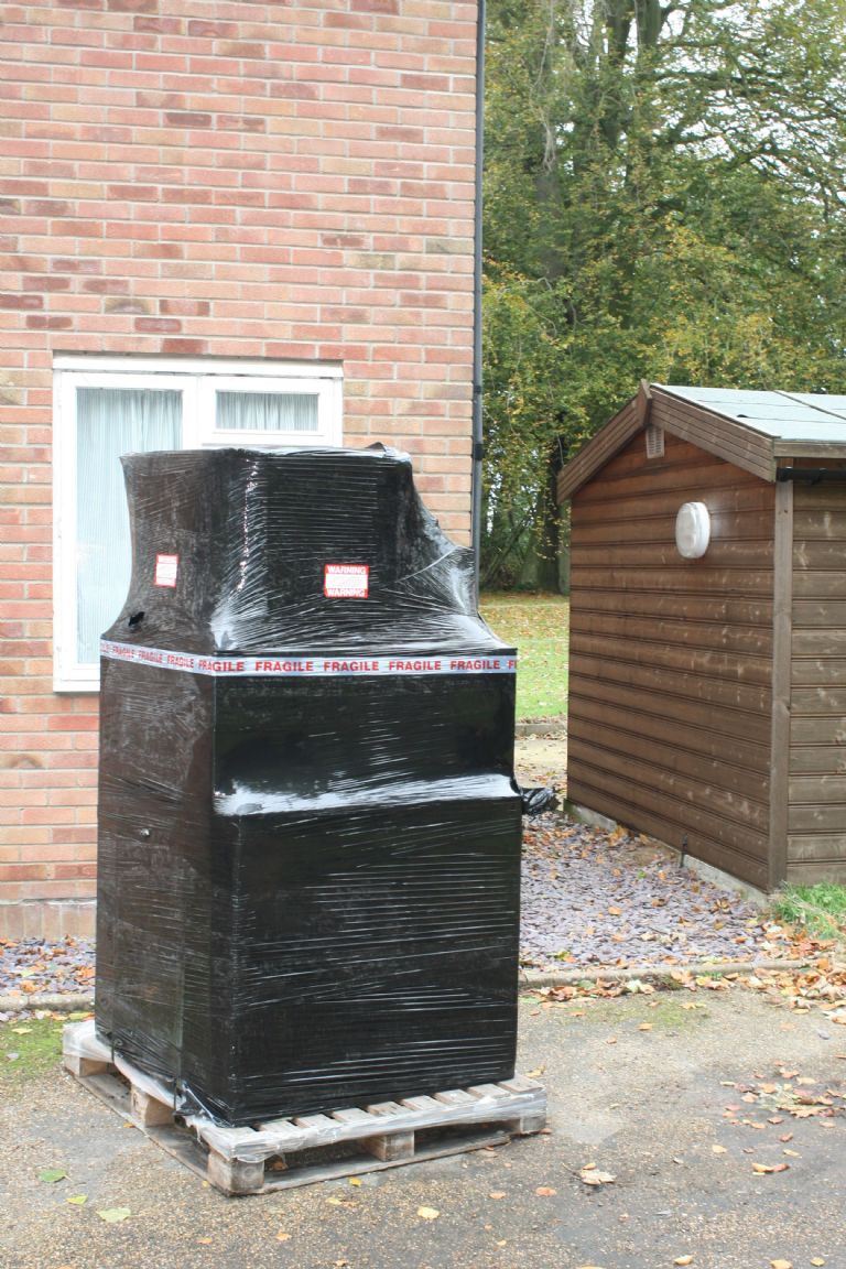

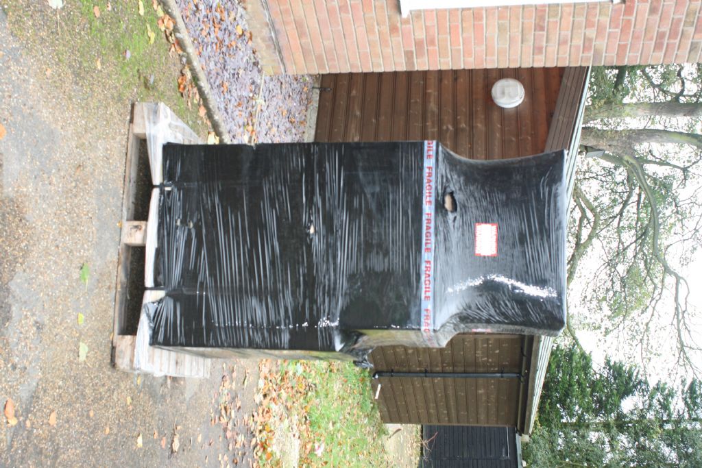

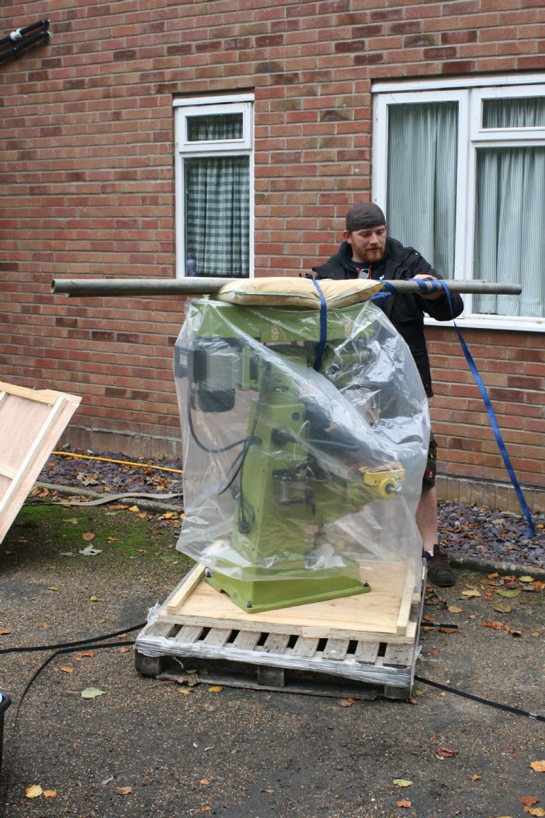

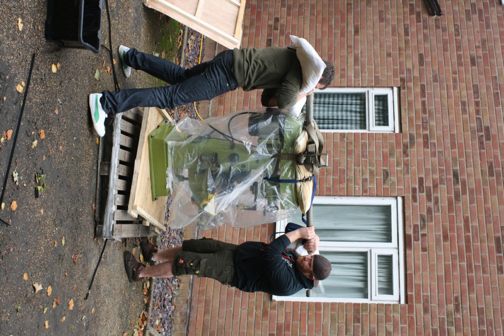

                            This is how it came on the pallet.
                            The outer skin removed the contents.
                            We unpacked things and lifted it off the pallet.
                            With the aid of a couple of scaff tubes and some loading straps.
                            It was at this point one of the boys pulled his back and it was game over.

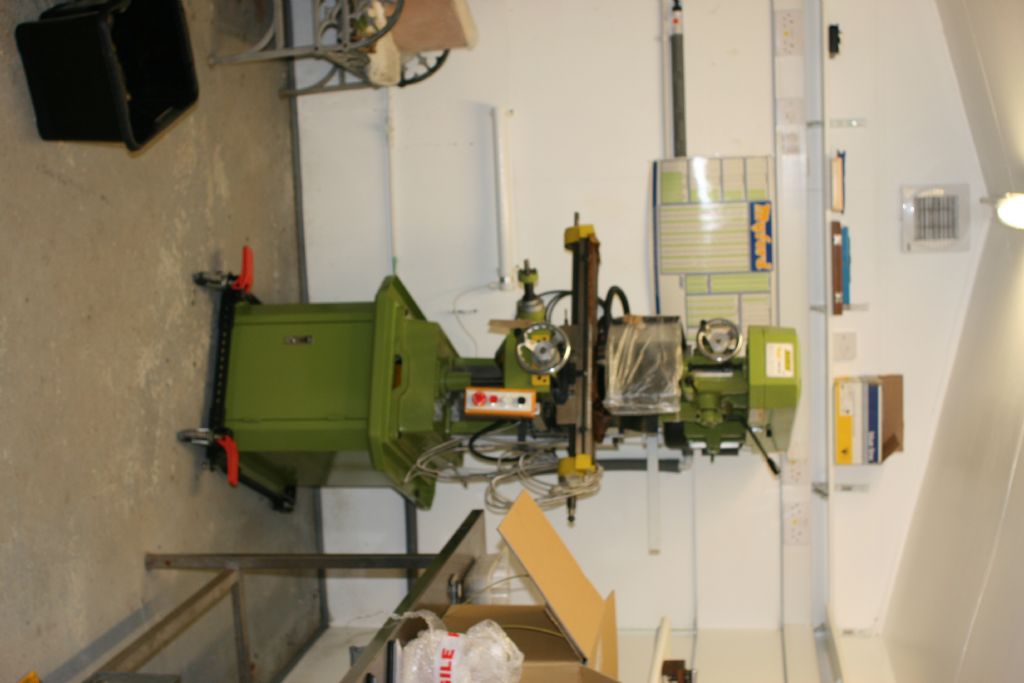

                              Here it is, a work in progress and a bonus extra shot.

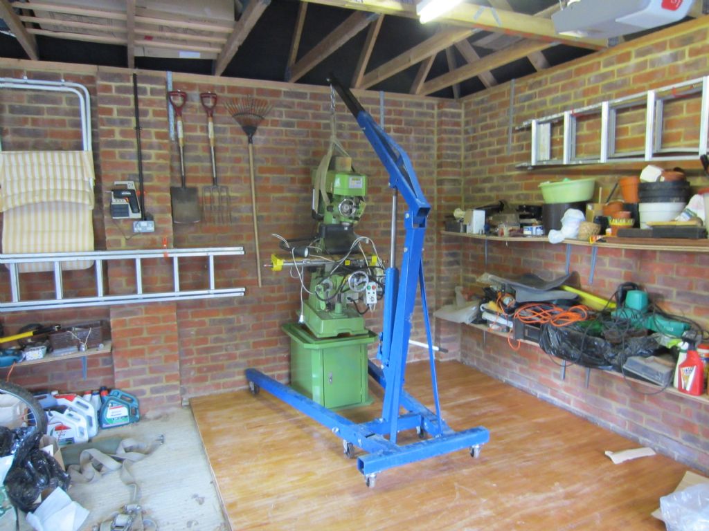

                                  For people moving something similar without access to a JCB here's a suggestion. A 2 ton engine crane is built on a 4 castor base with about a 2 ton carrying capacity. After lifting the tool onto suitable blocks strip down the crane, slide under and use a normal trolly jack to lift and lower the tool onto the trolley. It only takes 15 minutes to strip or rebuild the crane onece you have done it a few times. If you can borrow a second crane it is even easier. Take precautions for a tip-over though which is one reason I wouldn't recommend assistants under fifty. Old guys aren't in such a hurry.
                                  #102396
                                  Grizzly bear
                                    @grizzlybear
                                    What a nice workshop/mansion. Good luck with your new purchase. Looking forward to hearing more, when you are using it.
                                    Regards Bear..
                                    #102398
                                    60019
                                      @60019
                                      "…A 2 ton engine crane is built on a 4 castor base with about a 2 ton carrying capacity."
                                      Indeed
                                      (I see I took this photo on 16-Nov last year – nearly had a year at this now).
                                      Mike
                                      PS and unrelated. Anybody else think there should be a Hurricane Jules out there?

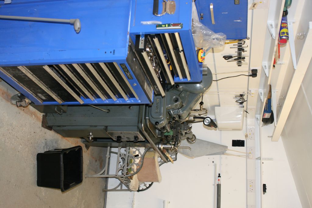

                                      Warco VMC Install

                                        Well done Chris
                                        That looks like a potential " Cozy Corner" – all set up for hours of fun!
                                        I've found that decorating the empty workshop in a light colour is a good move ( a lesson learned from experience!). You can never have enough light in a workshop and a year or so down the line you will have so much stuff in there you won't be able to decorate!
                                        I also like the high level power points – again you can never have too many.

                                                #102444
