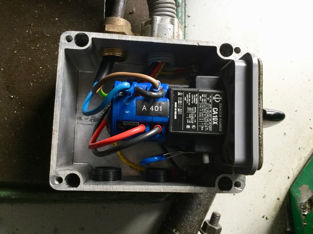

      Hi guys, currently recently retired and undertaking Allchin 1.5 build. My problem…. my Myford lathe switched itself off, will restart in both forward and reverse but refuses to stay running, switch reverts to off position. The current switch from single phase supply is.a Kraus and Naimer CA 10x. Please can anyone help? Is the switch the problem? If so, can anyone suggest a reasonably priced replacement? Thank you

            Hi Brian, thanks for your prompt response. Yes, the lathe was working perfectly until I turned it on after returning from a hospital stay (!)
            Regards, John

                            #387144
                            Robbo
                              @robbo
                              Sounds like John's switch is the one specifically used for Myfords, is in a substantial cast housing, and came with specific wiring instructions for Myford use. I have an unused one "on the shelf", but have never tested it.
                              These are not like the smaller switches with a cam and spring lock to hold the switchgear in place, but have a built in NVR capability. If there is no voltage flowing then the knob will return to the off position.
                              Seems like the NVR coil has called it a day, or become disconnected, so the contacts can only be kept closed by holding the knob in place.
                              A picture of the switch will help identify it
                              Edit – must acknowledge Mrs Robbo's help in typing this wink
                              Edited By Robbo on 22/12/2018 17:54:26
                              #387150
                              John Vickery
                                @johnvickery68803
                                Hi Robbo, this sounds exactly the issues I'm having! I have a picture but (even with Mrs V's help!) I cannot upload it to this site. If you could give me an email address I can send the picture, but I don't know if that's something people do on these forums and if it's an inappropriate suggestion.. I apologise!

                                        #387168
                                        John Vickery
                                          @johnvickery68803
                                          Thanks Les. I'm sure that Robbie has identified the problem for me and I'm thinking that a replacement switch is going to have to be the answer. The coil failure makes sense to me as there didn't seem to be a mechanical lock on the positioning of the switch. Once Christmas is over I will contact the supplier that Simon suggested unless the one on Robbo's shelf is available.

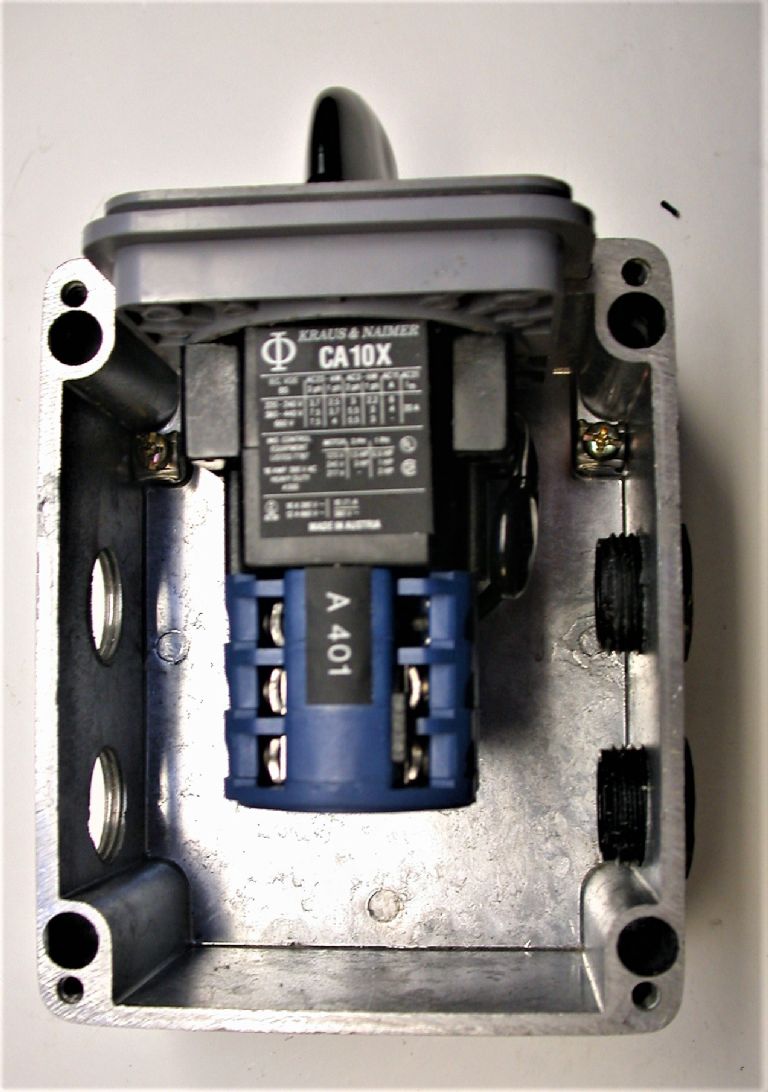

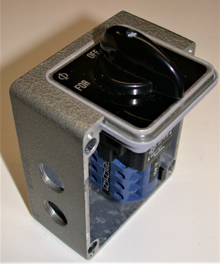

                                          #387308
                                          Robbo
                                            @robbo
                                            After a Doctor visit this morning can manage to do this myself without too many shakes, so have taken a pic of my switch which seems the same as yours. Pics below
                                            If you check out the items noted by Les Jones, who is a whizz at this electrics lark, and still need a replacement, then let me know.
                                            I will send you a message with my email address, pick up the message from your Inbox at the left hand of the green bar at top.

                                              Hi Robbo. Pleased to hear you are feeling better! Yes, this switch looks exactly like mine. Is this switch surplus to your requirements and if so are you prepepared to sell…. and how much? I’m in Devon so it would have to be a postal job.
                                              Regards, John
