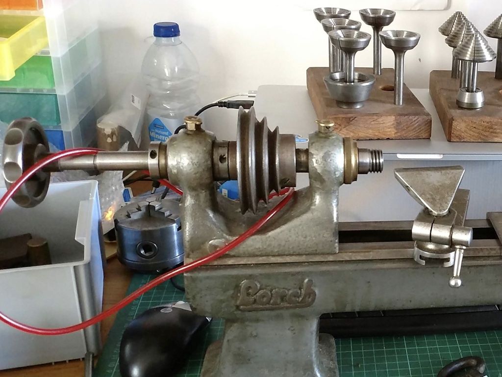

        I want to mount a new chuck onto my Lorch lathe instrument makers. The headstock spindle has a 20mm x 2.5 metric thread.
        I am planning on getting an unmachined backplate from Chronos like this:
        https://www.chronos.ltd.uk/cgi-bin/sh000001.pl?WD=backplate&PN=Unmachined_Chuck_Backplates%2ehtml#a112175
        My question is around the cutting of the internal thread on the backplate. Would I get acceptable results from using a tap like this or should be thread be machine cut on a screw cutting lathe?
        https://www.tracytools.com/taps-and-dies/metric-taps-dies/20-x-25-metric
        I'm hoping the tap solution will work.
        Also should I invest a little more in the HSS version of the tap?

          I suspect the lathe's spindle nose has a collar which the back plate butts up against, so it is essential that the thread of the backplate is as near as possible perpendicular to the mating face on the backplate. Screw cutting would be the preferred method as this will give the desired result. If you use a tap, it may wander out of perpendicular to that face.
          The second part of good repeatable alignment is achieved by the bore of the backplate locating on the un-threaded portion of the spindle nose adjacent to the spindle nose collar.

            Could you post a photo of the spindle nose please, Mark
            If it has a 'register' then a tapped thread should do fine … because the register does the accurate bit.

              I'll have to take a better picture when I'm home from work, but this gives you an idea. I'm pretty sure that the existing chuck I have butts up to a register.

                That looks fine, Mark
                The precision of registration should be provided by that long parallel section, and the screw-thread in the backplate will effectively just be a 'nut'
                Get the plain boring right, and tap the thread [with due care and attention of course]

                  In terms of purchasing taps is there a big benefit to getting a HSS one for cutting the casting material or will a standard one do. I'm not planning on doing this operation lots of times…  the HSS tap costs x3 as much.

                    I think the 'carbon steel' version should be adequate for what you're doing, Mark.
                    Incidentally; does the chuck in the background of your photo fit the Lorch nicely ? … If so, I suggest you briefly remove it from the backplate and have a look at the 'fit' of the plate to the spindle nose; to give you a better feel for what you need to do.
