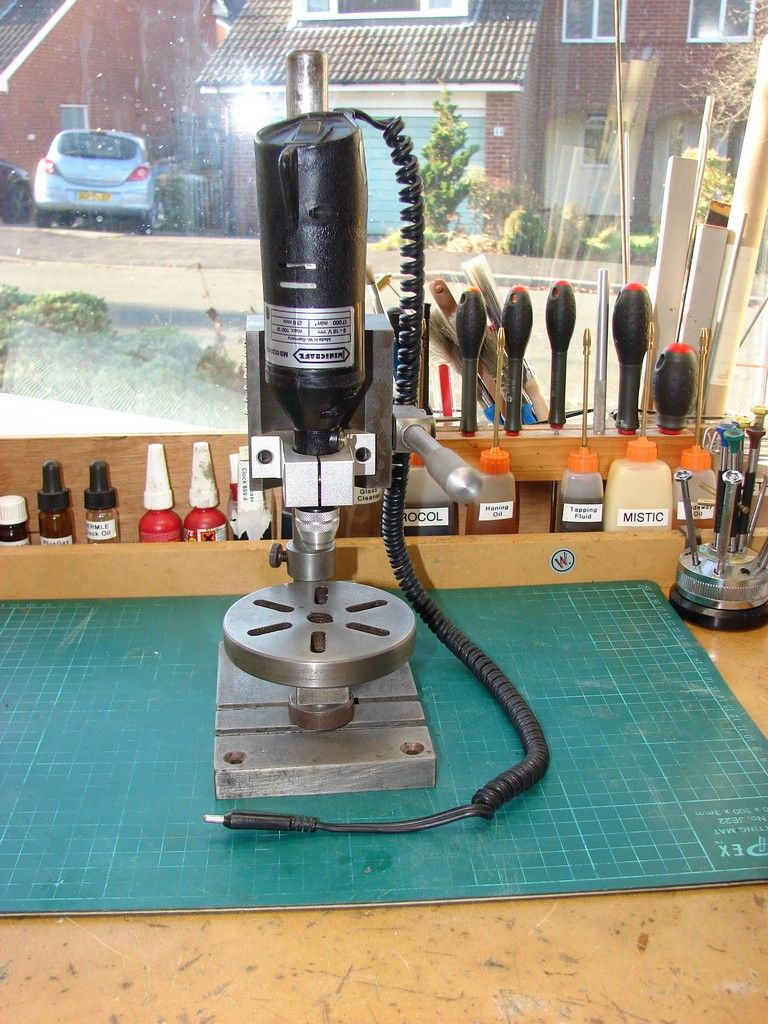

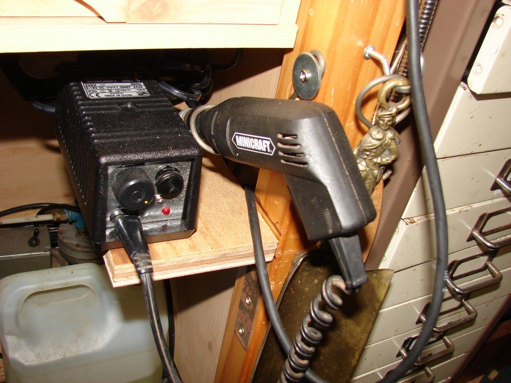

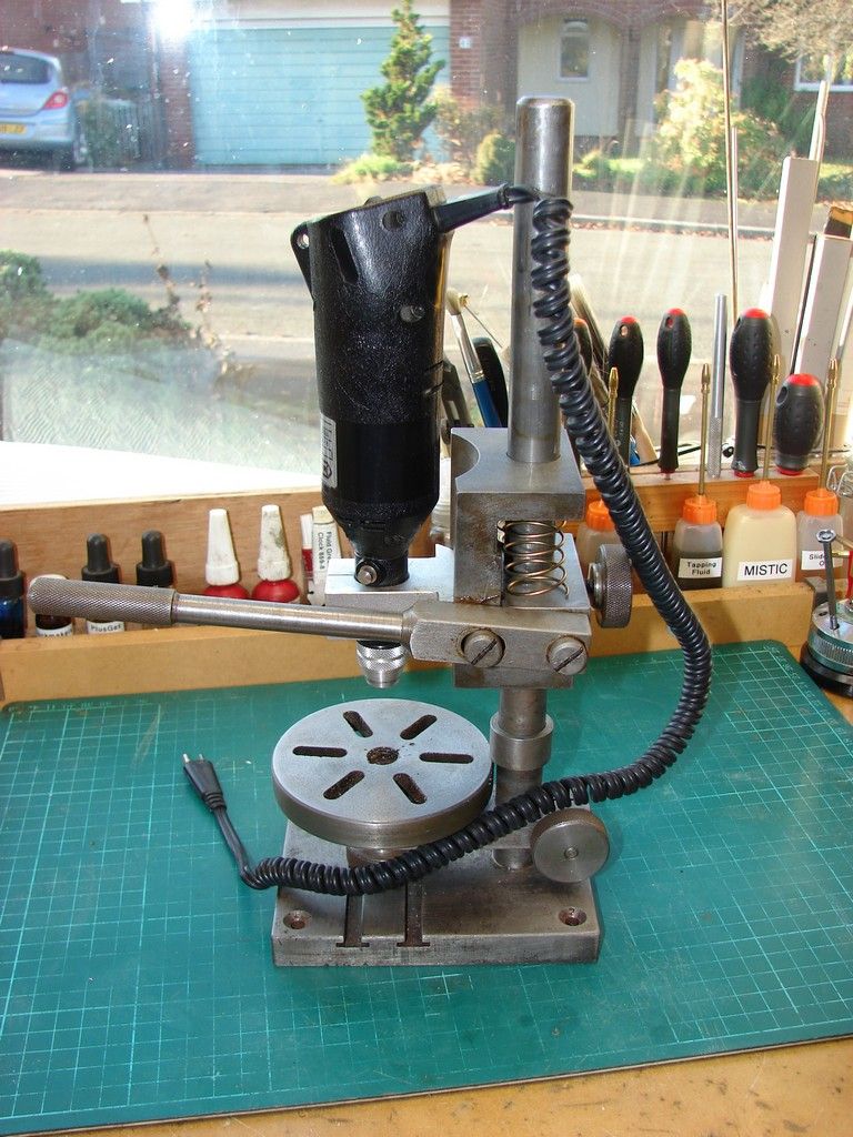

                  @stephenbenson75261
                  I have been playing around with stuff from Minicraft with good success, I converted a Cowells Pillar drill originally for a Proxxon industrial die grinder but the Minicraft MB150 drill works much better for Clock work and should suit your application well with the variable power supply more pictures in the album, as with the Proxxon there is a 20mm dia ally collar to grip securely
                  I think this design of sensitive drill is the best I have encountered
