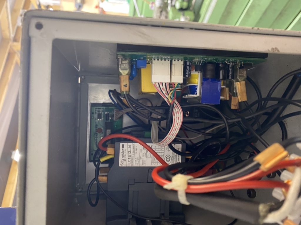

      3ceafa8a-3705-43cb-980c-04b631315616.jpeg  After  6 years of happy usage with my mill (Same as the wm18) I fear I could be about to be on my third control board -aaarrrgggghhhhhhh.
      Display lights up but nothing happens when the pot is turned. When switching on it makes my LED batten lights flicker – I don’t recall that happening before. It also hums when switched on but it may have done that before and I ignored it. The last one cost over £100 and unhappy I may need to do this again. I did find a you tube video where someone claimed the diodes often go. I did find a source for a few quid so will try replacing these on the current and old board and see what happens. It also did that hunting business whilst cutting 18mm into steel for about 5 minutes of use before giving up.. I know there are lots of very knowledgeable people on this site and would appreciate any wise words as I’m getting pretty fed up with this. Many thanks in advance. 21d92a6b-f67d-472e-8d07-d57fe11ca993.jpeg
      Edited By Keith Matheson on 07/03/2021 19:52:04

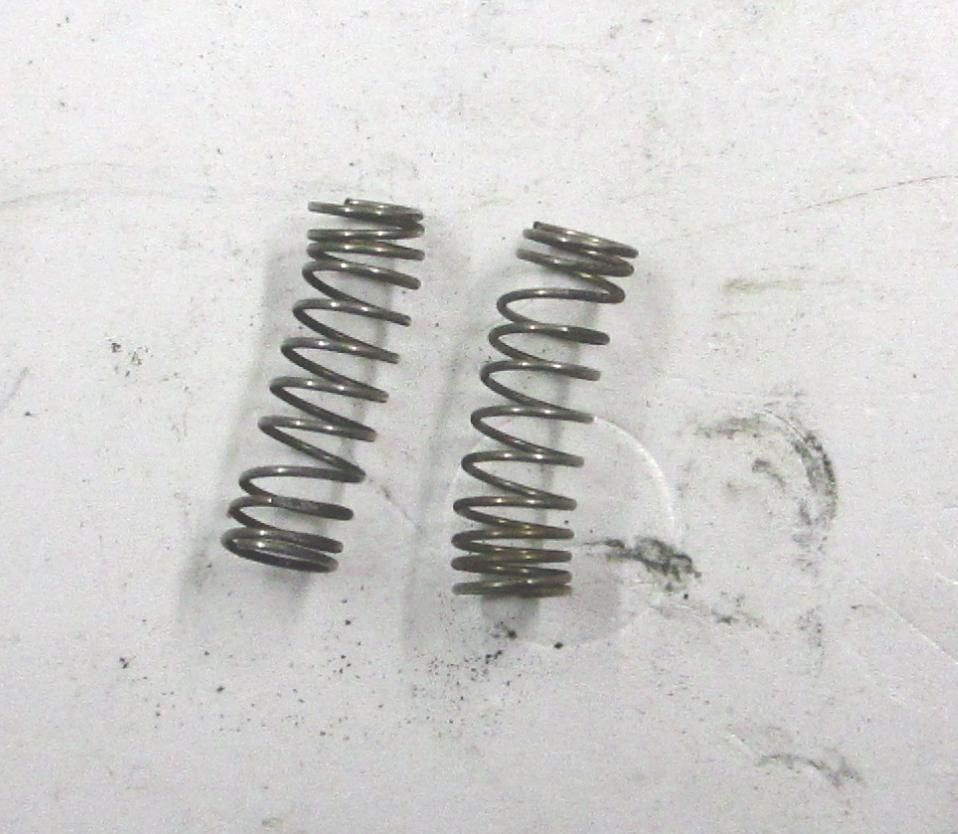

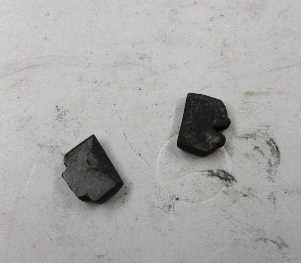

          Before doing anything else check the motor brushes ! These very commonly give problems, sometimes damaging the control board.
          I've just made a pair of new carbon brushes for mine simply because it stopped rotating when it shouldn't have.
          The removed brushes !
          The springs.
          Note that this is the remains of the previous pair of brushes that I have made and the springs are ones that replaced the previous ones.
          There are a number of issues with these motors all mainly due to getting hot !

                Anonymous
                  It doesn't look like a brushless controller to me. The board looks a little rough on the upper left side of the two preset pots top left – almost as if something has leaked out? There are also several light brown areas on the right side of the board. Are these real or a trick of the light?

                  John Baron
                    @johnbaron31275
                    Posted by noel shelley on 07/03/2021 21:04:38:
                    No little copper wire down the middle of the spring to carry the load ? It might be worth wipping the mosfets or switching devices of the heat sink and checking them. Nothing ventured nothing gained ? Noel
                    Hi Noel, Guys,
                    No ! The little pigtails don't exist on my home brew brushes, they did on the originals, but they simply fell out allowing the motor current to destroy the springs.

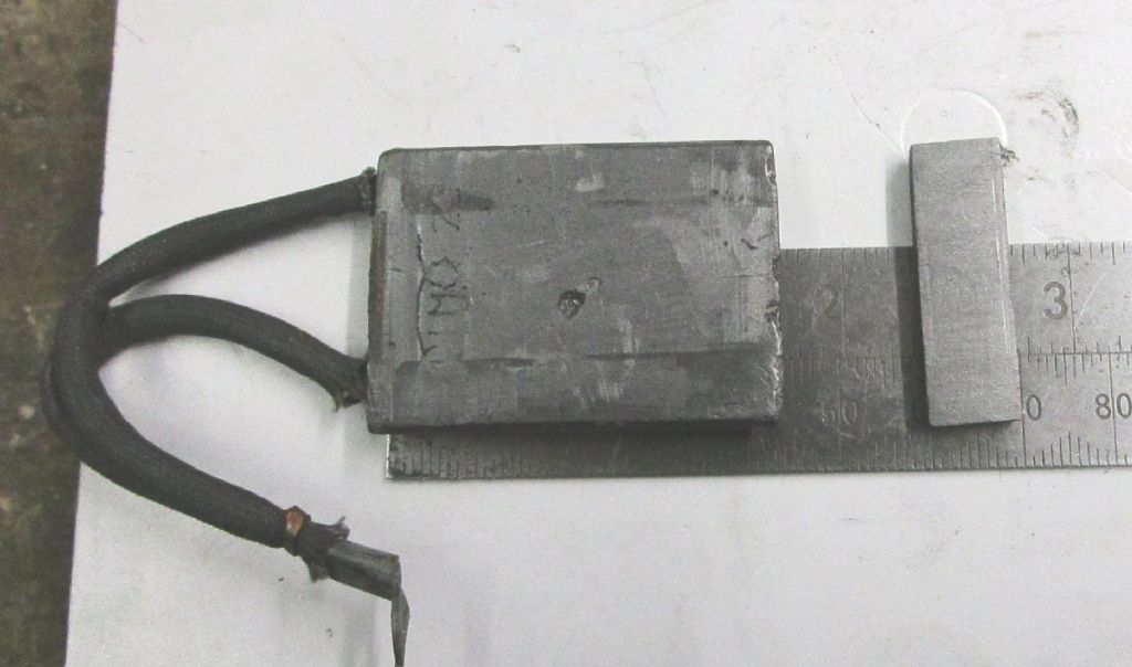

                    John Baron
                      @johnbaron31275
                      Hi Keith,
                      Good question ! Those big brushes were given to me by a motor re-winders in Sheffield quite a while ago. They came out of their scrap bin. I haven't a clue what they would have belonged to, but they are enormous compared to the ones that I make from them.
                      The one on the right is the one that I've made, it also requires cutting in half. That big brush is 50 mm by 32 mm by 6 mm thick. Manufactured by Morganite I believe. The brushes in the mill motor are 3.6 mm thick by 10 mm wide and 15 mm long. Everybody I've tried for replacements wants to sell me an expensive motor costing an arm and a leg !

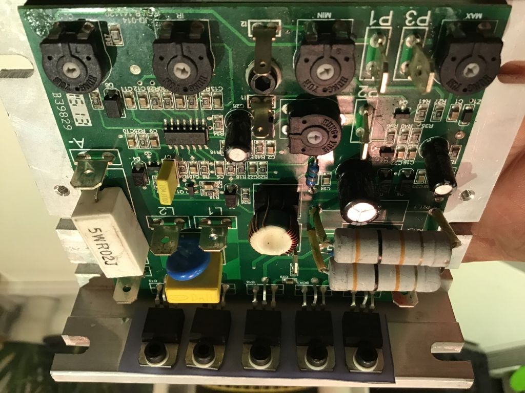

                      oldvelo
                        @oldvelo
                        Hi
                        " It also did that hunting business whilst cutting 18mm into steel for about 5 minutes of use before giving up "
                        The setup of the Current Limit and Intensity Regulator pots are not adjused properly.
                        KB Controls is an excellent source of information on DC Motors. Scroll to Page 27 for correct setup
                        Control Board Setup

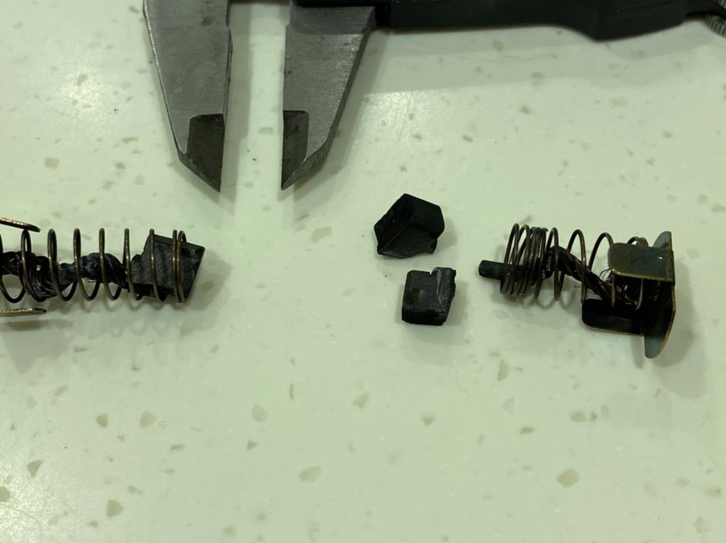

                              John Baron
                                @johnbaron31275
                                Posted by Keith Matheson on 08/03/2021 21:15:20:
                                Thanks for all the suggestions and guidance so far. Gratefully received. It makes problem solving soooooooo much easier and less time consuming – and hopefully less expensive. Anyway, onto current matters. I took the brushes out of the motor and found one broken in two (with the associated wire unattached) and the second looking somewhat short. I have found the same cross sectional area brushes on evil bay so have ordered a pair. I will report back what happens (I do so much hate a thread that doesn’t reach some sort of resolution)! I will also pop the new diodes into the previously died board and see if I now have a spare. Thanks again. keith MM ps like the idea of a pc fan attached to the motor housing- will do this as a sensible addition.653723ab-6aab-4f6a-841a-1f1f0c0451aa.jpeg
                                Hi Keith, Guys,
                                Thanks for the picture, that is what I expected to see ! just curious, did you measure the dimensions of yours ? I wonder weather they are the same size.
                                As far as the brush hardness is concerned there is no difference between AC and DC brushes, as seen in universal motor use. There are however quite marked different grades and composition of brushes intended for different applications. For instance, some brushes are copper loaded and some are very soft, like the carbon material that I am using for making my replacements.
                                I'm not saying that the stuff I'm using is correct, but it works for me. The wear on the brush is basically due to two causes, brush pressure and arcing. Higher pressure on the brush reduces arcing but increases wear hence the reason for harder brush material.
                                I would remove the brush cap and inspect the commutator for wear and blow out any dust. Inspect the wiring to the brush holders for any heating damage, particularly loose push on fix connectors. Any looseness will cause heating leading to failure of the insulation of the brush holder.
                                DO NOT attempt to remove the armature !
                                Apart from the fact that it will be very difficult, it will cause the field magnets to loose their strength.
                                HTH.

                                                    #532869
                                                    Anonymous
                                                      Posted by John Baron on 09/03/2021 19:42:39:
                                                      It does not vary with voltage.
                                                      Voltage dependent resistor? There's one on the board in question – the blue disc above the rectangular yellow capacitor.
                                                      Andrew
