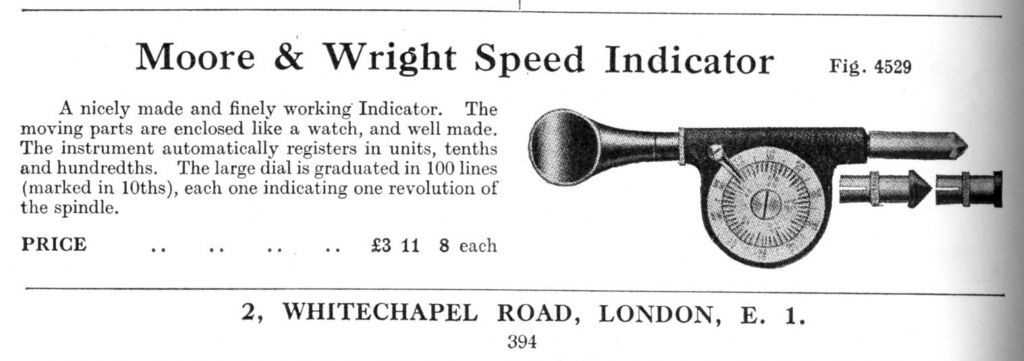

                      Hi Mike, bekow is a scan from a 1964 Buck and Hickman catalogue, showing it as a speed indicator.
                      Regards Nick.
