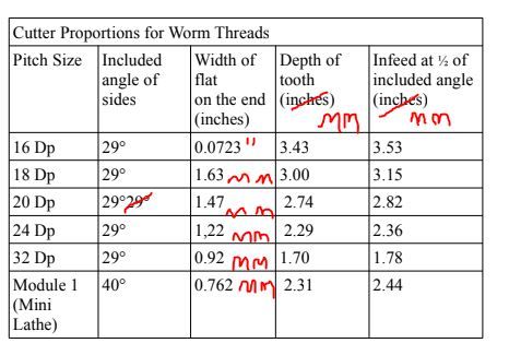

                        Agree with the comments re the tiny and virtually unreadable diagrams. I didn't get to read the whole article until receiving the March edition.
                        Having got Issue 290 page 36 I found tables 2 and 3 difficult to understand, can I presume it is showing the difference between a gear and a rack? The text doesn't mention either table. Then on page 37 another table 2 crops up where it says Depth of tooth and flats (in inches) then lists width of flats and depth of tooth in inches which are I believe ridiculous figures. Can I presume the decimal place is incorrect for most of the items listed. Then surprise surprise the same table appears as Table 4 in slightly larger print with exactly the same ( I believe) errors.

                            David this has been covered in another thread as I spotted the table errors, though not the size error.
                            Don't think we can even presume the figures have the decimal point in the wrong place as depth looks wrong for the 1MOD though they ar eclose metric sizes except the first 16DP one which looks to be imperial . Even the trig for feeding in at an angle look to be wrong.

                                Looking again at the table 4, I think the dimension for the 16DP width of flat is in decimal inches and the rest in metric though I don't agree with the metric figures which seem a little bit out.
                                Anyone else want to have a stab at the figures, they relate to cutting a worm gear so you have included angle, width of flat at end of tool, length of tool (Depth of cut?) and infeed with angled topslide. red is what I think it should be in relation to inch/mm

                                #453801
                                David Caunt
                                  @davidcaunt67674
                                  Jason
                                  Thanks for that. They look more like being in the correct ball park.
                                  The other tables have the odd errors in them so I would advise checking before use.
