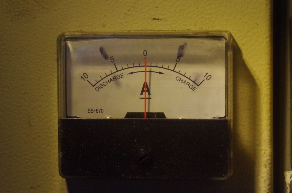

            Ouch! sound expensive. The use of the low speed recomended with the motor running at higher speed.
            One improvement I have posted repeatedly is to fit a DC Ampmeter on the motor leads.
            Mark the Guage with Motor Max Amps.and adust the cutting load to a reading of less the Motor Amperage.
            Posted elsewhere Amp Meter

                                                    oldvelo
                                                      @oldvelo
                                                      Hi Apologies to all for wrong link
                                                      Eric
