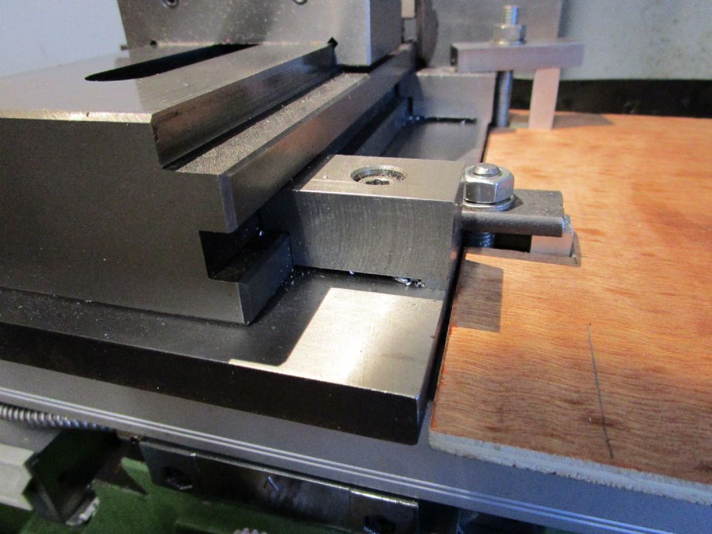

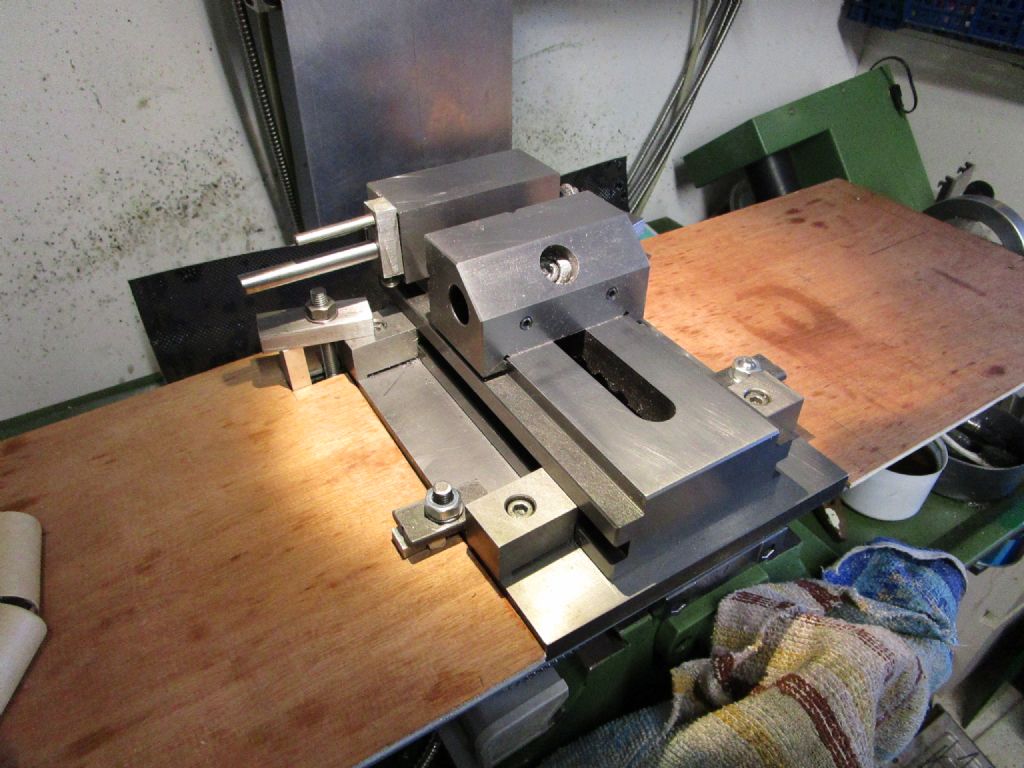

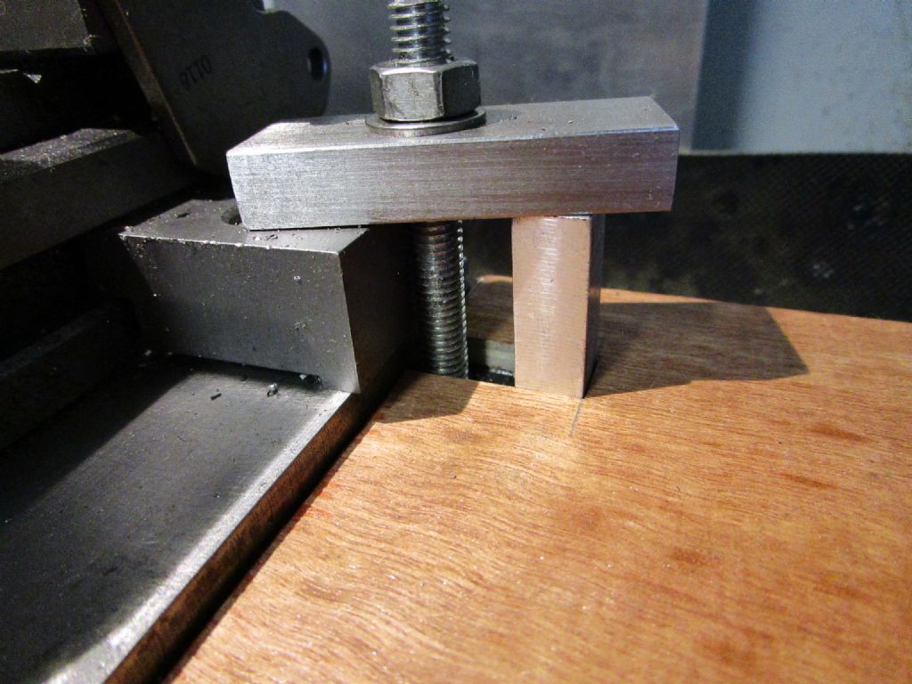

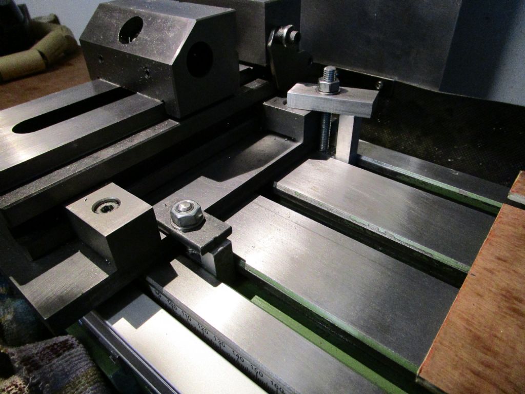

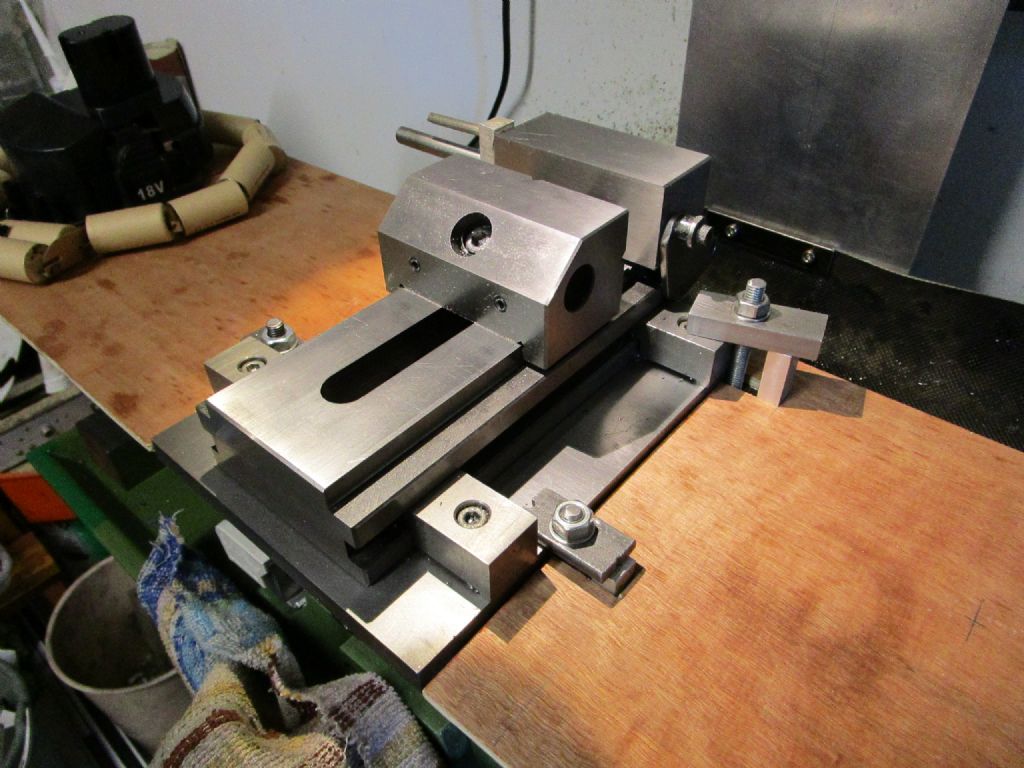

                                I used a shallow slot milled across the bottom of the plate and a length of bar screwed in, it is milled to be just wide enough to drop into the table slots anywhere I choose. The base thickness was simply because I had a piece of precision ground plate of suitable size, and it is a lot harder to distort than thinner plate. It also has the advantage that I can slide the vise to one side and place the rotary table on the mill as well, so I have use of both if I need to.
                                The vise hold downs are machined from square bar and use M6 cap screws in counterbores to secure them. The plate is held down in the usual way with "T" nuts, studs and plates, the plates supported on alloy pillars sitting in the table slots.

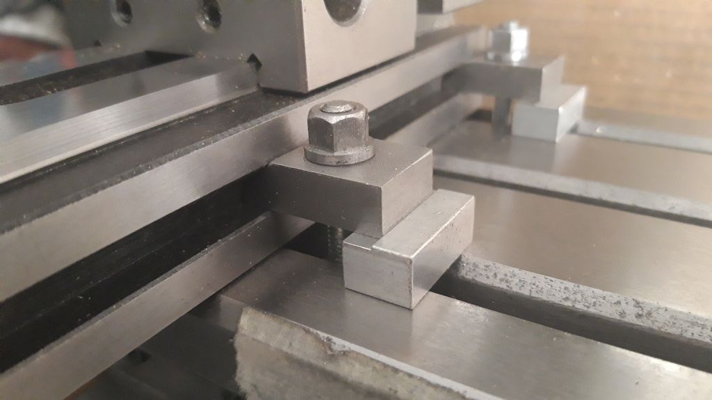

                                    I had the same problem with clamps denting the table, so I made these in the pic, they are little aluminium blocks machined to the same height as the vice slots, the steel top clamp can be bolted down spreading the load evenly. It'll do until I make better looking one piece clamps.
                                    Weirdly this is a new cast iron longer table which dents easily, softer than aluminium! the old smaller cast iron table didn't dent at all, must be made of tougher stuff!
                                    IanJ

                                      Hi Chris, Guys,
                                      There are five pictures, I've put them in an album, so they don't get lost on my computer.
                                      I've very recently spent some time fitting a DRO and doing some maintenance on the mill. The wooden way covers and the aluminium ones at the back are just a couple of new items.
                                      The long hold down studs are M8 with 8 mm thick clamp plates. The other new item is the stop on the vise at the left. The one on the right is just a piece of 4 mm plate that I had kicking about.
                                      These are just close up pictures of the clamps. You can see the 12 mm precision ground plate.
                                      Hope these pictures help.
