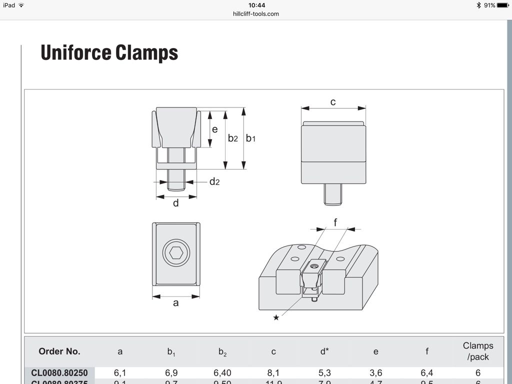

                          #277857
                            Posted by JasonB on 15/01/2017 08:00:14:
                            … in this thread
                            Jason,
                            I note this reference: "The jig was made using Mitee-Bite uniforce stock. It comes in 20" lengths and it can be cut to make custom clamps."
                            That looks useful stuff !! … do you have any experience of using it ?
                            http://www.hillcliff-tools.com/en/page/mitee-bite
                            Edited By Michael Gilligan on 15/01/2017 09:56:06
                            #277870
                              No but have a feeling Andrew J may have some of their individual edge clamps.
                              Looks interesting stuff but have not looked at costs yet, will have a read later. I suppose you could make some folding wedge type clamps to the same principal. I have some C section channel to make soon so may give it a try.
                              J
                              #277875
                                Thanks, Jason
                                I have downloaded the catalogues, and it all looks lovely stuff
                                … But, yes, I seem to remember that even the little hexagonal fixture clamps are fairly pricey.
                                Cost-effective if you are paying for set-up times, but maybe not for the hobbyist.

                                    @johnreese12848
                                    The Mitee-Bite products are great but terribly expensive. If I were making the I beam I would use a long bar for a fixture, Cut a groove to accept the raw material, grub screws on one side to force the stock to one side of the groove. Provide hold down clamps at intervals to hold the material against the bottom of the groove. Move the hold downs as needed to let the cutter pass.
