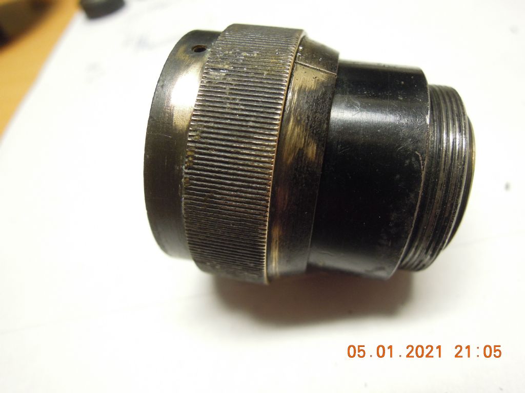

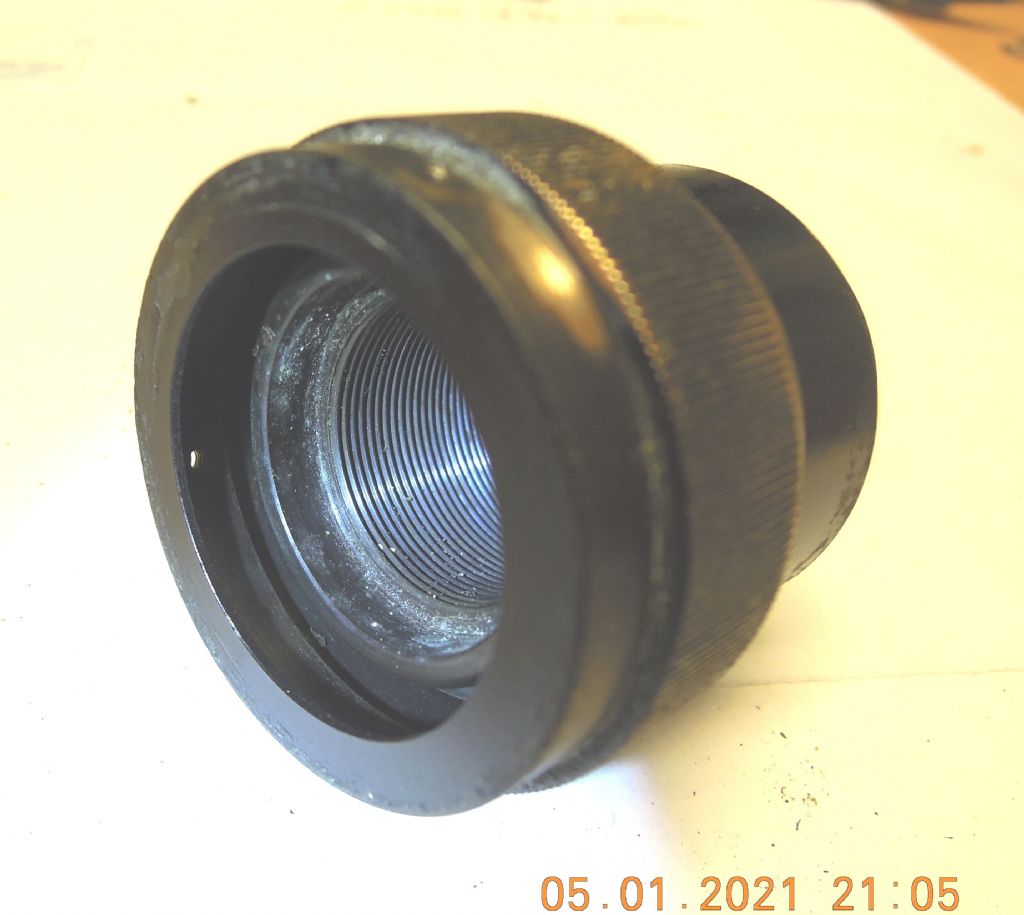

      My latest challenge is dismantling my eyepices. In many places OMT have done a great job of hiding the typical 120 deg. grubscrew connections, with a fine push-fit brass sleeves, which were then painting over to make it look solid. I think I have found all of these and I'm down to the coarse focussing threads. These badly need fresh kilopoise grease so I have to get them apart and this is where I'm stumped. I'm hoping that someone will know the secret behind this particular assembly or can suggest something to try that I haven't considered.
      The eyepiece assemblies look like this:dscn8017.jpg

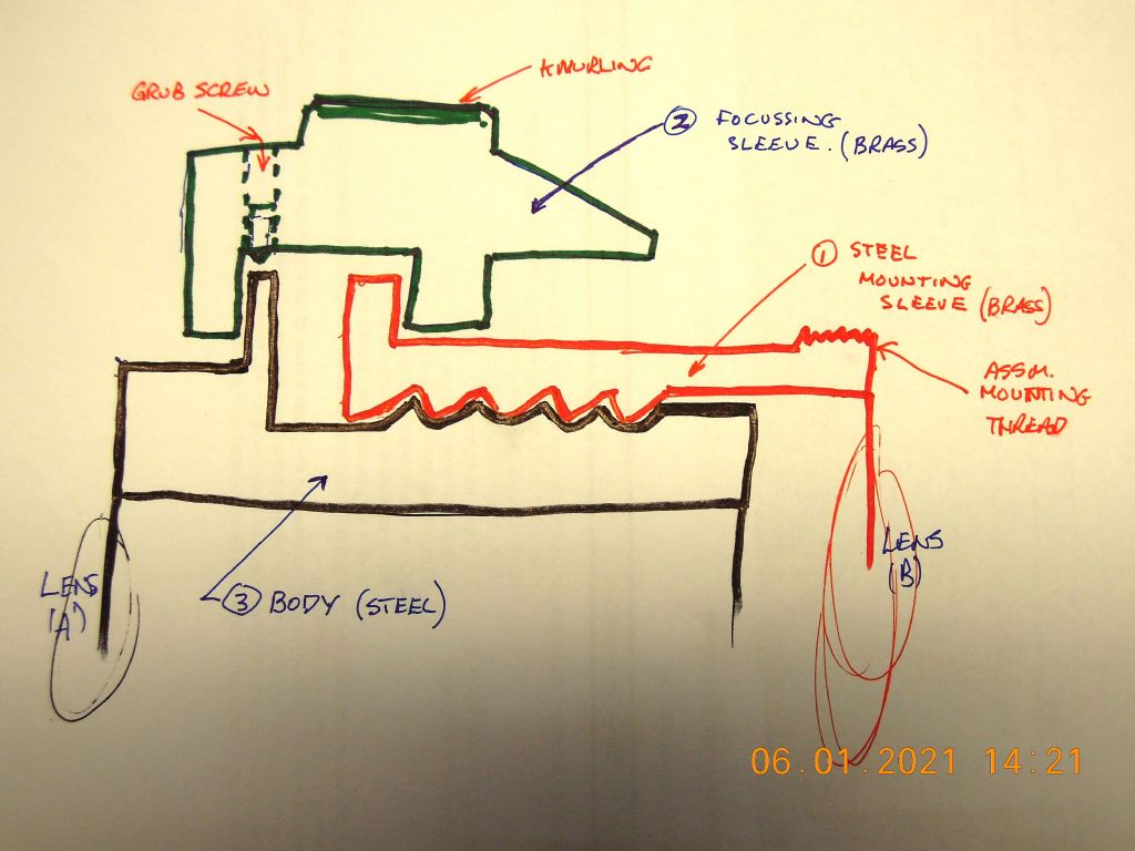

      The outside 'focussing sleeve' with the straight knurling will currently rattle axially by a few mm's if the focus is opened to its limit. If the focus is closed down the 'focussing sleeve' becomes tight. From playing with the assembly I 'think' the internal construction must be something like this:-
      If this theory is correct, to get it all apart, part no.2 the focusing sleeve, has to be separable. But I just cannot see how to do this. My expectation was that the pieces of the sleeve to either the left or the right of the knurling would unscrew from the knurled section. However I see no way to grip them other than by friction. I tried that, and it wasn't successful. In any case I carefully brushed all the paint away from the likely joints and viewed them under a microscope. I could not see any obvious junction.
      What I have detected though is that the 'zero mark' on the tapered portion (on the right of the knurling, visible in the first picture) is more than just an engraved mark. It appears to be a joint and if one forces a screwdriver under the sleeve and levers it you can see the joint open very very slightly. But that's all I can make it do, it will not allow itself to be prised out of where it currently sits.

        Clive Hartland
          @clivehartland94829
          I have seen this before, the angled ring with the cut in it is usually a left hand thread and turned opposite to the collar.
          They are often quite hard to turn but pressing in on the cut will start the unscrewing. be aware that the Kilopoise comes in a few different viscosities.

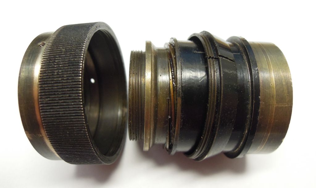

            gerry madden
              @gerrymadden53711
              Well done Clive Sir ! I just picked it up and turned it the 'wrong' way with my bare hands and look what happened !
