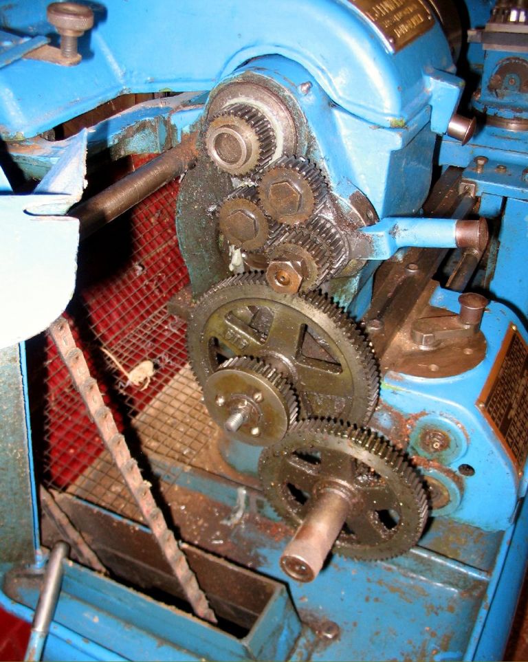

                Is there really not a banjo – the improvement must have been to fit one and supply the gears. Give us a better photo of the back end. It may need some thought as to the best design to fit one if it wasn't part of the original plan.

                  Looking at the image of the Fortis gears on Lathes.co.uk there appears to be a small short banjo hidden behind the gear train. There are probably only a few change gears as the Fortis has a full quick change gear box.
                  It's a bit difficult to see and appears very rusty in the shot. There needs to be some sort of adjustment available I would have thought to change from metric to imperial pitches, just guessing!

                        Hmm, is that a universal truth? It appears from the pictures of the Fortis there's no banjo, which must make life difficult.
                        If the Fortis has just an imperial leadscrew and a fixed gear train between spindle and gearbox, I don't understand how Sean could ever make the ratios needed to cut metric threads.
                        I suspect Sean has a lathe built to cut common imperial threads only. Many customers would not have seen this as a limitation when the lathe was new, and much Model Engineering remains steadfastly imperial today.
                        Happy to be told I'm wrong! Short of a rebuild, how could you cut metric threads on Sean's lathe?

                          The 'banjo' could be a simple one with no slot an just a fixed position and angle so only one set of gears could be used to drive the gearbox. Then the improved version might have introduced a better arrangement. The thread plate on the gearbox mentions a sliding gear which appears to provide an 8:1 ratio change. No indication what that is. We need to see just what Sean has then we can suggest improvements.

                            The Fortis has a sliding gear , with the “gear in“, threads from 4 -28tpi can be cut with the"gear out", threads from 32 to 224tpi.

                              I can confirm this ,mine certainly has .

                                Yes, I deduced that but where is it on the picture of the gears above? I can see an extended shaft coming out of the gearbox – does that slide and if so can you provide pictures of 'in' and 'out' for information which can go on the Lathes site perhaps.

                                  The lead screw slide gear has a ball bearing with a small spring in the part you see protruding that allows you to set it in position . The the big gear up from that is the one mounted on the fixed banjo . I didn't have time to take photos of it ,I'll strip it down tomorrow taking photos as i go .

                                    Found some photos hope they help put some light on the situation .

                                        It puts no light on why you have a sweetcorn cob holder in the picture surprise.

                                          That is very interesting and I haven't seen a system like that before. And it is quite a big change looking like 2:1 reduction when out and 4: 1 speed up when in.
                                          I think if you want to cut metric you have to bite the bullet and make a new banjo and a number of new gears – do you know the DP? 14, 18, and 20 are quite common. (number of teeth over diameter). We can help you get the right tooth count if you go this route.
                                          Alternatively there is this system look for the post by Jacques Maurel.
