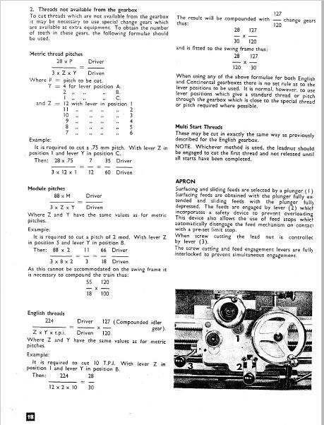

      Has anyone any settings for making a 19tpi thread on a Bantam metric lathe? I know there is a formula in the manual which is a bit obscure (to put it mildly) and my maturing brain won't cope with it too well. I'm sure someone else must have wanted this for a BSP thread sometime before I did.

            #236853
            Simon Williams 3
              @simonwilliams3
              Hi there,
              Try Lever A = position T (value1)
              Lever B = position 5 (value 12)
              The formula in the handbook now becomes 224/19x12x1 = 18.6667/19
              Multiply top and bottom by 3 and you get 56/57. You were always going to have to have 57 in there somewhere!
              so the train becomes Driver / Driven = 56/120 x 127/57.
              I've taken this from the handbook for my Mk 2 Bantam, I assume the Mk 1 has the same gearbox ratios.
              Try it carefully on a scrap piece before committing to the real thing!
              Muzzer – could you please check my arithmetic!!!
              Rgds to all
              Simon
              Edited By Simon Williams 3 on 30/04/2016 11:26:32

                  Hi Simon – yes, looks good to me, although the lever numbering is different. I have a Bantam 1600 (MkI) which may differ from a MkII. The gears you suggest give the required pitch pretty much spot on.
                  The formula's the same and you need to get the product of the 2 levers to be 12 but mine are identified like the illustrations ie levers Y and Z (1 and 2 in the pic):

                    Thanks for these thoughts. Simon's calculation works, but I haven't got 56T or 57Tt gears, but it provoked a rush of blood and I now have a glimmer of light in realisation that the tpi required has a relationship with the driven gear, which led me to gearbox 5 (=8 in the calculation) and lever in positn B (=2) which gives me gears 28/38. This is now one gear down as I have a 28T in stock. I assume that the gearboxes etc on the Mk1 and Mk2s are the same but the terminology has changed a bit.
                    Hopper I understand now how you achieved your calculation because I have just found the 'nthredp' program which is what I suspect you used (or something similar). I haven't got a 20T gear but now I'm 'cooking on gas' as regards the gears I have got, so thank you for the inspiration (the leadscrew is 6mm but this is easily dealt with now).

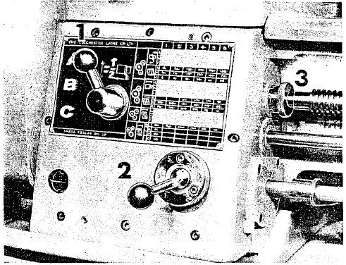

                              I've been sniffing about in the parts manual which shows the guts of both the metric and imperial ("English&quot gearboxes.
                              It may be obvious to a seasoned threading gearbox designer but certainly I was surprised to see that there are some interesting similarities and differences between them:
                              • The internal ratios are the same. You can deduce this from the operation manual but when you check the numbers of teeth on each gear you can confirm it quickly enough.
                              • The initial pair of gears is 21:49 (a ratio of 3:7) which explains why the external default driver gears are 35 (driving) and 30 (driven).
                              • The imperial gearbox is driven "top down" ie the top "intershaft" is driven by the input gears, then the initial 1:2:4 mesh / dogtooth ratio is selected, resulting in the middle "driving shaft" being at one of those 3 ratios. Then there are 3 pairs of sliding mesh gears that drive the bottom shaft, giving 6 ratios containing the ratios 7, 8, 9, 10, 11 & 12. Finally, the feed and lead screws are driven at 1.5 times the bottom shaft via some idlers.
                              • But bizarrely, the metric box is driven in the opposite direction. The bottom shaft is driven by the input gears, using the same 21:49t reduction but with the 49t gear on the bottom shaft instead of the top. All the gear ratios are the same but of course the final drive is now coupled directly from the top shaft to the leadscrew by means of an additional splined (but static) dog. There is an orphan 24t gear on the end of the feed screw that is simply left in as a spacer.
                              By way of a sanity check, with a 4tpi leadscrew, the manual says you need to select "A1" ratios to achieve a 4tpi thread. In this setup, the 3-way ratio (1:2:4) is set at the "highest" position (actually 2:1) and the 6-way ratio is 24:36. The external gear train is 35t (driving) and 30t (driven). This gives an overall ratio from spindle to leadscrew of 35/30 (external) x 21/49 (input) x 32/16 ("A&quot x 24/36 ("1&quot x 36/24 (fixed final ratio). Ideally this would reduce to 1.00, which it does. Phew.
                              Makes sense now. And if you want to do any unnecessarily complex gear ratio calculations, the internal ratio info is all there in the parts list, apart from the 21t input gear which is fairly simple to deduce. I can show the construction and the various gear ratios etc on a cutaway view if anyone's interested.
