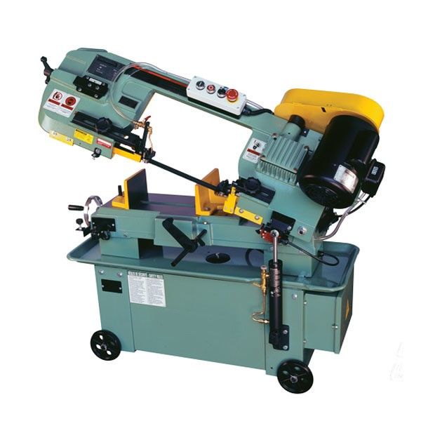

                              YouTube hacksaw videoThank You those with nice words re my little power hacksaw…Two reasons I made that machine, one being that it has been a project on the wish list for many years, and two, I have a bandsaw – see below, so there was always a reason to not get started on the hacksaw..
                              This is a pic from the front cover of the user handbook – my saw differs slightly – switch gear in a different place, etc.
                              This saw works very well, but although it delayed the start of the hacksaw, it also prompted it..I dislike changing blades on the bandsaw, and the saw never seems to have the correct blade in it! I often cut thin wall (2mm maybe) tubing and then there is a 10TPI blade in the machine for the last 100mm aluminium billet that was cut, etc.
                              I always find that the different TPI blades track differently, and so to get a square cut involves faffing about after changing a blade. The blade guides are very firmly set up ( I did machine the mating surfaces to get a better fit than the sloppy delivered article). The blade guide bearings are firm and snug against the blade, but when the blade opening is more than 180mm to 200mm, the blade flexes between the guides and tracks as it will.
                              My blades are 22mm wide and I guess about 0.7mm thick? not sure..
                              I allways cut wet ( with coolant) for material of a few square inches and more.
                              So, the hacksaw was pushed up the list. Now the hacksaw has a 24tpi blade in it all the time and is used for all the thin stuff – for which it is better suited anyway, as the thin stuff does not take so long in the hacksaw.
